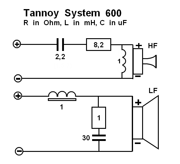

I need crossover schematic for Tannoy System 600 passive. Help!
Thank , I know it but it's not correct schematic. Tweeter crossover must have no coil ( 1st order filter) Te small coil must be in series with Woofer capasitor and resistor. I find several pictures and schematic of Tannoy System 600 but that is to much diferences between them...

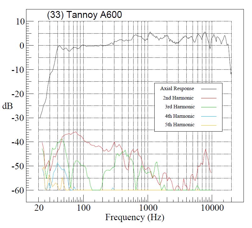

It seems has the same problem with the tweeter, reversed.
Tweeter and Woofer must be in Phase. The measurement shows the (electrolytic) capacitor in the LF part is degraded (these speakers are more than 20 years old).
Do you own a pair ? If yes I can provide more information on the crossover tomorrow. If refurbished they are excellent monitors which will meet their specifications and the frequency response should look more like the one attached. Why "Audio Science Review" measures a broken speaker and then writes nonsense like "seems to have been designed based on ideas and principals, as opposed to verification with measurements" is beyond me. Owning a Klippel system is one thing, knowing how to interpret the data is another.
