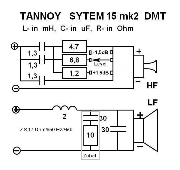

Tannoy System 15 mK1 crossover network

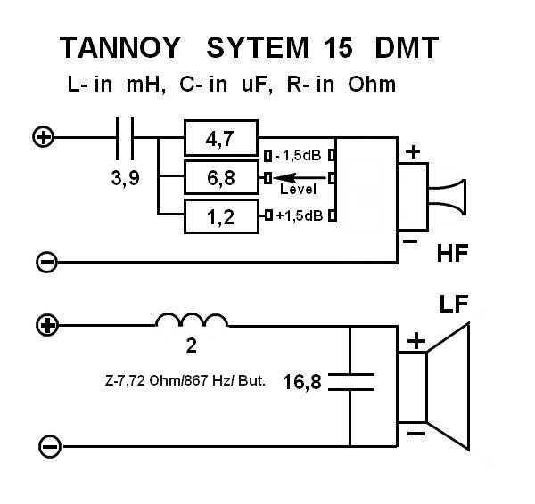

I have a pair of DMT15s which I thought were standard MK1 speakers,however on opening up the cabinets and having a look at the crossovers they are slightly different to the croosover diagram kindly submitted earlier. The treble crossover is as per the diagram, but the bass crossover has four poly type caps (yellow ICW I think), with values of 10microfarad for three of them but there is a fourth cap soldered in parallel to the other three, with a value of 6.8 microfarad making a total of 36.8 microfarads for the bass section. The crossover is all hard wired on a standard Tannoy DMT15 board version 1, I believe. Both of my DMT15 speakers have the same crossover configuration. Firstly can any tell me if Tannoy perhaps changed their design during the production run, and secondly what would the effect be on the crossover point of the additional 6.8 microfarad cap as I was considering unsoldering this cap returning the crossover as per the earlier submitted diagram.

........with values of 10microfarad for three of them but there is a fourth cap soldered in parallel to the other three, with a value of 6.8 microfarad making a total of 36.8 microfarads for the bass section. The crossover is all hard wired on a standard Tannoy DMT15 board version 1, I believe. Both of my DMT15 speakers have the same crossover configuration. Firstly can any tell me if Tannoy perhaps changed their design during the production run, and secondly what would the effect be on the crossover point of the additional 6.8 microfarad cap as I was considering unsoldering this cap returning the crossover as per the earlier submitted diagram.........
that's certainly original xover , and certainly one of iterations , non- documented in public , till now.
it's easy to try difference ......... with more uF in that position , bass driver is slightly more rolled of ( padded down) in turnover frequency area
