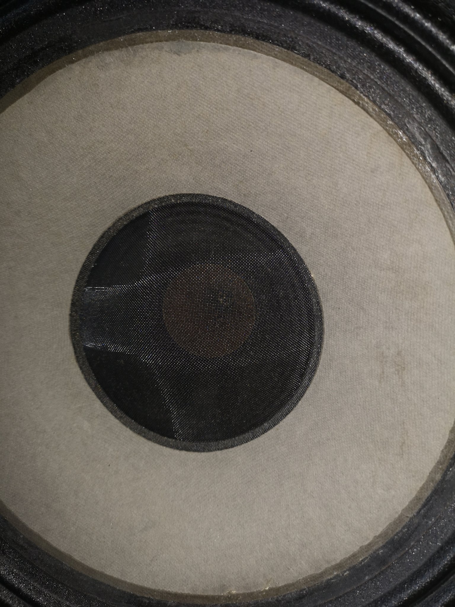

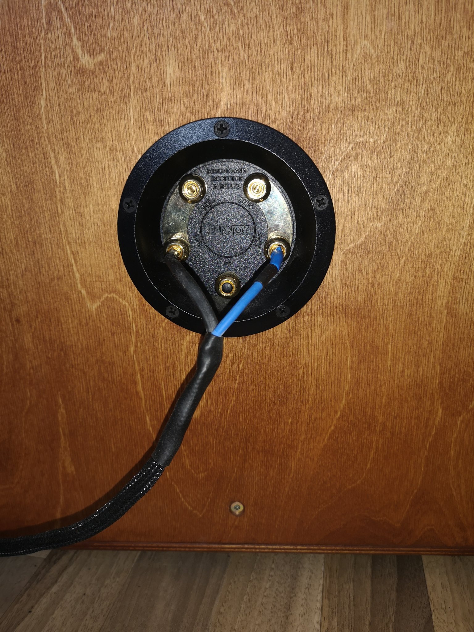

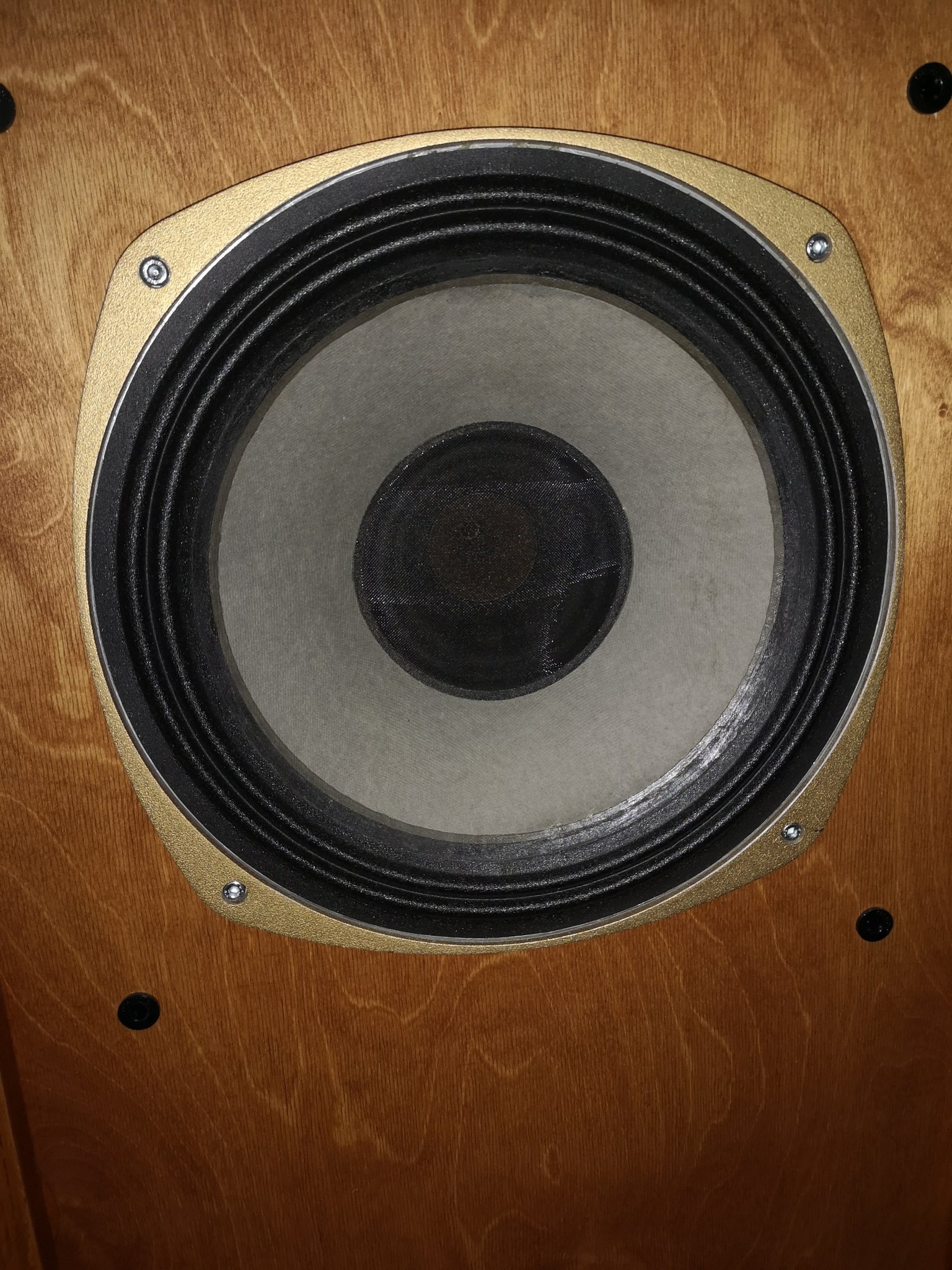

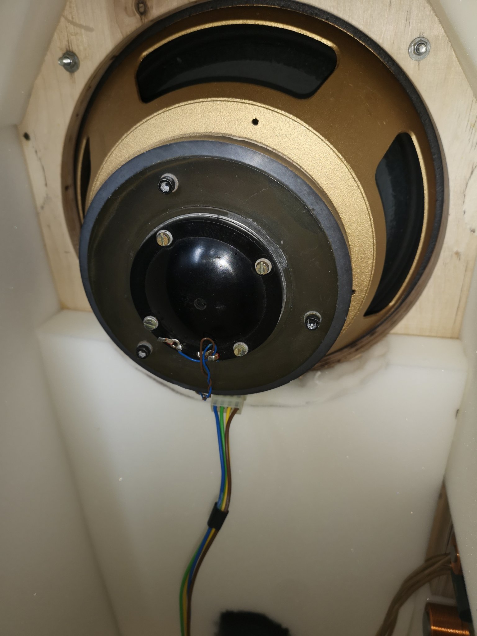

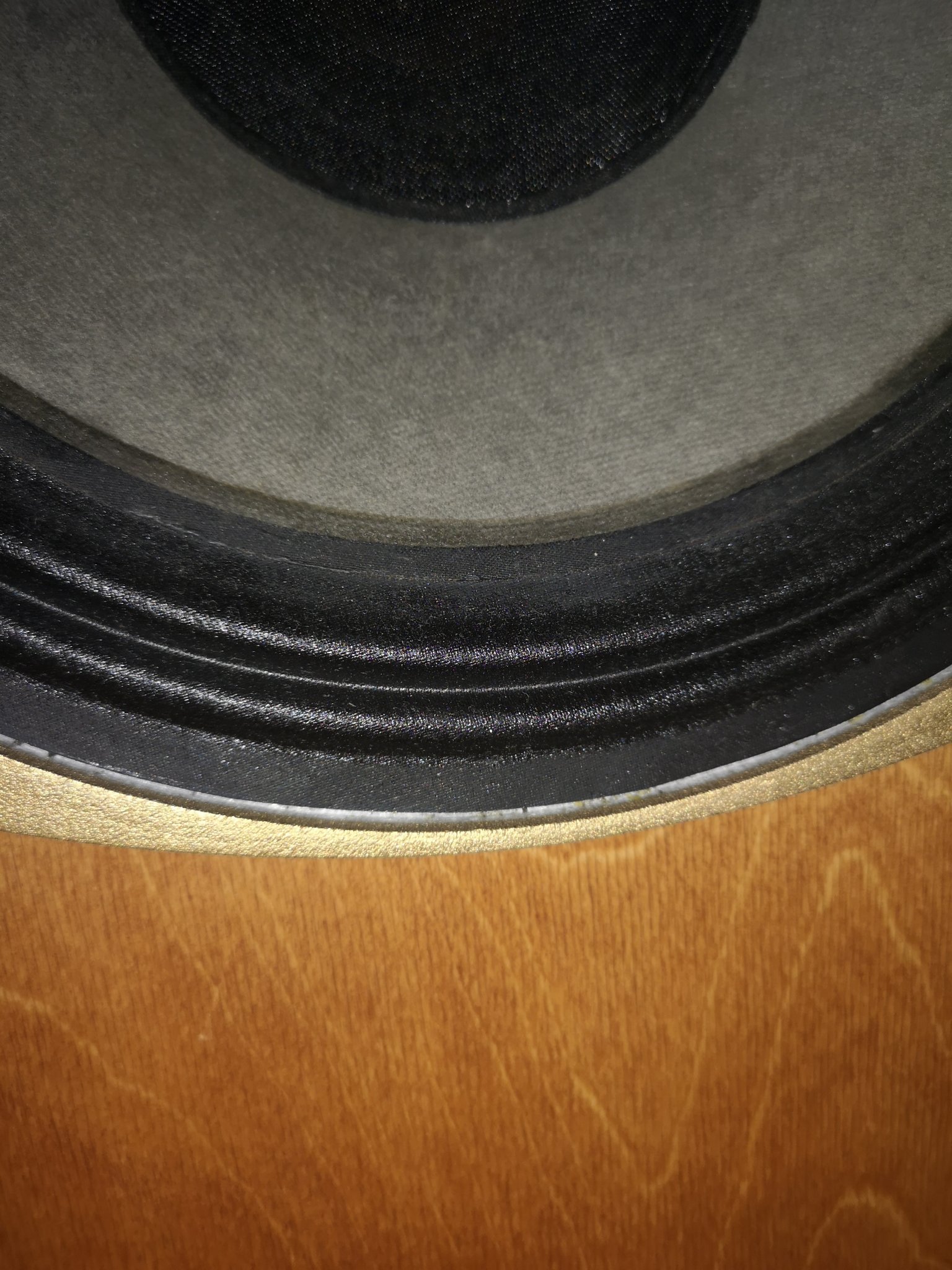

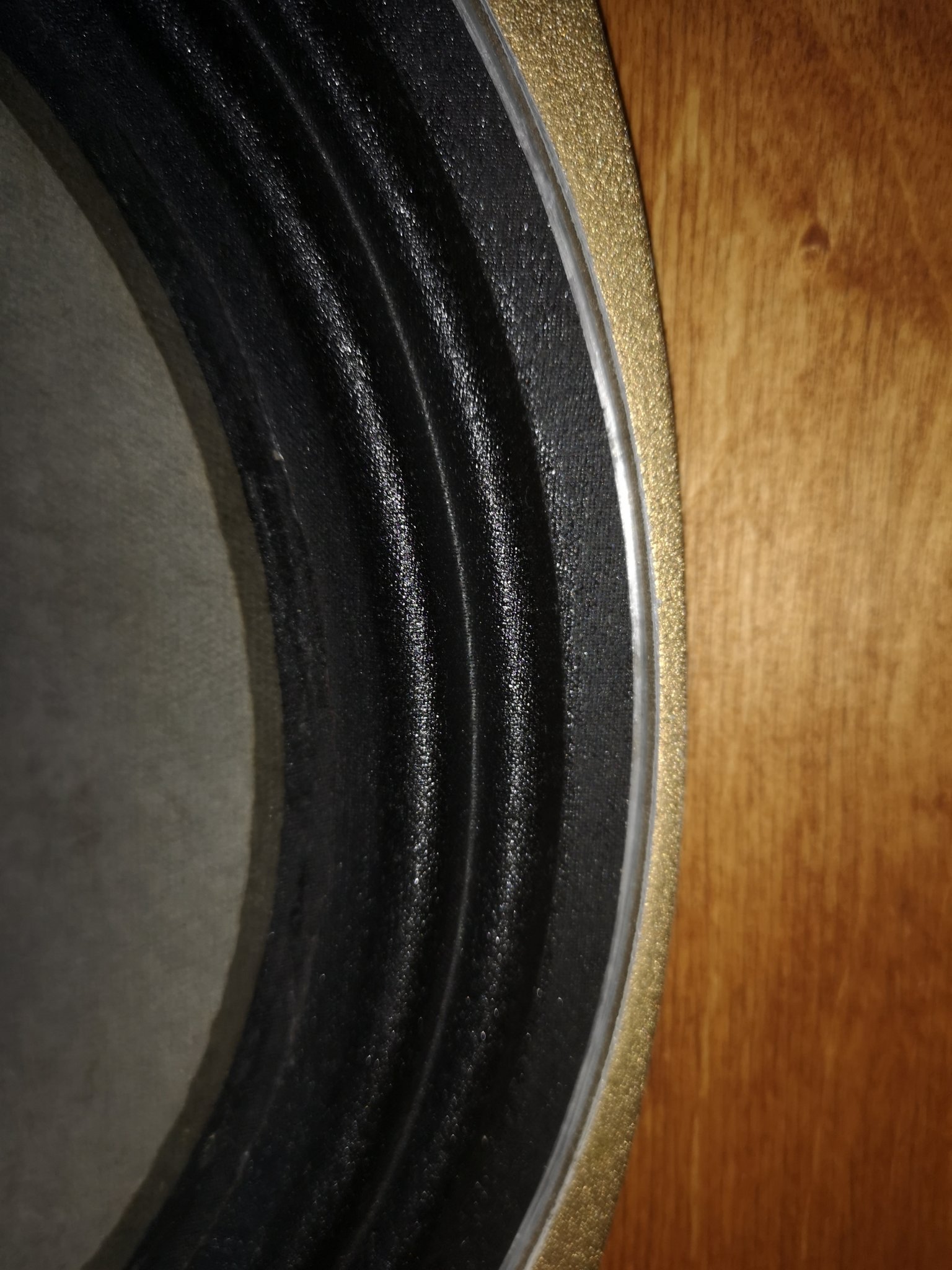

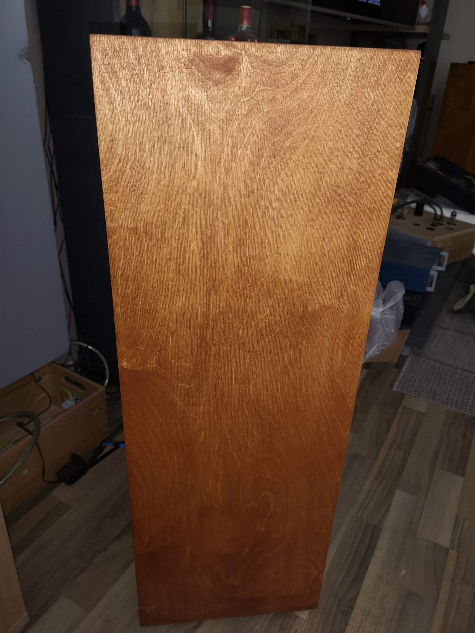

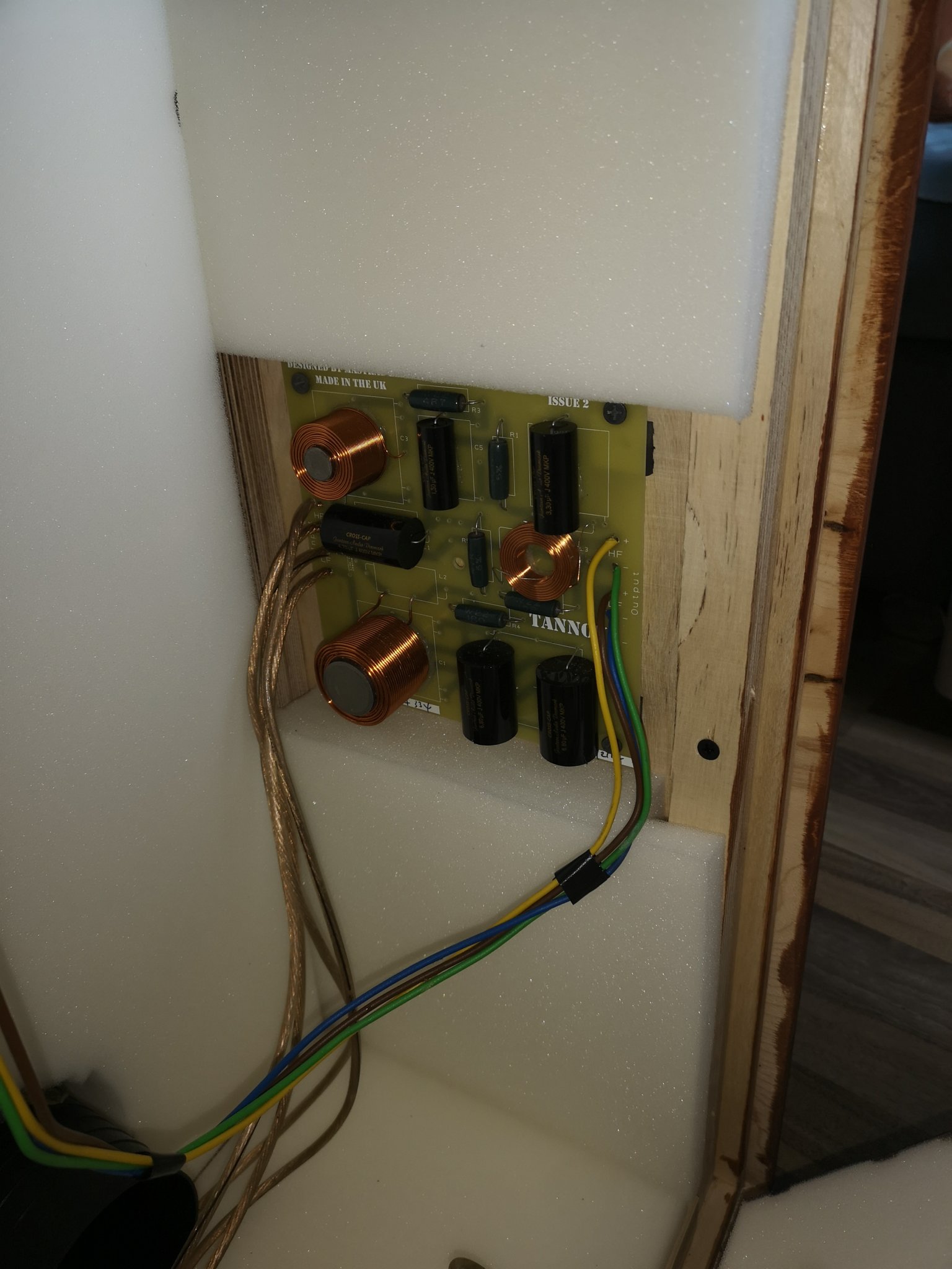

Totaly new build with 12 inch. Tannoy drivers from Srm12x enclosures the 3149g gold drivers. With new Mainley Tannoy crossovers with Jantzen coils and mkp crosscap capacitors. . The drivers have new surrounds from new prestige HE series, replaced by lockwood audio UK. Enclosure from Finnland birch multiplex, the best material for speaker building.The speaker building pist original tannoy!!! Verry nice work. Can be send inside EU in 2 packages. Payment thru paypal.Price 1250 eu or best offer plus shipping. Info over email.

Hi, I have also some many tannoys on my hands in last 30 years. From silver to red to gold to hpd(the worst tannoy drivers if you ask me) than 3828,3839 and so on. For this 3169g I have made no experiments, I just send to Manley the correct driver typ and they send me the crossovers and they sound great. Much better than original from 12x.

The plans are from original srm12 enclosures. You can find this on hilberlink site, there are many plans for diferent tannoy drivers.
Nop, without braces if mean that, I build this enclosures from birch multiplex so not much worry about vibrationes, for damping I have put standard foam on all sides and acoustic cotton foam behind the driver. 😉
thank you so much for these tips. my build is slowly coming together. how big did you make the speaker hole? i cut to the srm12x specifications and it is too small ! and i cannot find information online about what the mounting size is for the 3169g drivers
Hi, Iv used BR tunel with 8cm diameter and 15cm long. I have made some experiment with lenght in my room on speaker position, and the 15cm lenght was the best.
hiya, thank you for the reply. I meant to ask for the size of the hole you cut for the speaker driver- from the plan i have it said the diameter was 271mm but this is too small. so the big hole in which the speaker is placed.
thank you for your time!
Hi, I made tha cut out for the driver 280mm in diameter. You have still a little bit of player room on each side, maybe only 1 or 2 milimeter but is enough.
thank you so much. i’ve finished building the cabinet myself now! one problem i have is mounting the driver. did you use nut inserts in the wood? should they go all the way through the wood. i’ve seen different kinds of nut inserts (the ones i used originally seem too shallow to be safe). any further help is much appreciated. it’s sounding good though !!
Hi,yes this was the little red diy enclisure,but than I put the drivers if you have see in 160L also BR and thr sound was much,much better.The speakers have much more deep and precise bass section and also much better soundig by vocals and instruments becose it more bodie in vocals and instruments.And this bigger enclosure I just used standard wood screws.😉
