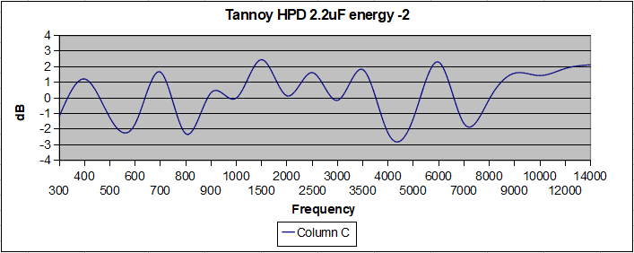

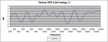

The graph shows the original xover. The regular ripples are a combination of internal cab reflections at the low end and diffraction at the lip of the horn. Both issues can be solved. On another horn, the JBL 2440 which had diffraction ripples I used P-foam draft excluder around the lip. This would be too thick for the HPD. 3M make an adhesive foam which is thin and durable. I tested it with a heat gun at high temp. This will probably work but my HPDs are a zillion miles away, so I can't try it. Other people have extended the lip. Need a 3D printer for this.

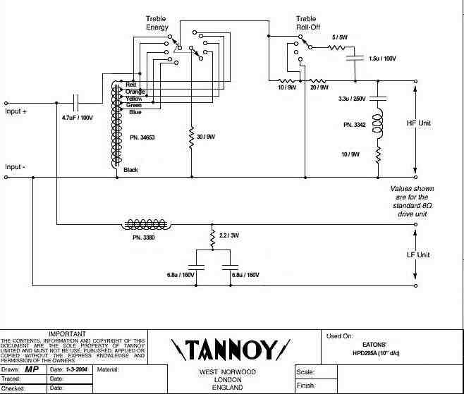

The attached sim has 2 versions of my HF xover section. Version 2 is the one I went with. I lost the bass section. You can see from the original xover graph that the mid is slightly elevated giving a mild shouty quality. This HF section might be useful for all drivers with the 2 inch diaphragm. I tried to keep the phase relatively flat. The original HPD295 xover is attached.

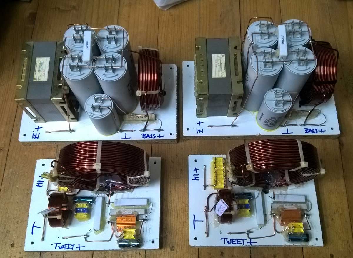

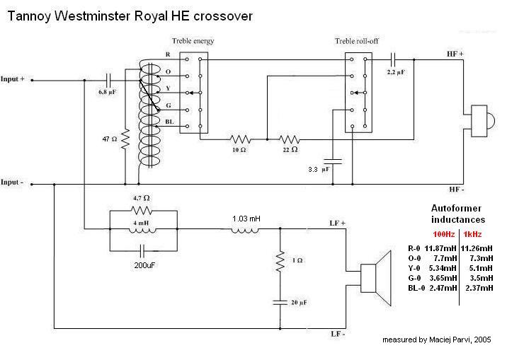

I did plenty of work in few recent years with Tanns , some of it published on my blog , some of it unpublished
when I manage to find some time , will try to prepare some documentation and info and publish , to share my findings
in short - pretty much every DC is having developed xover in time of Big Boys - Rackham and Co. ;
bad thing is that corner cutters were deciders , when boxes and physical implementation of xovers were made for market
passive xover form that time simply can't be made better , speaking of electrical scheme and values ; make it properly and that's it
and yes - autoformer for high pass section for 12" and 15" is a must , to bring things 1.25db up , so when cut and after Newman compensation , squawker is on level with bass
I personally prefer 1mH-ish choke in bass section , to my ears better that 3mH-ish , whatever anyone said and measured ;
sorry , have no energy for more now ; better to save it for later and write everything I can think of
as illustration , just few pics from my recent involvement in locally made pair of WM; my part was to make xovers and put drivers and them (and damping) in boxes
(WM just looks sorta small besides me , but that's just camera angle ; and yes , my posture is funny , right after entire afternoon kneeling and cutting damping sheets in situ

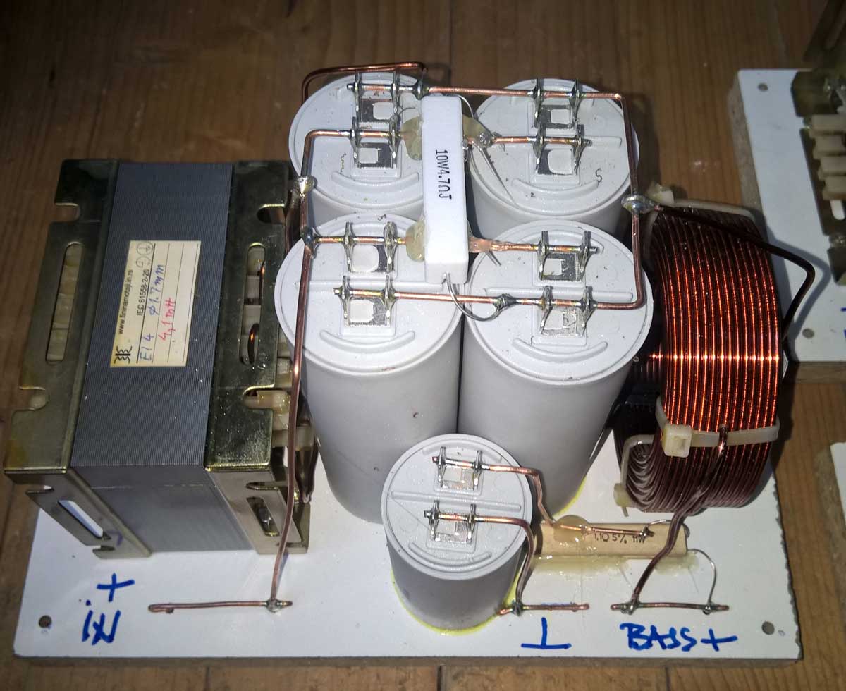

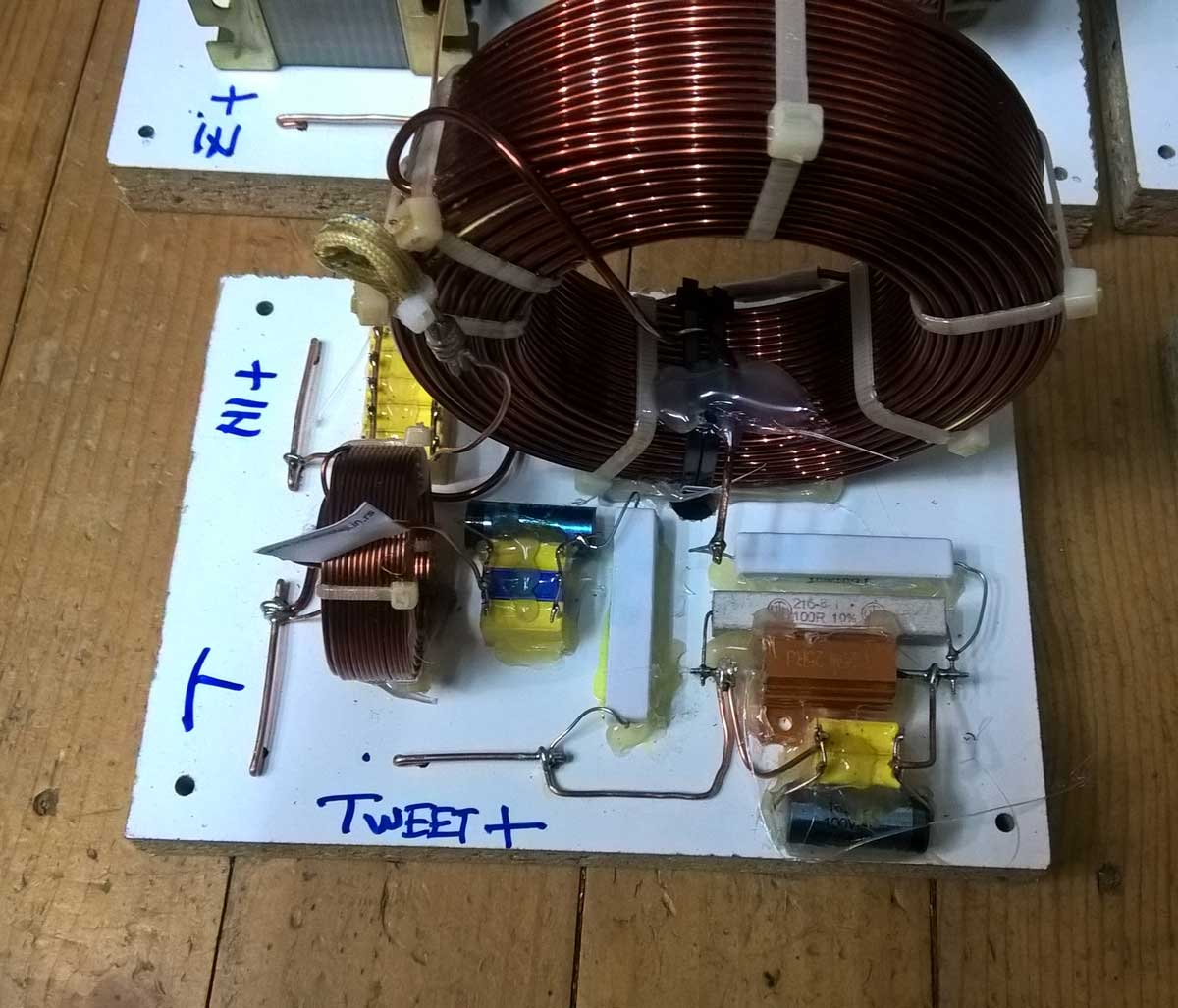

One quick question. What is that cube shaped thing on the board with your low pass sections? Is that an autoformer by any chance?
quick answer
cube is part od series LRC in WM bass section , everything else (except that LRC) being same as for any other Pepperpot 15" DC
autoformer for HF section is that biggest choke on other board , see writings on them
I'm making that autoformer as air core choke ...... so no core
