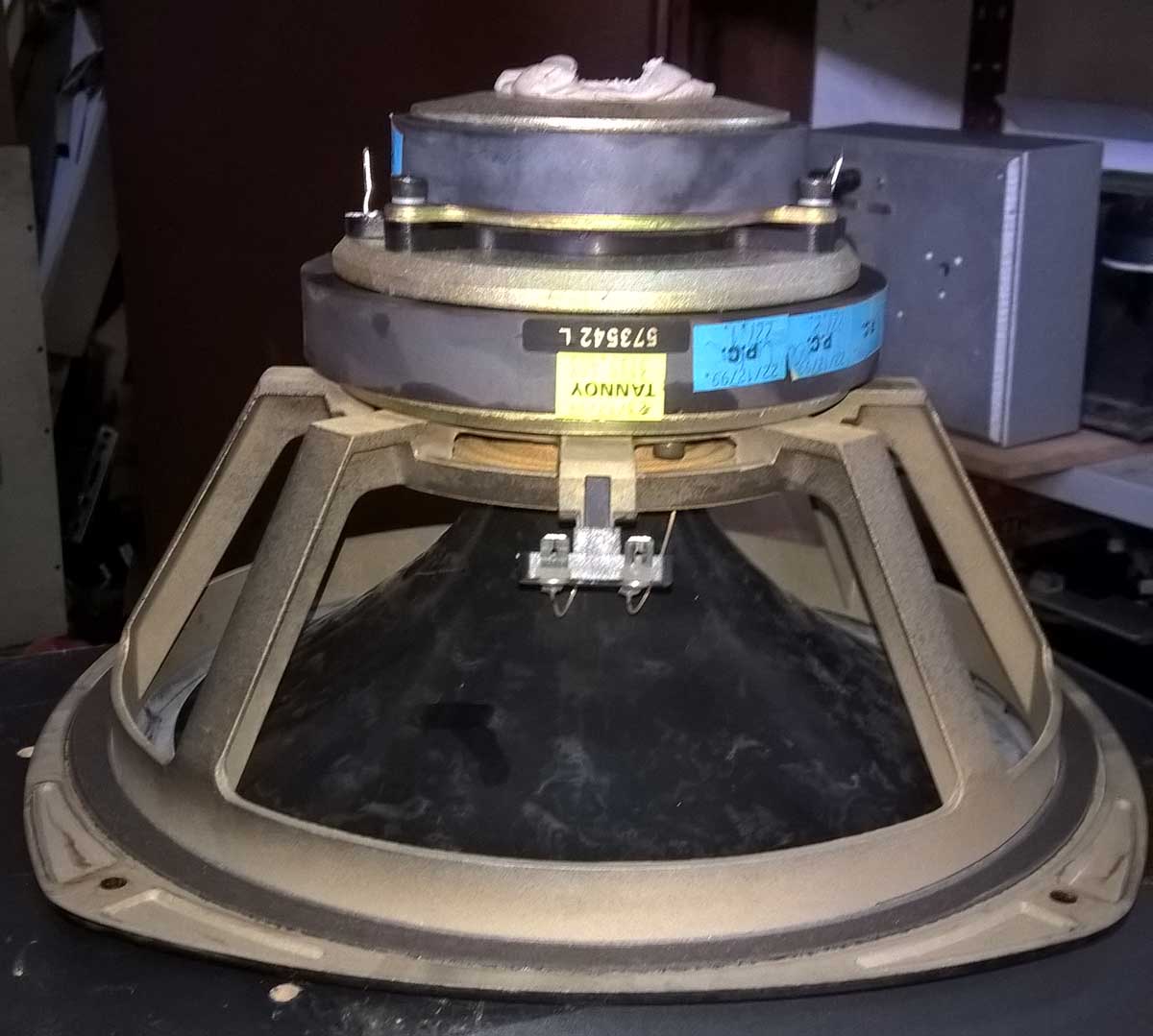

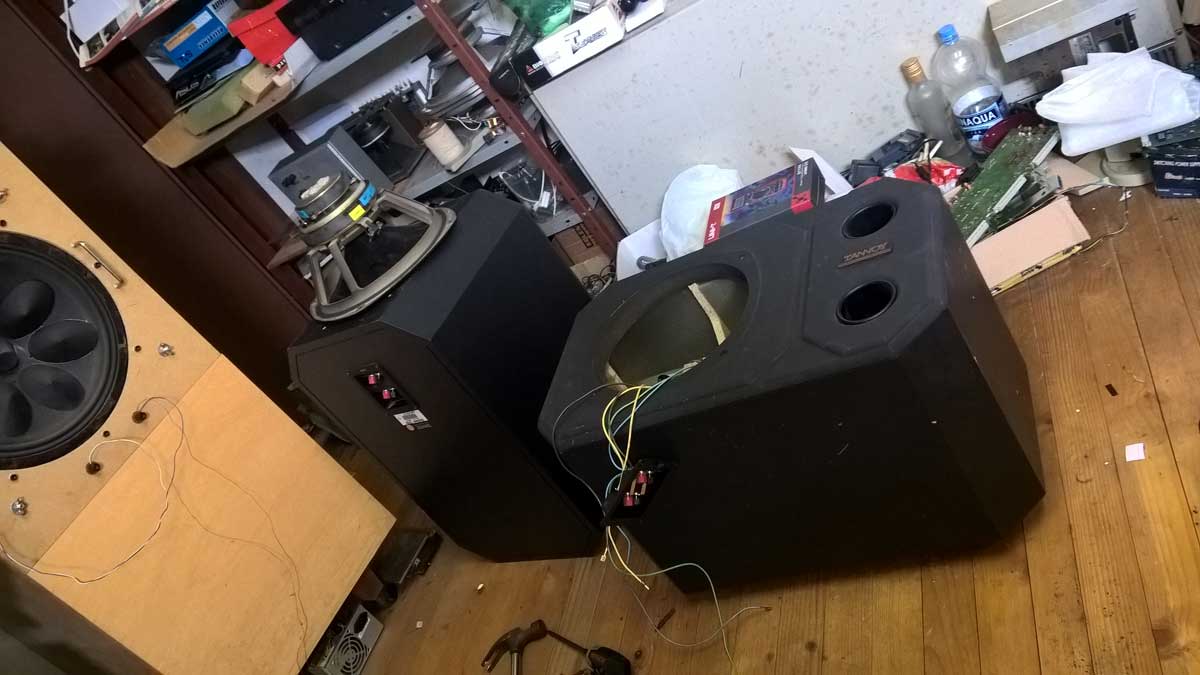

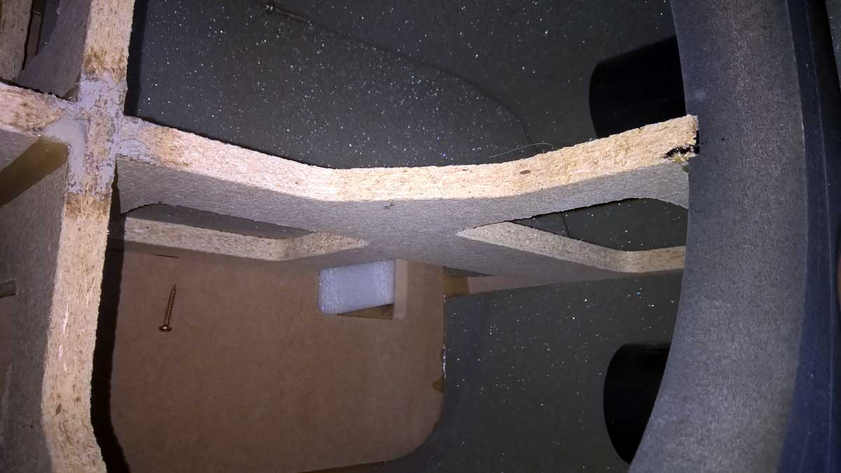

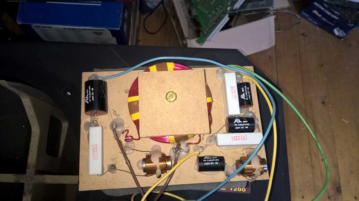

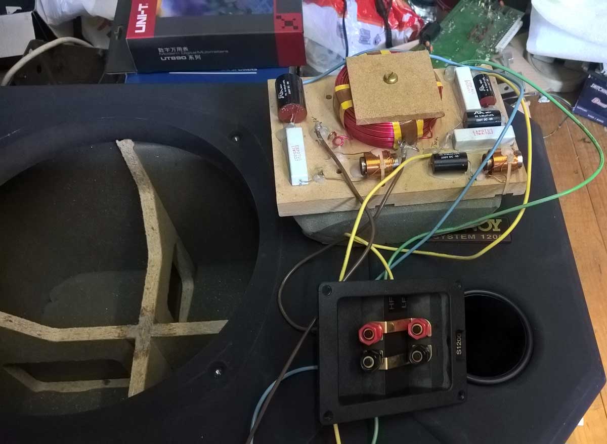

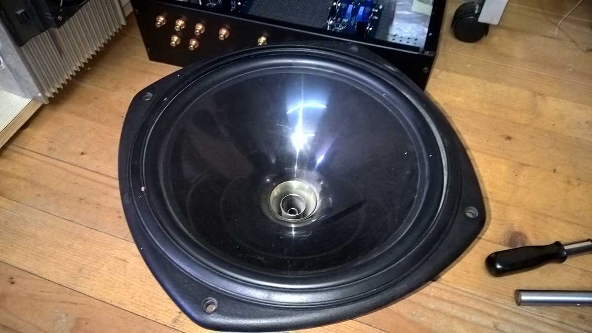

.... and both 12DMT and System 1200 are - good drivers in awful cabs with so-so xovers (better in DMT , wakoo in 1200)
same drivers in proper MLTL with clean DMT xover are happy campers , same as my ears

Tannoy is - unbelievably good sounding Dual Concentrics ( yes - even plastic cone ones , which was surprise to me , frankly) , put in numerous cabinets with all corners cut .......

while these I have in this very moment in my workshop .... banging my head how to save original cabs and make something useful from them ....... maybe putting them on full base sized pedestal and incorporating the same in proper MLTL (as standalone speaker boxes as result) ....... and changing xover to something closer to DMT12

these both are made by me , I mean - construction , with MJK Quarterwave software , while production of cabs is made by local carpenter , specialized in making speaker cabs
How do they sound? And the ones in the background: HPDs?
they sound as Tannoy can sound in proper boxes - gorgeous
as poor man's RCA LC1
these in front are 3134 (paper cone 12", tulip) , bigger ones are HPD , my guy is also having Golds , can't remember which ones are mounted in, right now
some info you can find in my blog
