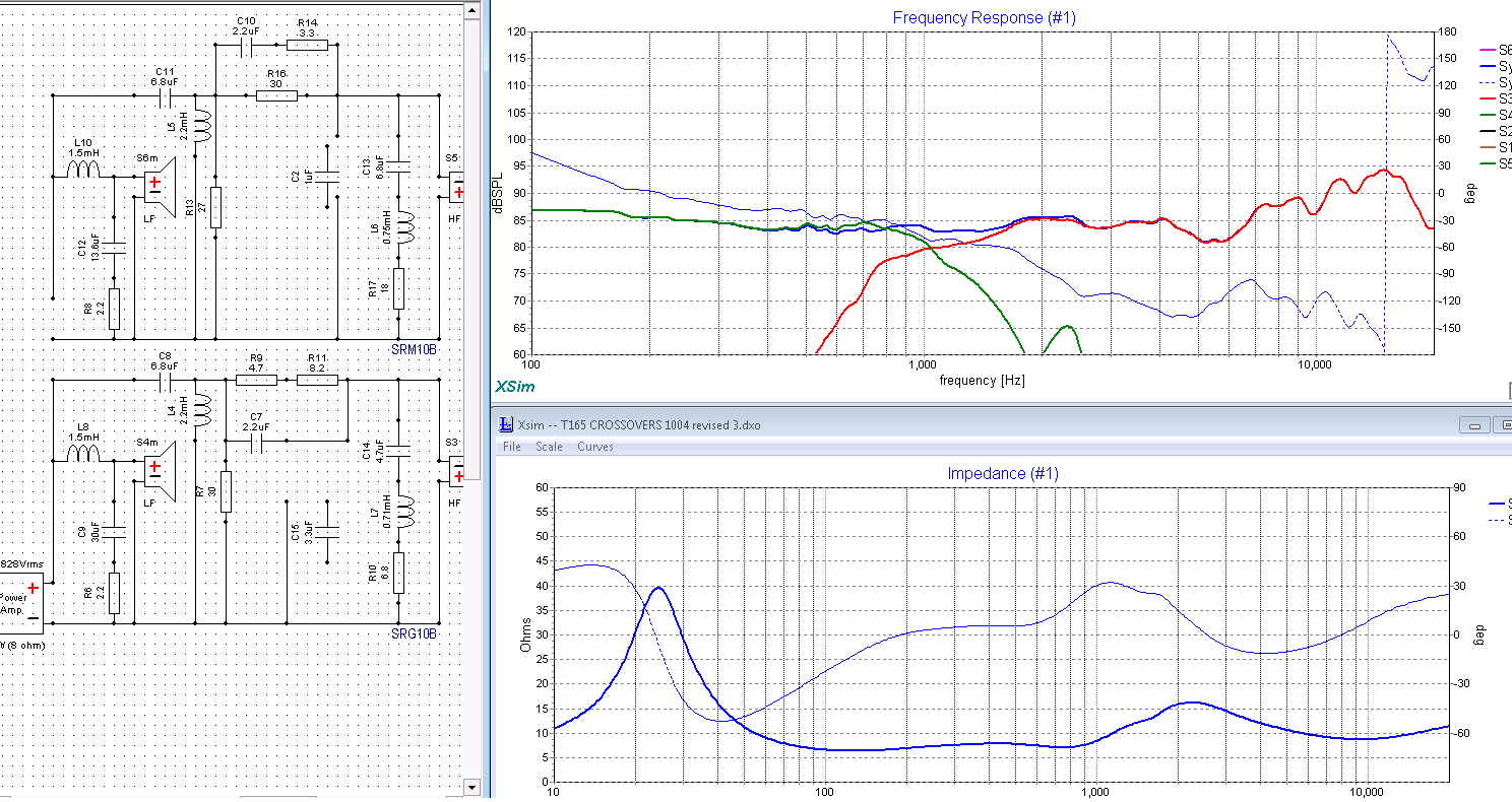

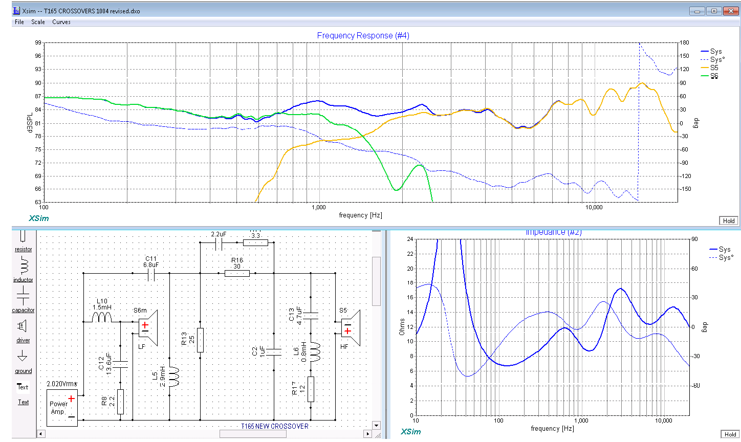

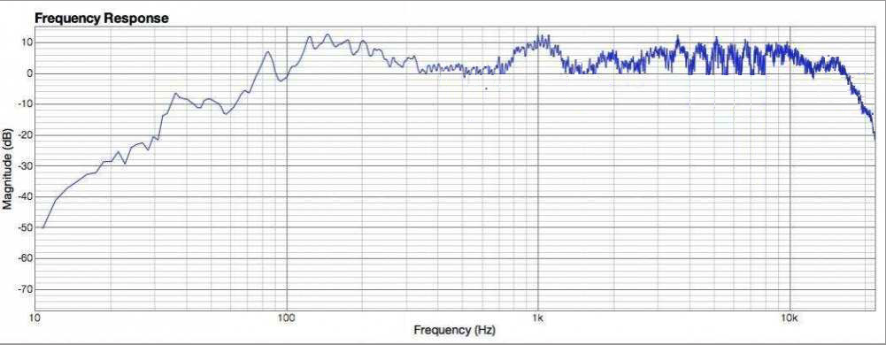

Great thank you waxx and all of you guys for all your help.
The original srm10b crossover that you can see at the bottom dont look to bad either! I will probably start from there and than fine tune. My plan is to build some proto version mounted outside of the speakers for easy tweaking/testing.
This is the original crossover at position 0 - presence -Tannoy Dorset
attachment.php
This was measured at about 2.5 meters from the speakers - out of hand - Dayton Audio iMM-6 Calibrated Microphone - SPL at 0 is 93.00 db...
I don't have better measuring equipment at the moment - but this is roughly what it is ...

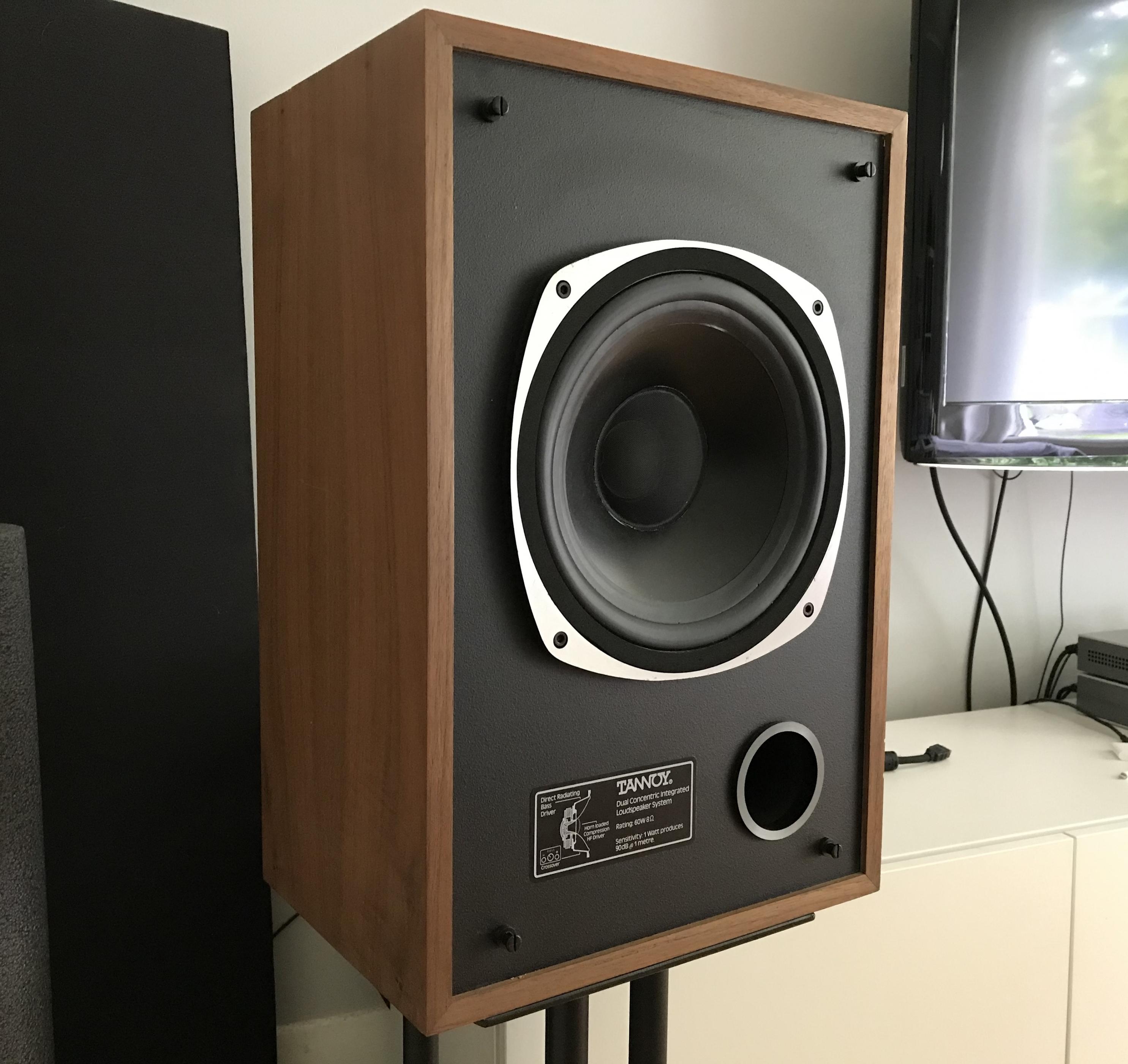

Hi Ylab,
I came across this thread describing your Tannoy project after I searched for the schematic of the Tannoy Dover (which I've just bought). Did you complete your crossover renewal project and if so, how did it work out?
I have a pair of Tannoy Dorset which use the polyolefin (black plastic) cone, and I've never really been pleased with them, so when I saw a battered pair of Dovers but with perfect 2558 drivers for sale, I jumped at them. I've been researching the crossovers of each, and it seems Tannoy went to a lot more trouble and cost on the T165/185 crossover. As a first experiment I've just swapped out the drivers, and there is some improvement, but I'm aware the crossover frequency is wrong. Next step is to swap out the crossovers too to match the driver with the crossover. To my mind the Dover cabinet is too small for the 2558 to give its best bass.
