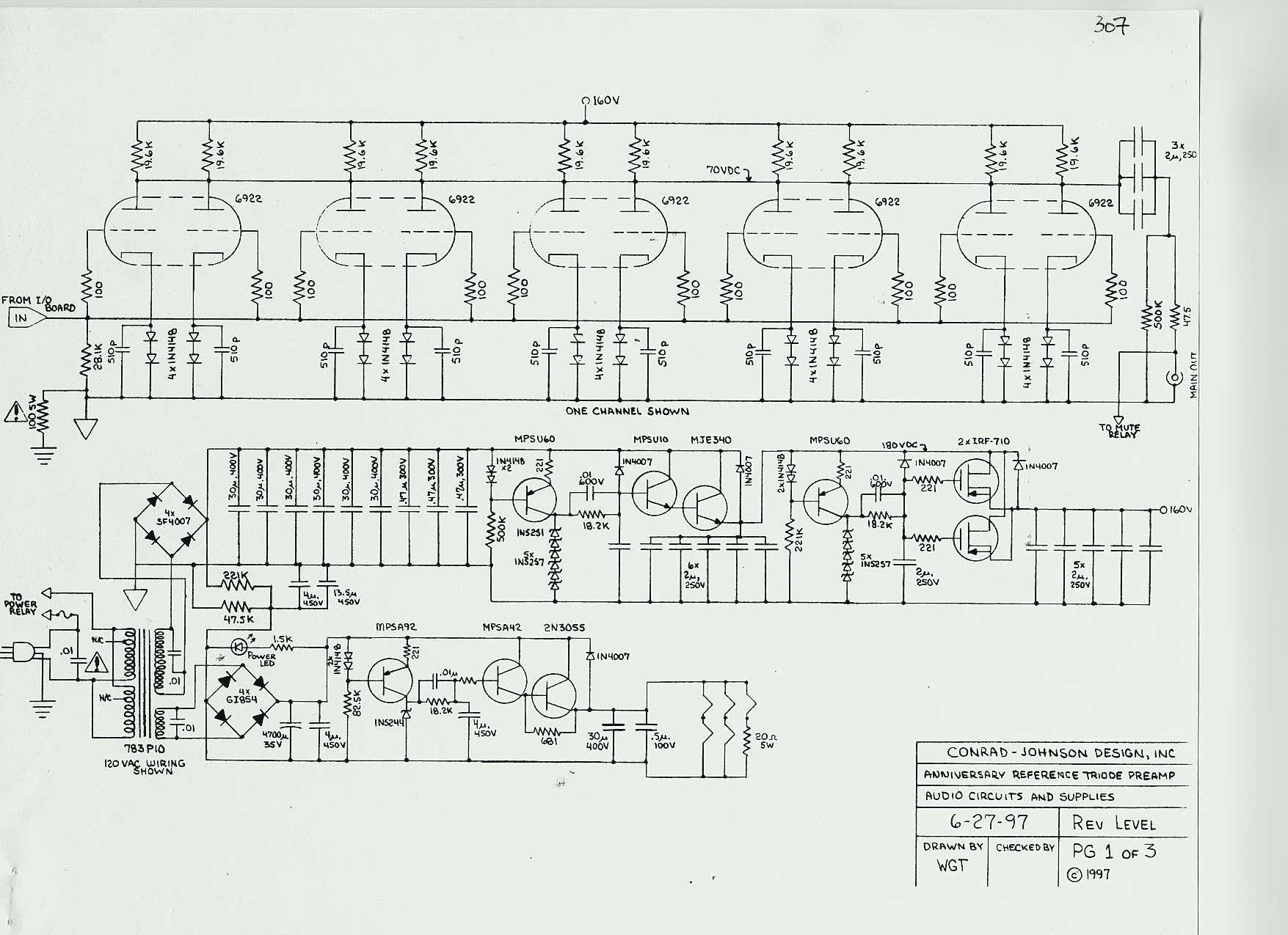

explanation was - as I connected these triode systems, there is no single link in chain where I have any resistive loss ( yeah, being anal about that) and as tube as whole is practically biased/fed with CCS in cathode, even tiniest difference in transfer characteristic between two triode systems is resulting in see-saw effect
You'll never have same see-saw effect in stages where parallel tube systems are biased in "usual" way - through voltage sag across cathode resistor or whatever, be it degenerated or not .....
crucial difference here is stage both biased and loaded through CCS situated in cathode(s), presenting very big dynamic impedance of load
you can represent it as ....... say weightlifting bar with sliiiiightly different weights on two ends
if you place it on block of rubber and there is mild earthquake, it'll act in some funny way
now, if you place it on top of very springy spring, and there is same mild earthquake, it'll act in muchmuch funnier way
and, just for the record, toobz with greater xconductance are much trickier bars than toobz with eenyweeny xconductance
anyone remembering CJ ART preamp?
just for giggles
just for giggles
