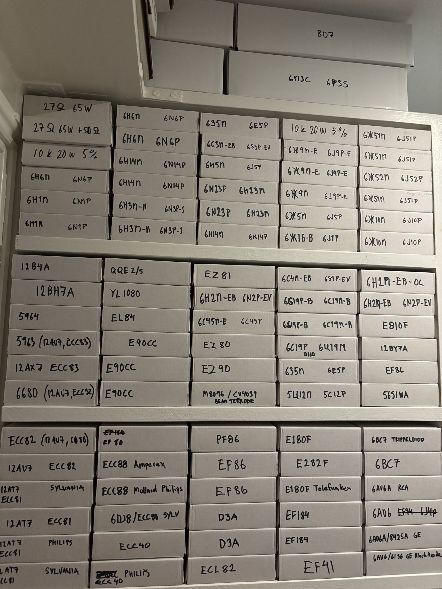

Bit of my
stash
Bit of my
Nice stash

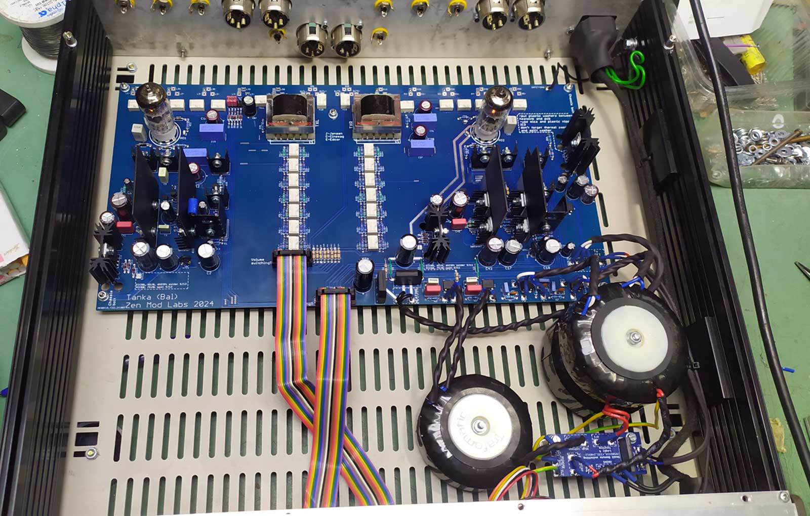

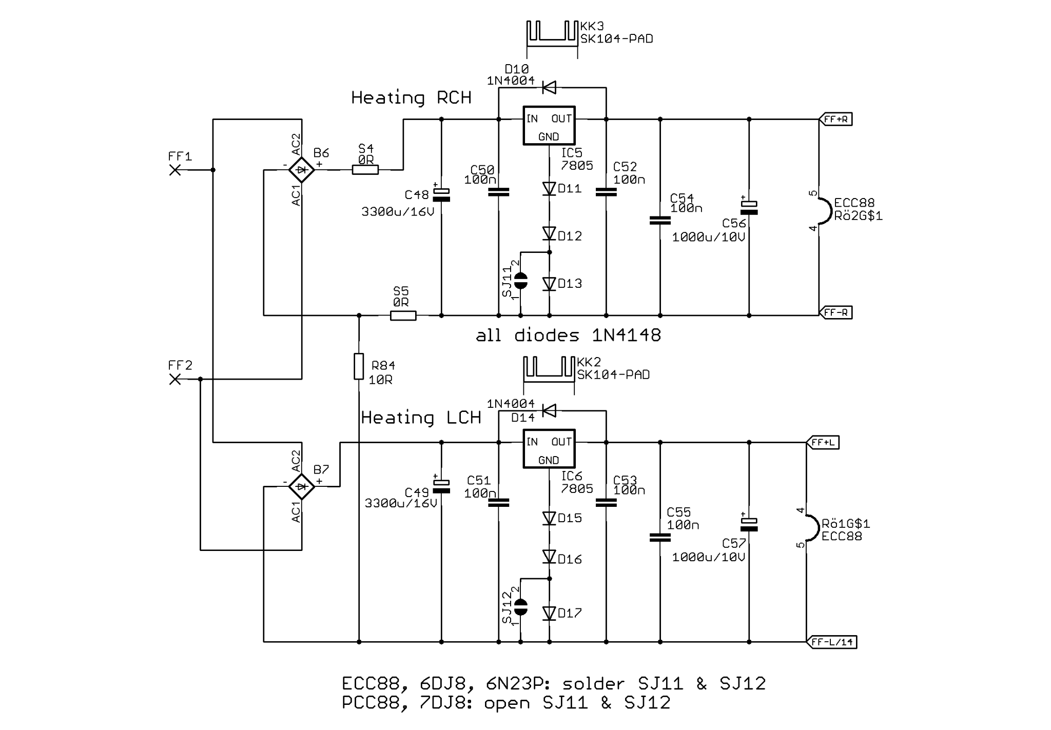

I love to see the Tanka measurements. 😛 Heaters are elevated to what voltage with this 1M resistor divider? What is the autoformes main funktion when using tubes? Gain or more sugar?
Hardly of any relevance, at least for me - I know that I'm not curious what's behind second decimal
If you've seen measurement of Iron Pre, this is even lower
50% of HV rail, so 45Vdc
same as in Iron Pre - gain.
xformer, be it connected as auto or not, is always adding 3rd; so, no - xformer is not adding sugar
especially in balanced config, where you naturally have nulling of all even harmonics
Hello zm,under 10R buffer cell itself, then multiplied with autoformer ratio
as impedance ratio is (V/V)^2 ........
SE @6db ends under 40R, @12db under 160R
Bal, solely 6db, under 40R per phase
