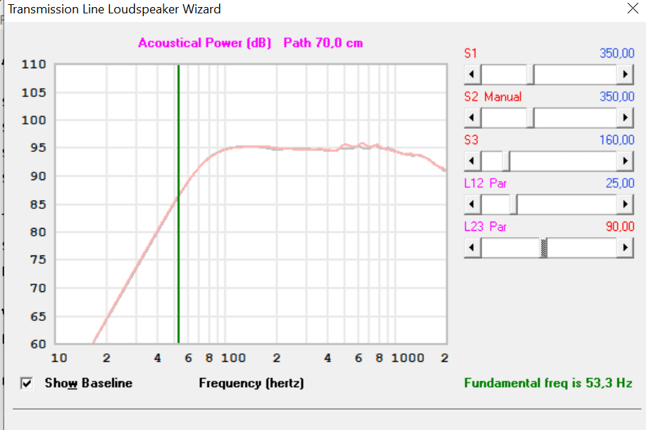

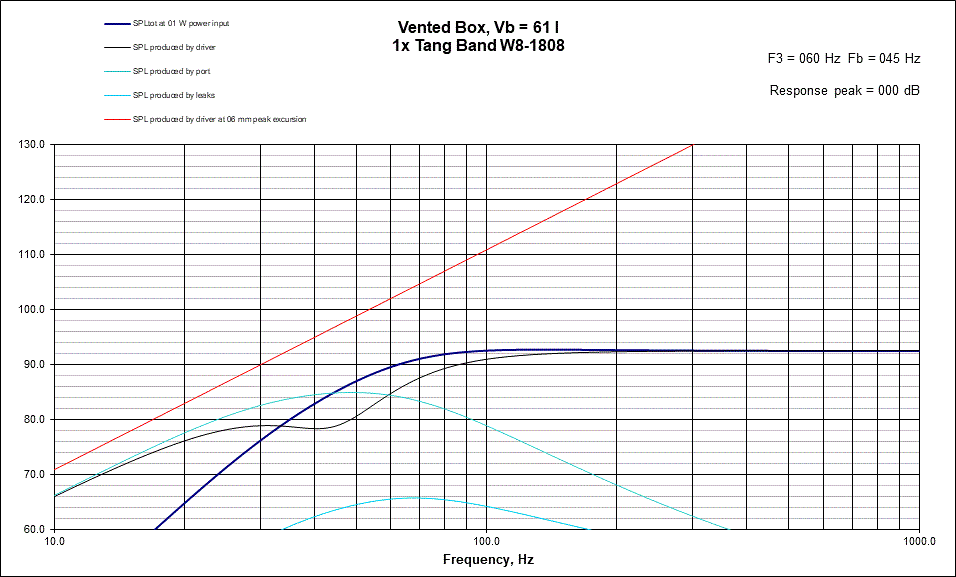

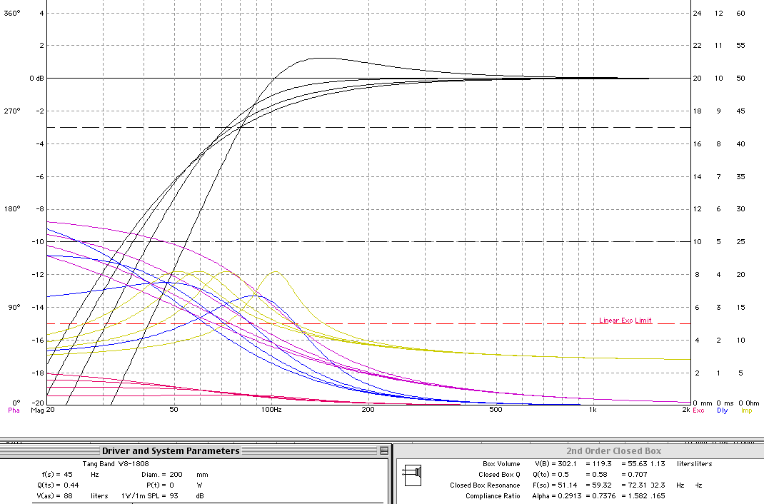

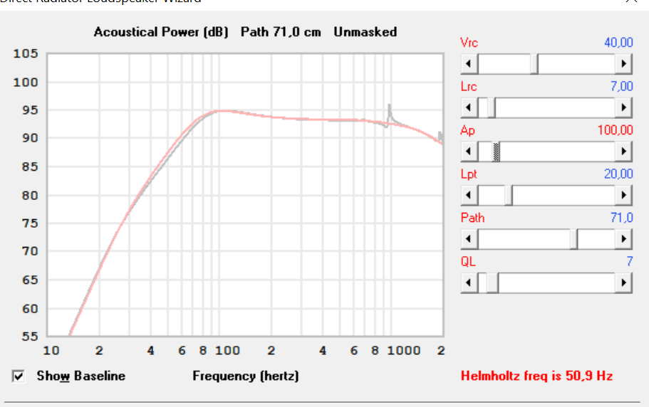

Tangband W8-1808 in sealed box
40 liter, port 1/2 Sd, 20 cm long it is not so bad for room with room mode 42, 84 Hz

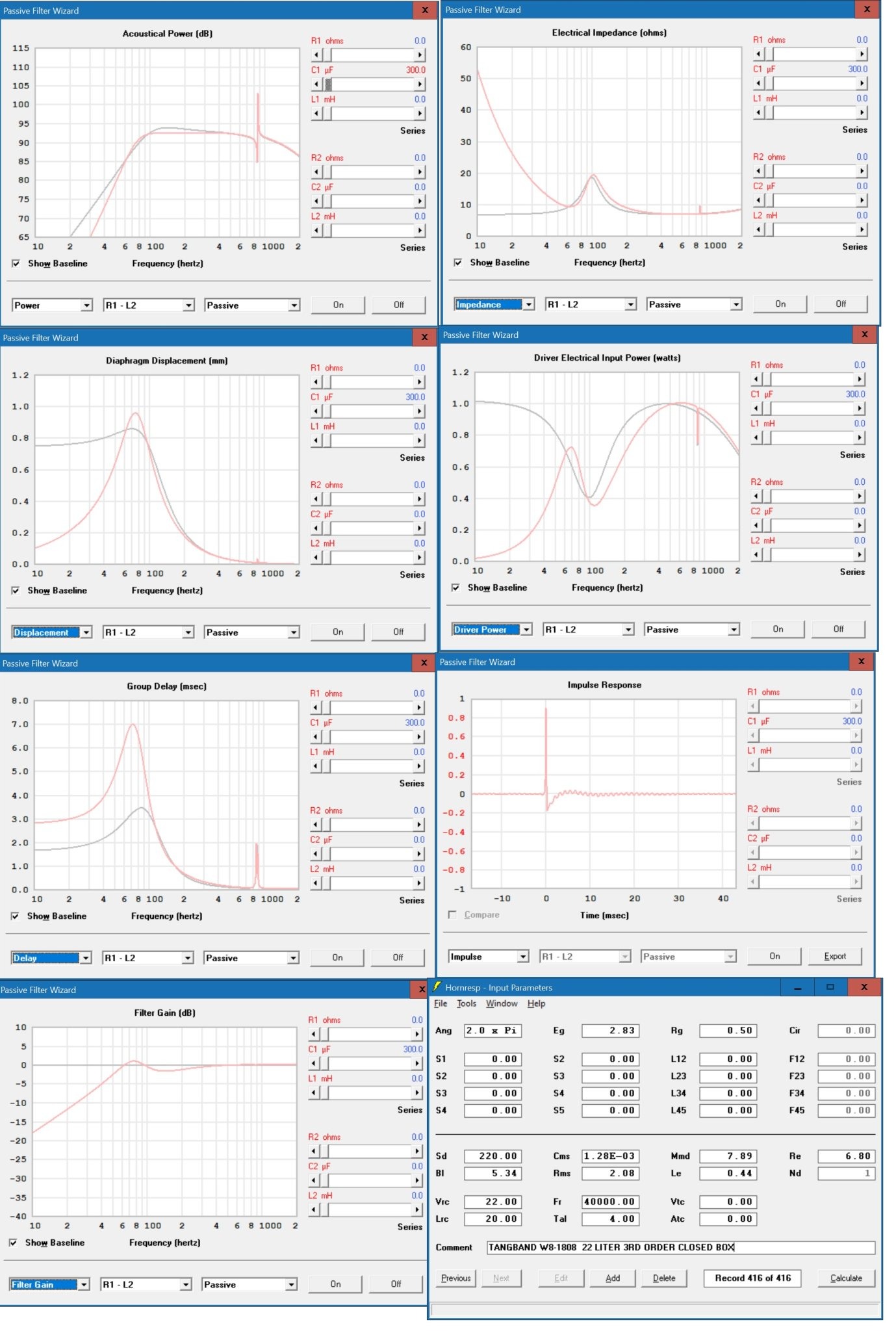

A 22 liter sealed box and 300uF series cap could work depending on the output Z of the amplifier.

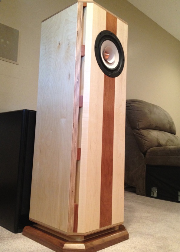

I had 1772 in a taller Karlson type - maybe 4-5 inches too
tall - so one with cabinet making skills could do better
