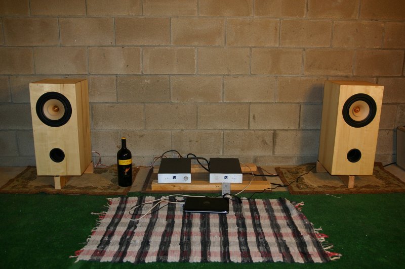

>>> There is no BSC at the moment. I'm taking a purist approach by running them post to post. They are BRIGHT. I mitigate that brightness by keeping them close to the wall and listening off axis. I'll wait until I have my 300B or 2A3 SET amp in hand before I design a BSC.
I think they look great! I agree with your decision to run them the way you are before tinkering with them. If you can spread them wide enough apart you may not need any circuit at all! 300B or 2A3 SET, spaced wide plus room conditions (curtains, rugs, etc.) may be a synergistic match... Personally, i don't think the 1808 is bright at all so it may sound different than the 1772 you have.

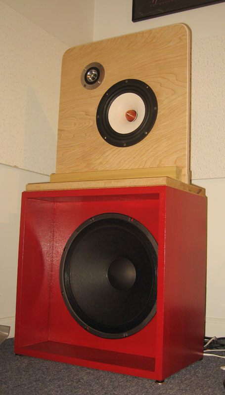

I use a EL34 based Cary amp that's rated at 30 watts. I love the amp... and just about anything Cary makes. You can see my latest experiment next to the 1808... totally different sound. The TB is full range for sure! I don't think it needs a tweeter at all but use one crossed very high. It needs bass extension when it's on open baffle like it is but i've heard it in small sealed cabinets and thought it went deeper in the bass than expected. I think a 2 - 3 cubic foot box would be ideal and this driver can be setup all by itself as a true full range driver... i'd imagine the 1772 could be used successfully this way too. The 1772 is rated to go slightly deeper in the bass. If you can't tame the brightness you can always play with a small circuit. It's still a full range driver with all the benefits implied.

is that a celestion horn on the top?
@JimOfOakCreek: in that room, with bare breezeblocks and concrete, i should imagine that almost anything would sound bright, or at least 'hard'. some drapes or carpet behind the boxes will help alot, and not cost alot either. i doubt either the drivers or amp are at fault here.

@Godzilla:is that a celestion horn on top of the larger fullrange box? it looks very similar to the horns i have. can i ask, what do you think of those horns?
