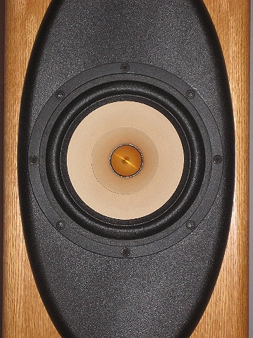

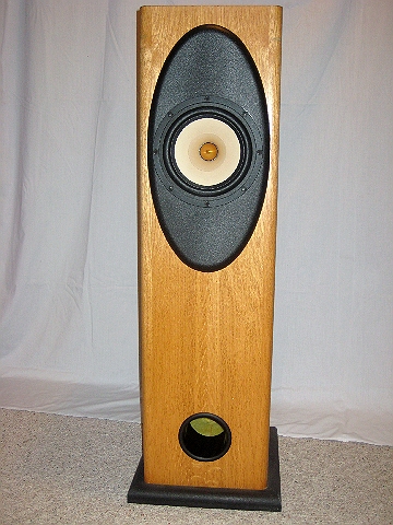

Here are pictures of my TT-2000 in oak veneer:
Bob
Bob
