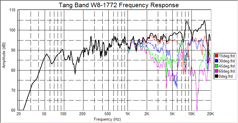

Tang Band W8-1772 Impressions.
Why would he be kidding you? Presumably he knows the behaviour of his own subwoofers.
Back OT, I wouldn't care to run any kind of back-loaded box higher than ~300Hz; the group delay would drive me mad. FWIW though, much of that top-end peaking is there to provide better HF response off-axis, so if you angle them suitably, so you're not directly on-axis with the whizzer cones, the levels will start to balance out.

Yesterday night I played a bit with high and low shelf of my equalizer plugin. I ended up with +4db at 400hz low shelf and -3db at 1khz high shelf using low Q values. Now my speakers sound much better.

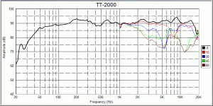

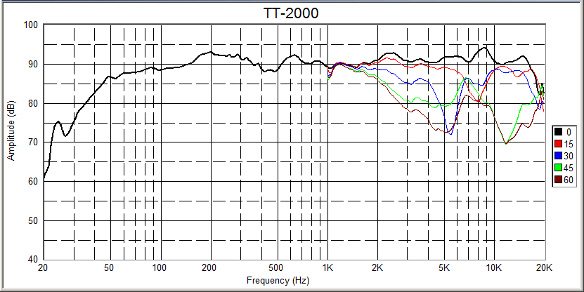

Here are some RTA's I did. This is the unfiltered and filtered 1/2m response as I sell the speaker. In retrospect, I probably have the BSC filter set too low, but the parallel RC filter is working perfectly. Note that if you are 15* or so off axis, the rising response takes care of itself. This is typical of wide-range drivers.
As to the Q of the filters, I don't really know. I use the miniDSP and adjust things on the fly. I set the high and low shelves in the initial filter section and then take care of any other humps and bumps int XO filter section.
Bob
Bob
That's a nice looking freq response curve. Nicely done.

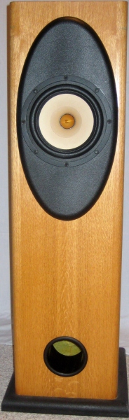

That's a beautiful speaker Bob! I've been told that you did a small MLTL for the Fostex FE166En. Do you still have plans/pictures? Is there a build thread for that on the forum?
Sadly, the FExx6En drivers proved utterly unsuitable for resonant cabinets. As soon as the FFxx5WK drivers became available, I abandoned the FE's. I lost my pair of FE166En's to a coating experiment, but for me, not great loss.
