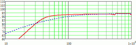

OK, I looked into the 1772 and 1808 in BR's. First, I ran the T/S specs through Unibox to get a starting point and then fine tuned the results with the MJK worksheets.
The 1808 needs a QB3 box of 120L. I reduced this to 80L and then tuned it low. This gives an interesting FR plot, and the project is doable. But....
The 1772 needs a QB3 box of 49L. Reducing that to 40L and tuning it low give the type of EBS plot I like.
W8-1808 in 80 liter BR............W8-1772 in 40 liter BR
