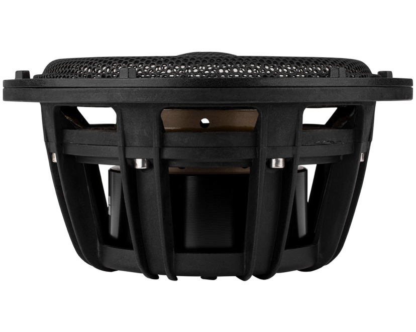

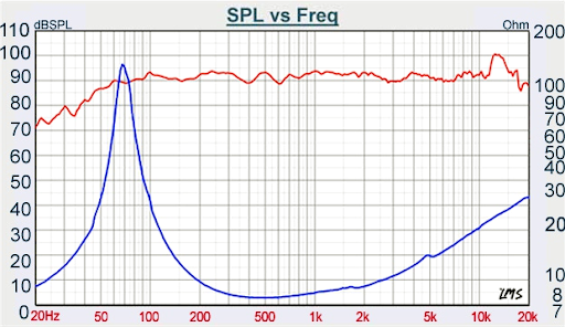

What do we know about the W6-1914SB? I ran across this 6in honeycomb diaphragm neodymium motor midrange today. I looked at the response curve and it seems wide and flat and with decent sensitivity. I think it won’t make much bass but could be a good top for a FAST/WAW.

Code:
Resonant Frequency (Fs)70 Hz
DC Resistance (Re)6.5 ohms
Voice Coil Inductance (Le)0.073 mH
Mechanical Q (Qms)7.19
Electromagnetic Q (Qes)0.37
Total Q (Qts)0.35
Compliance Equivalent Volume (Vas)0.39 ft.³
Mechanical Compliance of Suspension (Cms)0.399 mm/N
BL Product (BL)10.23 Tm
Diaphragm Mass Inc. Airload (Mms)13.97g
Maximum Linear Excursion (Xmax)0.5 mm
Surface Area of Cone (Sd)140 cm²

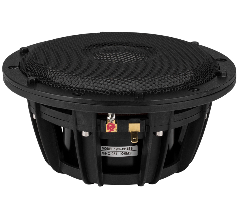

$139 is not all that high for something with a wide and flat bandwidth like this. Cast aluminum frame, neodymium magnets, high tech composite honeycomb diaphragm, etc., make for a more expensive than usual full range.
Tang Band W6-1914SB 6" Sandwich Cone Midrange Driver
A 1.5L sealed rear chamber allows F3 of 180Hz. Perfect range for a FAST.

Nice looking driver with a good frame and matching cover. Response looks well behaved, some bumps out of my hearing range. I’d probably buy one if available in my region. It would be difficult to overlook the value and performance of the W5-2143 though in comparison.
