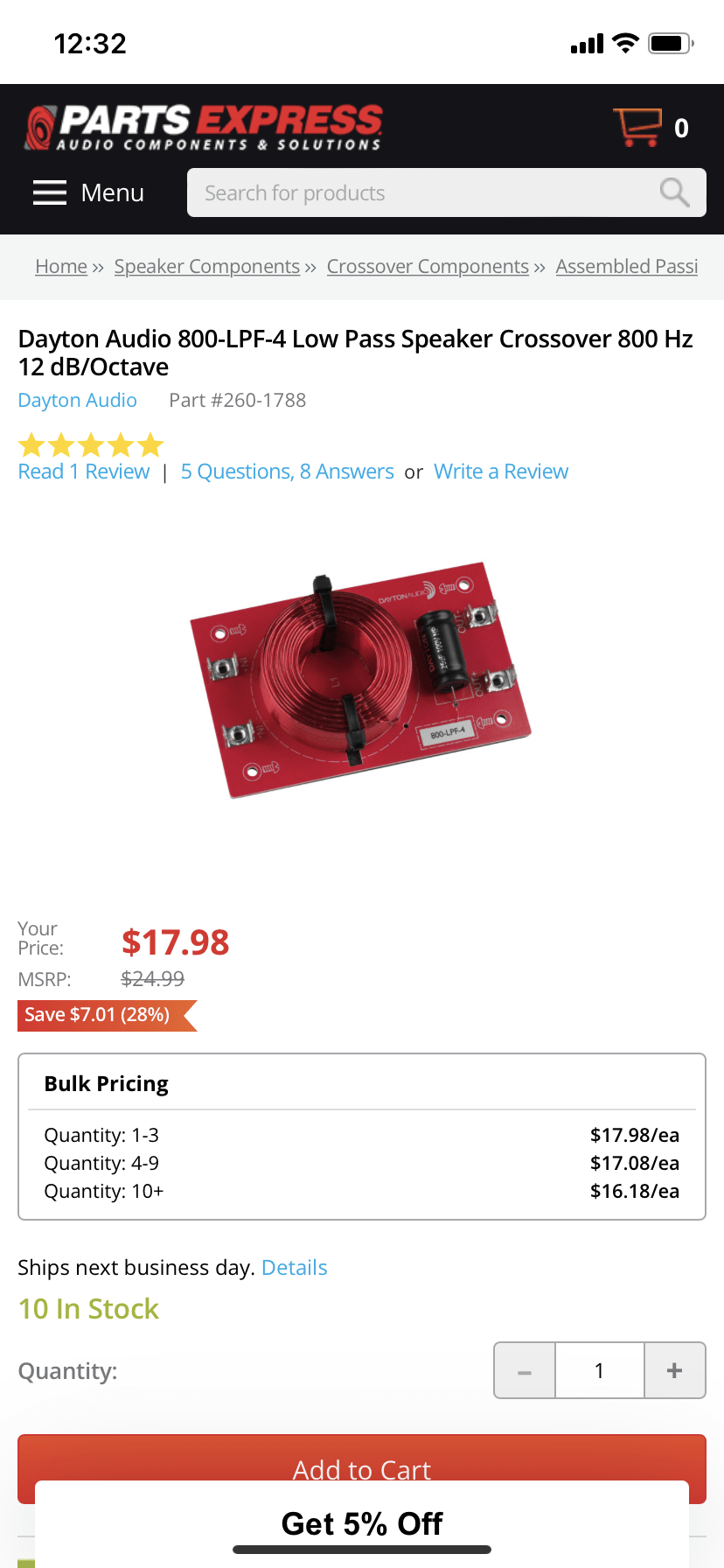

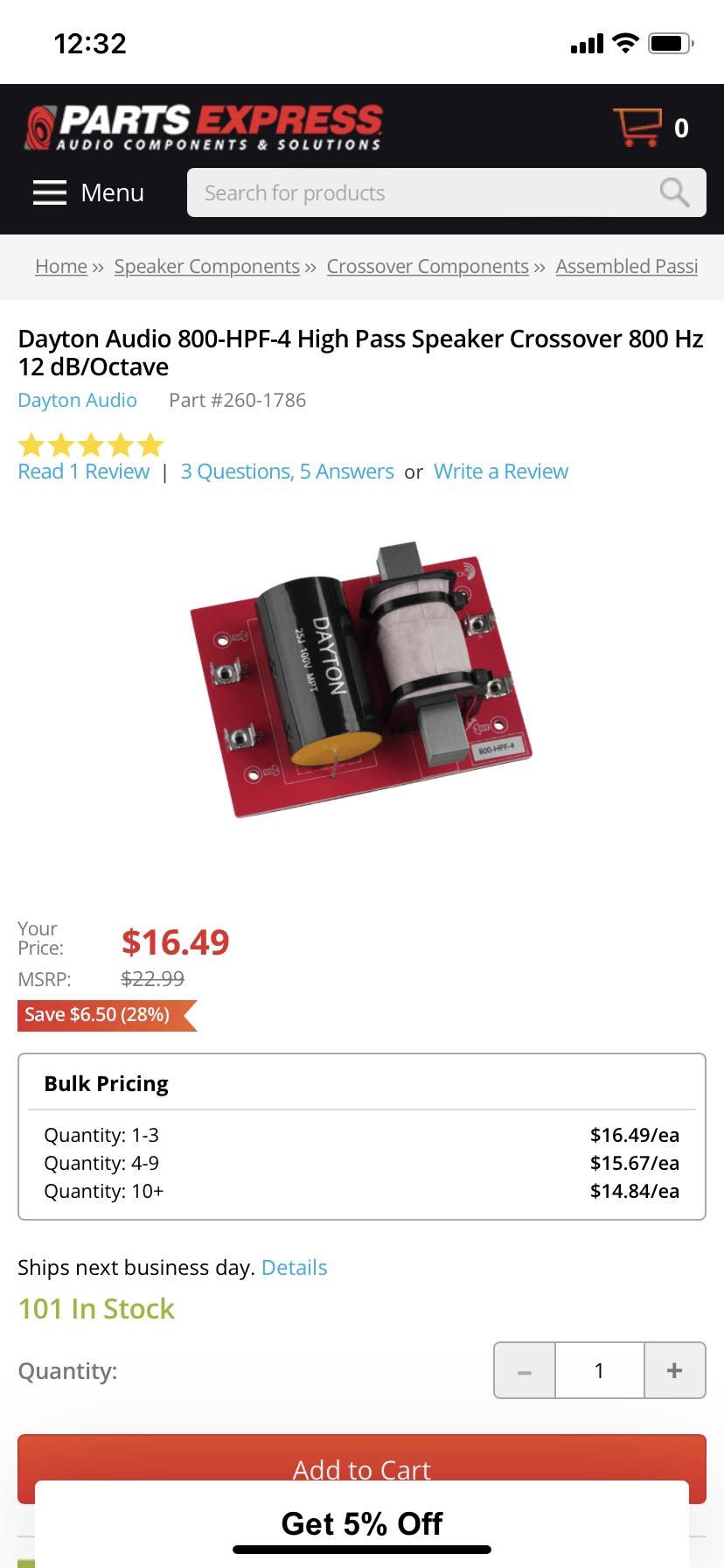

Good morning. I would start off with these cheap crossovers at parts express and work your way up. They had 800hz in 4 ohms at 12 DB. I would also put a L pad on the GRS tweeter because the DB difference is 12DB and the tweeter can over sound or over power the woofer. You might have to build your own crossovers if your not going active. Good luck.
