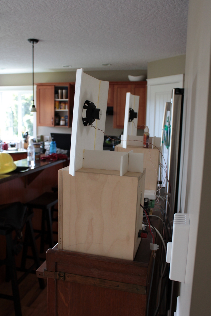

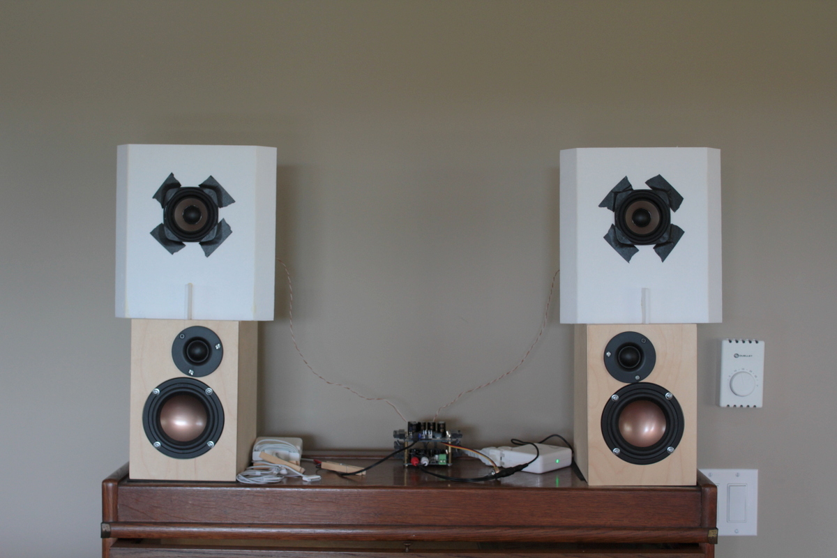

Hello,
I have been messing around with the W3-881si on a foam core open baffle crossed to the HiVi B4N in my Overnight Sensations and I have been really enjoying them. The XO is being done with a miniDSP and miniAMP and centred on 333hz. I chose that point out of thin air, no measurements have been taken. That XO might be a little low, I am going to tweak it more later.
Kyle

Kyle,
Nice FC OB design! You can use wood pieces glued to back of FC to allow screws to hold your drivers in place rather than the tape. Are you disabling the done tweeters in the Overnight sensations? Otherwise the imaging from the 881si's will be off.
The dome tweet is not connected. I am sure this won't be the final configuration of all this. I am going to make a little sealed box for the W3s next to see what that sounds like. Working with the foam core was nice and easy.
Kyle
