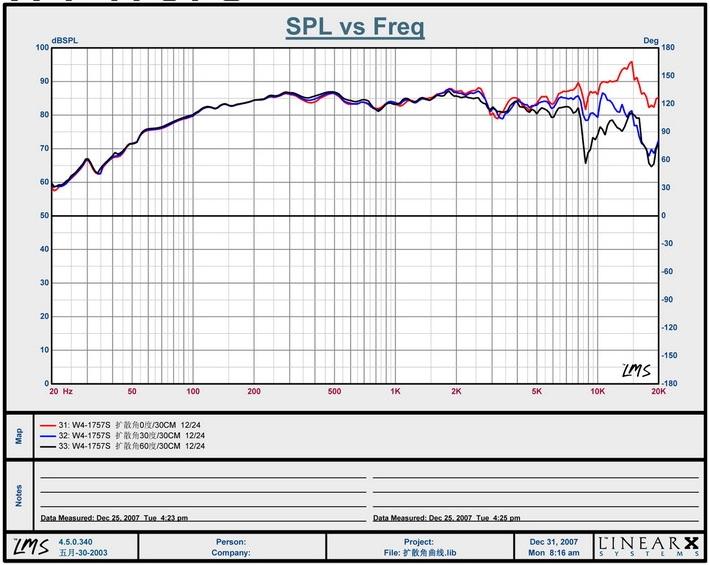

If you look on the TB website both the W3 and the W4 have good looking frequency responses. The W4 has a slight impedance wobble at 2k which coincides with Zaph's measurements. The W3 has a wobble at about 3.2k which could indicate a similar resonance and HD peak issue similar to the W4.
TBs own graphs tend to be skewed towards making sales rather then absolute honesty.
4th order acoustic @ 200hz shouldn't be a problem, but if it has a similar HD peak you'd want to cross this driver steeply at about 1500hz to a capable tweeter. I'd buy with caution and be prepared to measure the thing before using it. If they were somewhat cheaper I'd buy one and measure it myself.

look the dispersion,
here the W4
both ideal for my Mini Posaune and Kornett.
Bass down 34 Hz, bipol double horn.

yes it's the 3", and it does all things better than Coral (on the picture), except singing- there is this Coral unbeatable 😉
the best 3" Wideranger that I've heard,
but maybe this one can compete in overall sound
but not in HF and wide dispersion, with the flat-cones there is no beaming, and my whole room is one big soundstage- not just in front of me, really new dimensions! 😀
The TB Flatcone plays all music well, but electro is his strenght 🙂 and if you've heard some better Tang Bands, than you know that those have some unexplainable magic that is hard to describe- and it can't bee seen on graphs and measurments 😉
