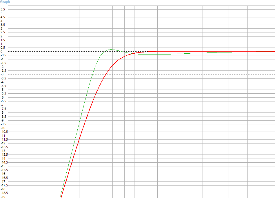

I have plans to purchase four of 830869 for a 2 woofer 3way. I'm designing for Maximally flat, based on posted specs I get 34L tuned to 38HZ. Green is 2 cu feet with 3" pot 5" long.. I'll measure when delivered but wondering if peerless is accurate with their specs..

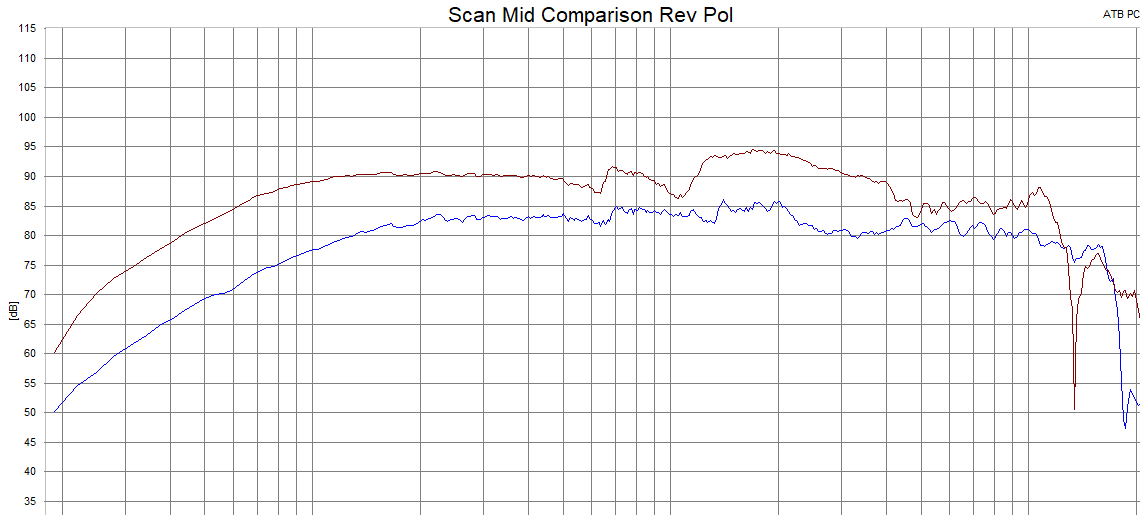

Hi Peter. I'm using Scan-Speak 15M/4624G00. I needed the 92db Sensitivity.
I've used small mid woofers for Mids and have little experience with dedicated Mid drivers, until I purchased the Scan-Speak unit, it has a milder breakup than the Mid woofers that I have. Hearing the Scan driver without being crossed to a tweeter it made me think about Full range driver potential, but I have limited experience with full range and Mid drivers. I'm now thinking about a 2 way with the 22W/8534G00 that has a Glass Fiber cone as well.
Red is 15M/8631G00
Blu is 15M/4624G00

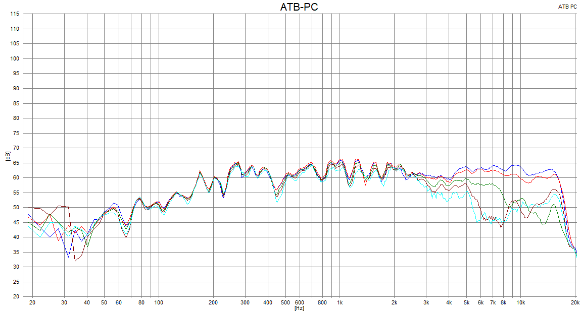

Second graph is 15M/4624G00 at 1M on and off axis in a 4L box

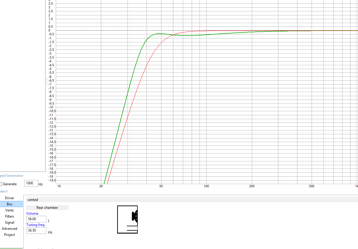

3" port 4.25 inches long is not the best sound IMO - blue curve
The flat line is 33L with 3" port, 9" long - To my ears, flat is always better, give or take a few liters and a few HZ up or down. I Continue to experiment!
