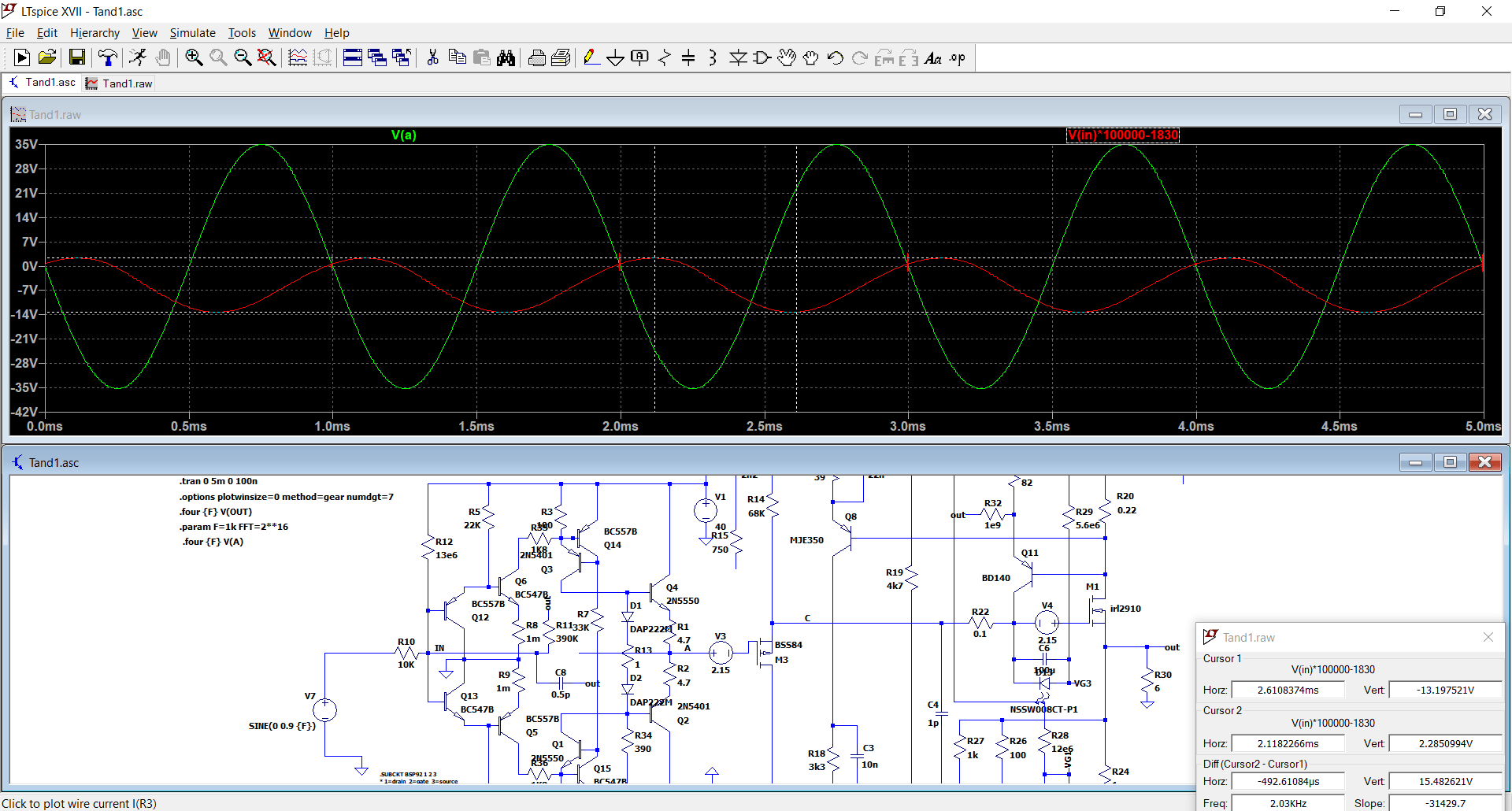

from what is written further in your post, I see that in the simulation they changed the circuit, reduced the resistance at the input and removed the dividers in the collector circuits.In the sim below, you see the voltage at point A (same as output in fact) together with the input voltage times 100K, with an offset removed to remain in the picture. The pp voltage in A is 70V, and the input voltage 12.8Vpp, a ratio of 5.4, meaning the OL gain is 540,000.
That's a sim, in reality the gain is more like ~450,000.

I have added the resistors in the collectors mainly for dissipation and safety reasons: their influence on the overall gain is minor:
You can see it in this sim:
There is a formula for the gain, but it is extremely loose, like any open-loop gain computation for opamps for example. It is totally dependent on the Hoe of Q1 and Q3, which is linked to their Early voltage, but this value is highly variable and inaccurate.
Modern transistors tend to have a higher Vaf than what is stated in their models; in addition, Vaf is a crude approximation and depends on many secondary conditions.
You could compute a theoretical gain based on Vaf=100V, like in many models, but it would be wrong all the time, depending on the actual conditions and voltage excursion.
In addition, the load at point A is not actually a load: due to the negative impedance of the Tandem, it provides additional gain compared to the open circuit situation.
This increases (marginally) the gain at high frequencies for a MOS, and at all frequencies if M3 becomes a BJT.
Nothing of that matters very much: the gain can be 540,000 or 270,000, the end result will not vary very much: that's the strength and beauty of systems subjected to high levels of NFB

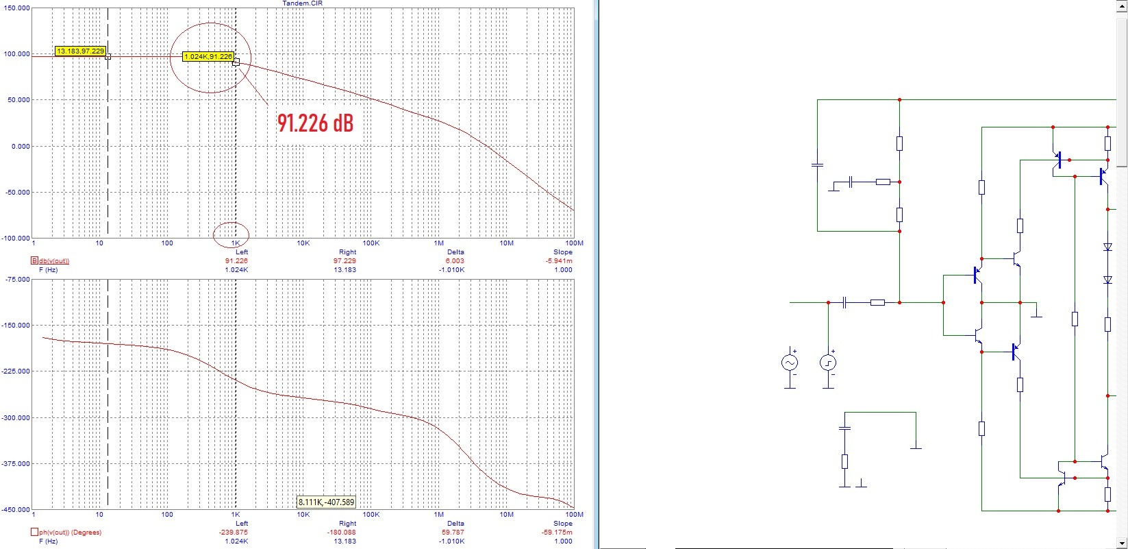

it's strange why I can accurately calculate the gain depending on the frequency up to the 3rd decimal place, and why is it not accurate for you ...

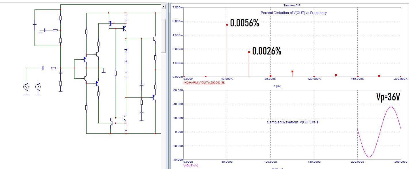

This is of great importance, because you have large distortion due to the low depth of the NFB depending on the frequency. However, you have some half a million ...Nothing of that matters very much: the gain can be 540,000 or 270,000, the end result will not vary very much: that's the strength and beauty of systems subjected to high levels of NFB
This is not a trick, you have large distortions due to insufficient gain with increasing frequency, and you don’t even try to limit the spectrum for this reason, of course there will be overload and large distortions ... Until you understand exactly how to correctly calculate the voltage gain depending on frequencies, tricks will not help you in any way.Btw, it could be very helpful if you could disclose your trick to reduce the THD of this VAS by a factor >1000: I eagerly await for it (and I am certainly not alone!)

There are two parts in the calculation: one is easy and relatively accurate, it is the transconductance of the input transistors.
The second part is much trickier: it is the calculation of the output impedance of the current sources. It is doable but tedious for small-signal conditions, but it will be inaccurate because h22 or Vaf are rarely specified in datasheets, they can vary a lot, and anyway the circuit doesn't operate under small-signal conditions: the transistors see the full output swing, >70Vpp

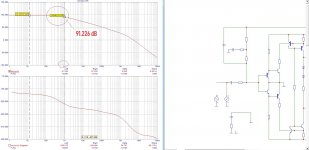

Сould you tell me what the voltage gain is in times at the value of this gain of 91.226 dB at a frequency of 1 kHz?
Including references to literature and formulas. I want to learn how to count in millions too.
Voltage gain (dB) = 20×log (Audio output voltage / Audio input voltage)
Is that correct ? But why in Times?
what do you think?Voltage gain (dB) = 20×log (Audio output voltage / Audio input voltage)
Is that correct ?
But why in Times?
is this a question for me? ask the author of the topic why times ....
I just asked you to translate dB into times - is it difficult for you?
10^(91.226/20) = 36416.65I just asked you to translate dB into times - is it difficult for you?
