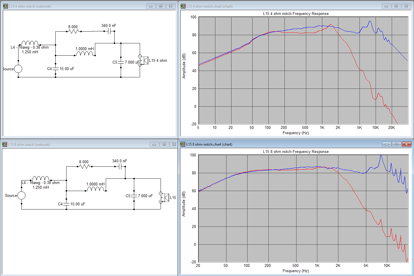

The top 2 windows are the crossover and response for the 4 ohm version. I traced the graph from the madisound sale page, so I can't guarantee this is accurate.
The bottom 2 windows are the crossover and response for the 8 ohm version.
The notch is the 8 ohm resistor in series with the 340nF (or 0.34uF) capacitor.

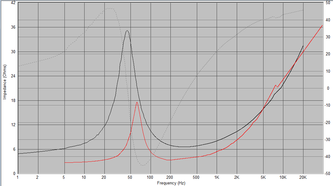

The reason the notch works for both, is the impedance for both 8 and 4 ohm versions are almost identical at the required frequency. I included an overlay of the impedance of each driver below Black = L15 8 ohm and Red = L15 4 ohm
Should I see this in Isolation, that is that the notch filter only ? or did you apply the entire crossover for the 8om version to the 4ohm version?
The series notch - is designed to be paralleled with your low pass inductor. By itself - it doesn't work as the 8 ohm resistor in series attenuates everything..Should I see this in Isolation, that is that the notch filter only ? or did you apply the entire crossover for the 8om version to the 4ohm version?

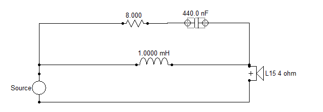

Here's a simplified version of the crossover, which just uses a single 1mH inductor, allowing the series notch to be effective.

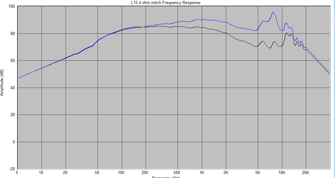

Here's the response. Blue = raw L15 4 ohm, black = with above crossover:

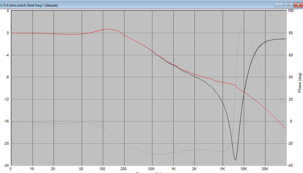

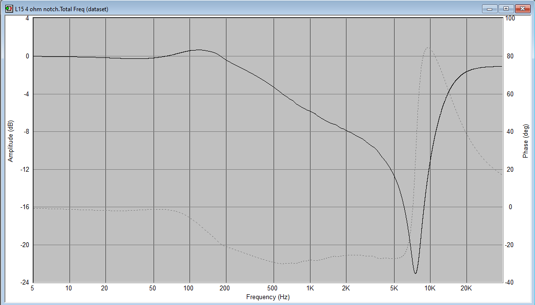

Here's the transfer function of the above filter. Black is the above crossover, red is with the notch removed (thus leaving just the effect of the 1mH series inductor). this shows where the notch is "Striking"
PS: the cap in the notch should have been 0.44uF (not 0.34uF).

This is a parallel notch or a tank. Series notches are components in series and placed across the driver.The series notch - is designed to be paralleled with your low pass inductor. By itself - it doesn't work as the 8 ohm resistor in series attenuates everything..
