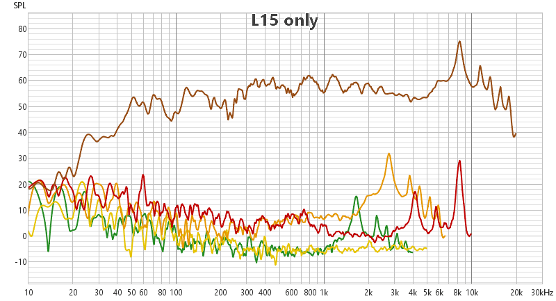

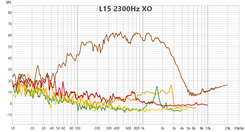

I found I could get away with a XO point of 2300 - steep slope (LR4+), before the HD3 2700Hz breakup (induced from the 8100Hz primary mode) was a problem.
Attached are 2 graphs, one with the raw driver and one with both parallel and series notches. I'll post the notches separately. Of course, impedance will change values for your 4 ohm version
Notice with the XO, the HD peaks are reduced, but still there:

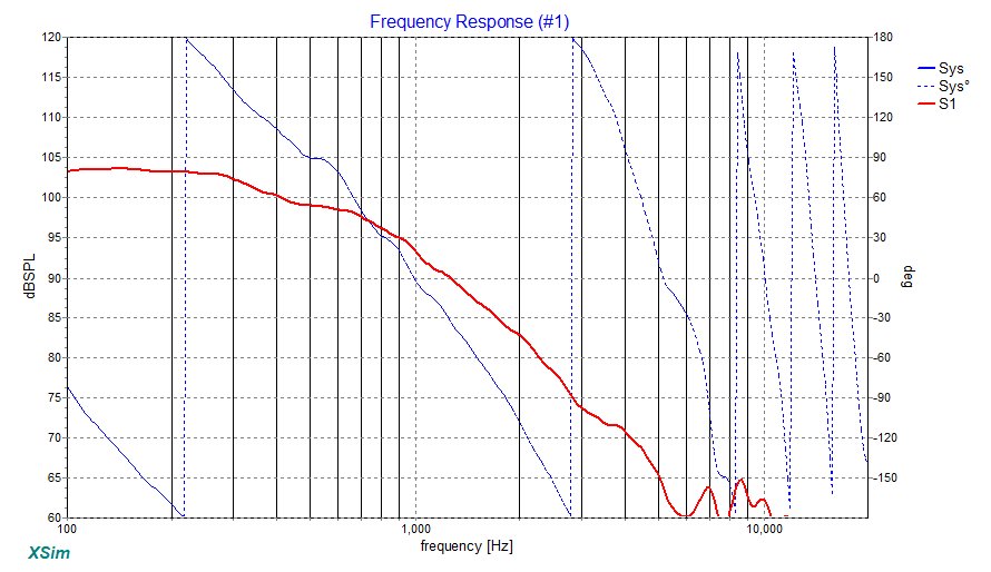

Double whammy - notch overkill:

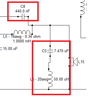

The good thing about Seas drivers, is their production consistency. A bottomless series notch (the leg that has the 7.47uF and 0.05mH) needs to be precise - meaning if you have drivers made from a company that has variable consistency - you must measure each driver to precisely hit the breakup.
Therefore a notch designed for one system should work well in another using Seas.

Here we have a parallel LC of 0.05mH and 10μF.
I think you mean series LC. To use those values and kill the breakup places it in a shunt position.
