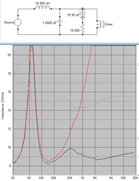

OK. Zobel values 0.47uF and 10 ohms.

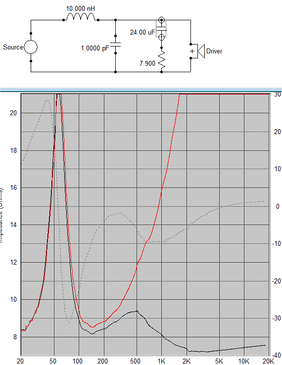

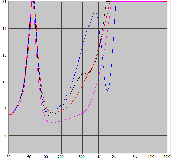

For what it's worth, Here are the results of two online impedance rise compensation calculators. The first is based on the drivers nominal impedance and the frequency where it doubles, the other is based on Re and Lvc. Zphase is shown dotted.

my own woofer......without a Zobel, the gentle 2nd. order linkwitz-riley is struggling

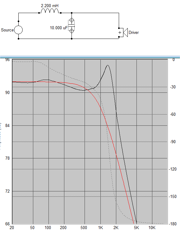

Just for others here and to illustrate what Simon said earlier, the correction is one way forward, but there are other ways.

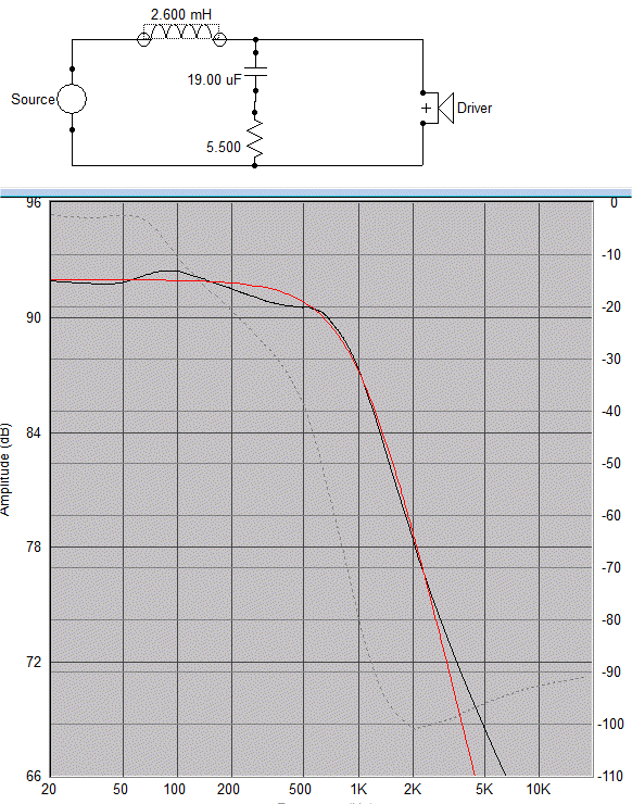

I've created a second order rolloff by starting with RC impedance correction, then a text-book filter (first plot).
Then taken the Zobel away (second plot).
Then modified the circuit to make it work again. The RC in the third plot is not Zobel correction.

You do interesting stuff with that circuit simulator, AllenB. Of course your fudged last Klipsch-style circuit probably does horrible things to load impedance. :D
Seems to me these Zobels are worth persevering with. They don't do anything unpleasant to impedance if you get reasonably close. Makes it better actually. Can't go wrong if you start with a small capacitor and 10 ohms. :cool:

and since you mentioned it, Red is the raw speaker, Black is my 'fudge', Purple is the textbook filter with, and Blue without the impedance correction.
Oh yes. Purple (Zobel) is DEFINITELY best! ;)

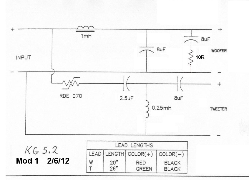

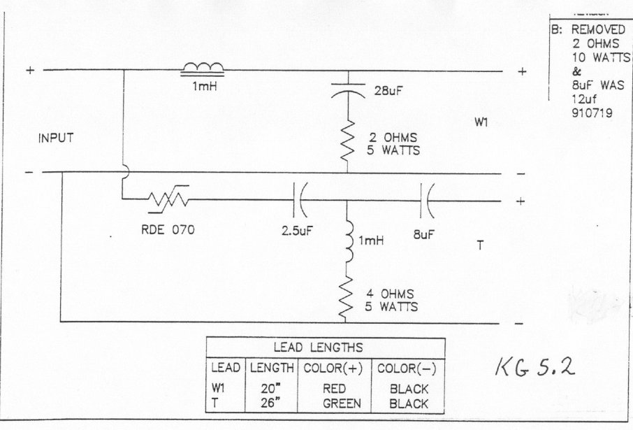

Here's the 5.2 crossover again:
I always notice with these shunt resistor crossover arrangements, that you can replace the inductor or capacitor plus 2-4 ohm resistor with a quarter of the reactive value and keep things similar.
Thus 28uF+2R becomes 7uf in the lowpass shunt arm here, and 1mh+4R becomes 0.25mH in the highpass shunt to give you roughly standard calculated crossover values and a more familiar look. And I'm getting about 3kHz crossover for the tweeter. :cool:
What makes this whole problem a nightmare is you really don't have any level to play with on the horn compression driver. Padding it with resistors will reduce efficiency, and adding Zobel will rolloff the deliberately lifted high end. You'll also be getting a lot of rubbish from the bass in the cone breakup region and above IMO.
You might pad it down though, and restore some high end with tone controls. John Linsley-Hood often suggested this where getting record player pickups right was problematic.
Ah, I wish I knew how to figure out these things.
It turns out that my particular KG5.2-style crossovers have 33uF in the LP, not 28uF.
So 33uF+2ohms could be replaced by about 8.2uF? I'd be glad to do that.
I redid the KG4.5 crossover boards.
- In the HP part, I changed the 3uF cap to 8.2uF.
- In the LP part, I jumpered out the 12 ohm, let the 1mH go directly to ground.
The resulting sound was very close to the stock KG5.2-style crossover (that's labeled KG 4.5 for some inexplicable reason). There was a bit of a hole in the response that made female voices recede too far back, and a generally "washed out" midrange. So I put a 5.5 ohm resistor in the place where the 12 ohm used to be (where there's 4 ohms in the KG4.5 crossover, but I don't have any 4 ohm resistors). The sound from the modified KG4.5 crossover is now very close to the stock 5.2 crossover, except some of that "hotness" is back in the modded KG4.5 xover, but not bad when using the stock KG5.2-style xover.
I wonder if this is due to the fact that the 4.5 crossover has an air core 1mH in the HP, while the 5.2 crossover has a ferrite core 1mH? Higher DCR of the air core results in less attenuation? Less steep slope of rolloff?
Since I like the sound with the KG5.2-style xovers in, I tweaked them a little bit. Put a 220nF oil-paper cap parallel to the 33uF electrolytic, and bypassed the 8uF with a 100nF oil-paper cap. Bypassed the 2.5uF cap with a 30nF orange drop PS220 (mylar?). Those were just caps grabbed from my junk box. That only made a barely noticeable difference, maybe slightly better upper frequency clarity.
At any rate, I find the KG5.2-style crossover sounds much better to me than the original KG4.5 crossover. This is still a bright, in-your-face speaker, but it sounds a lot smoother this way.
I now have a pair of KG4.5 boards that can be played with. So, how about this (attached)?
