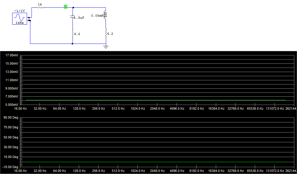

The better standard design is this:
Like this?
Or do the L and C values in the HP network need to be changed too?

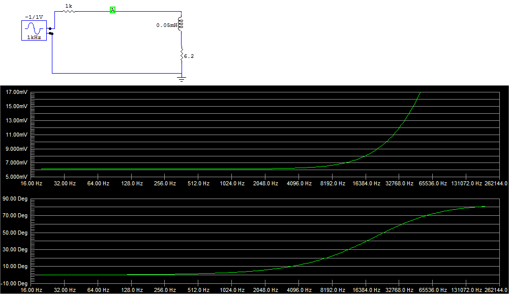

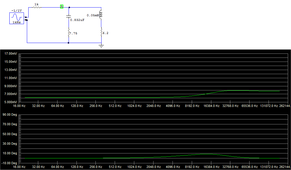

The RC circuit you've added to create this frequency response change is not a Zobel, but that's OK if it works for you. Zobels do not actually fix harshness and furthermore, adding Zobel correction to a preexisting crossover is technically wrong.

Most people I think assume that a zobel on a tweeter will do nothing (since it's flattening the impedance well above the high pass crossover frequency) but in actual fact it can still roll off the top end of a pre-existing tweeter crossover quite a lot.
As an example I have a ribbon tweeter with a passive 4Khz 18dB/oct butterworth crossover, the tweeter has a very modest impedance rise at the top end compared to a dome (rising from a minimum of 8 ohms at 3Khz to only 9 ohms by 20Khz) yet connecting a zobel to flatten out the impedance curve causes a full 1dB reduction of high end treble above around 7-8Khz, as well as a significant change in the response shape from 4-10Khz. (Without the zobel the crossover actually has voltage "gain" at high frequencies of nearly 1dB...) A 1dB reduction in top end treble is a very noticeable change.
On the other hand all the zobel is doing is rolling off the high end, it's not curing any harshness, perhaps just making it less noticeable in the same way the same EQ applied elsewhere would. (It's still there though, if you listen to the right music)
Exactly. If a zobel gives you the target response, fine. If you can get the target response without it, also fine. Just adding it to a crossover not optimized to have it or removing it from one that was optimised with one in mind is just pot luck though.

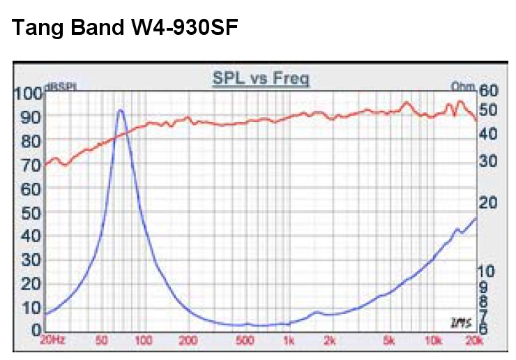

Would anyone like to help me understand this better? For an example, I have a pair of Tangband drivers, complete with the factory specsheet. I'm sure the published specs are pretty far from the actual characteristics of the drivers, but I can't do much about that. But at least I have some specs to start with, instead of the Klipsch with none at all.
I've attached the published curves for the Tangband W4-930SF. It has a rising response, including a rising impedance as you go up in frequency.
This speaker has a pretty good spike at 6500 Hz or so. It sounds like it, too. Also a pretty intense flip at about 13kHz, but let's say we leave that alone for now.
First, would a zobel be the first thing to apply, to make the impedance appear flatter to any notch filters, etc. you'd apply?
After that, what nominal impedance would you choose for figuring LCR values for a notch filter? 6 ohms, or the voice coil DCR of 5.6 ohms? Or the impedance at the frequency to be notched?

On first thoughts I wouldn't add impedance rise compensation just to notch the 6k5 peak because roughly speaking, the notching effect is somewhat narrowband and kind of takes care of itself, but more on that in a minute.
I probably would add full Zobel compensation before I started a fresh crossover for no reason other than it allows a more free flow of ideas during design. Later I'd probably try to squeeze it out.
A hint on notching the peak though. I'd try to figure in a small dip in the sensitive 3k-4k5 regions with the same notch filter as the 6k5, trying to flatten one edge of it with the edge of the filter. I'm only guessing whether it would work at this stage and it may not, but in balancing up those two tasks here, the impedance rise might have an influence on that balance and that would be a reason to look at modifying the impedance at that node.
I hope that was helpful.
For the Zobel, I got 3uF for C and 7 ohms for R.
Next up, figuring the notch filter. So Allen, you'd make a broad filter that would attenuate the 3k to 4.5kHz region? The equations I've seen for calculating the notch filter components ask for a F3lo and an F3hi, with the peak in the center. Are you thinking the center should be lower than 6.5kHz, and the filter should be broad acting (low Q)?
Trying to understand what you wrote, I hope I'm close.
That peak at 6.5KHz is a textbook example of a resonance that would add harshness, (perhaps sibilance too, given its frequency) and because its symmetrical in shape and the response is relatively flat on either side, is a good candidate for correction with a notch filter, be it passive or active.
I probably would start with a zobel to flatten the impedance, yes. A flat impedance will result in a symmetrical notch using an RLC notch, whereas a rising impedance would cause an asymmetric notch.
Impedance at the frequency to be notched.
However its easy to get carried away with trying to calculate these things to the nth degree when its really not necessary. Do a rough calculation, measure, tweak. You'll need to be measuring the response of the driver anyway, which wont be quite as published. For a notch filter correcting a high Q resonance its really important for the centre frequency to be correct or you can just make things worse. (You end up with two side by side resonances instead of one cancelling the other out)
The way I like to do it is measure the acoustic response, use a digital active PEQ to adjust the centre frequency, width, and depth to give the flattest measured response, measure the electrical response at the speaker terminals with the PEQ in place - then build a passive notch that follows that electrical response (with the PEQ turned off) as closely as possible. :)

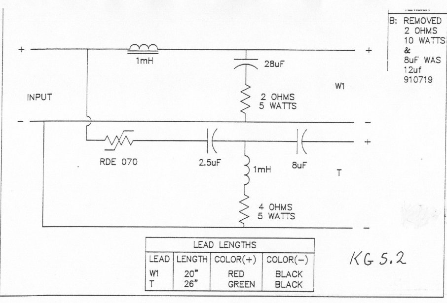

Interesting coincidence too that I bought a spare pair of KG4.5 crossovers on eBay (the price was right). They say KG4.5 on them, plain as day, but they are not the same as the crossovers in the speakers I have. These eBay-bought crossovers look exactly like the crossovers for KG5.2. The woofer circuit is the same (1mH, 33uF 2nd order with that 2 ohm resistor between the 33uF cap and ground). . The tweeter circuit is a bit different, though. The cap values are changed to 2.5uF and 8uF, and the 12 ohm resistor from the 1mH inductor to ground is changed to only 4 ohms. I should try popping that crossover in and seeing if it makes a big difference. The KG5.2 used the exact same tweeter and woofer as the KG4.5, but instead of a vented cabinet. or a 10" passive radiator in the case of the KG4.2, the 5.2 used a 12" passive radiator. I guess that answers the question -- I should try the different (later version) crossover.
Does that KG5.2 crossover look less obviously weird than the original KG4.5 crossover? Or just as bad, only different?
I'll also try connecting the 33uF directly to ground by shorting out that 2 ohm resistor, and try to see if I can hear the difference.

Hah! I did that. It does cool out the tweeter, quite noticeably. But I thought it also closed down the speaker, made it lose the character that was fun about this speaker. Might be that the only thing attractive about this speaker is that it's loud and brash like a PA speaker. BTW, the Chorus and Forte models that have this 40 ohm parallel resistor are 3-ways, using a different tweeter driver.
