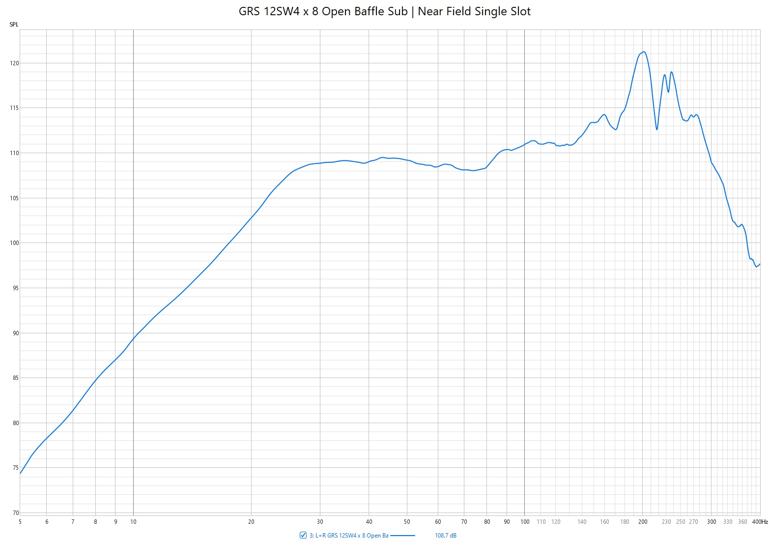

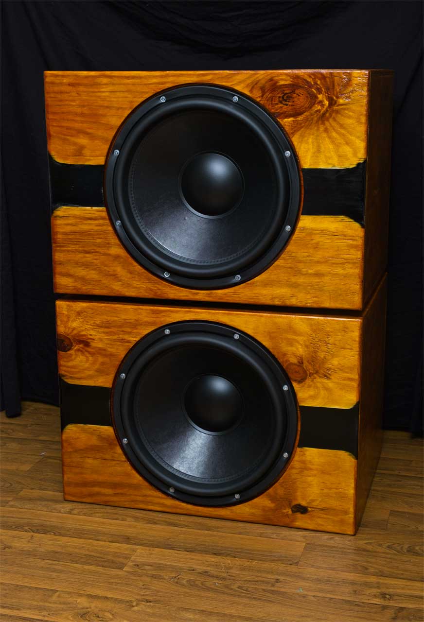

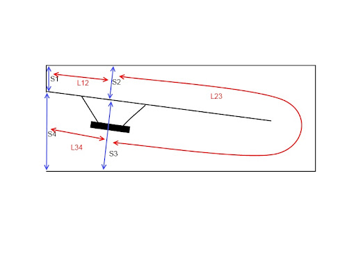

I ended up doing an 8 driver open baffle w-frame sub. It's flat to 27hz then rolls off. This is with 8 x 12" drivers. It's 50" tall, 21" total wide, 12.5" deep. Occupies very little space on the floor. Slot loaded on the front (4 slots).
Natural response with the cavity's peak resonance in the >200hz range. Flat to about 27hz (fundamental A1). Zero EQ here. Zero smoothing.
It would be very unusual for an OB of those dimensions to have this kind of response so my guess is that this FR data is of the nearfield response at the front or rear and not the farfield response. Even with the driver's elevated Qts, there should be a region of 6dB/oct slope due to the front+back cancellation effect. Have you made an outdoor measurement at at least 3m distance?
Edit: I see you mentioned that, yes, this is a nearfield measurement. The farfield will show more LF droop. But with the size of the thing you will get some proximity gain at LF and it might compensate for the OB/dipole cancellation to some degree, especially if you can position them not too far from your listening position.

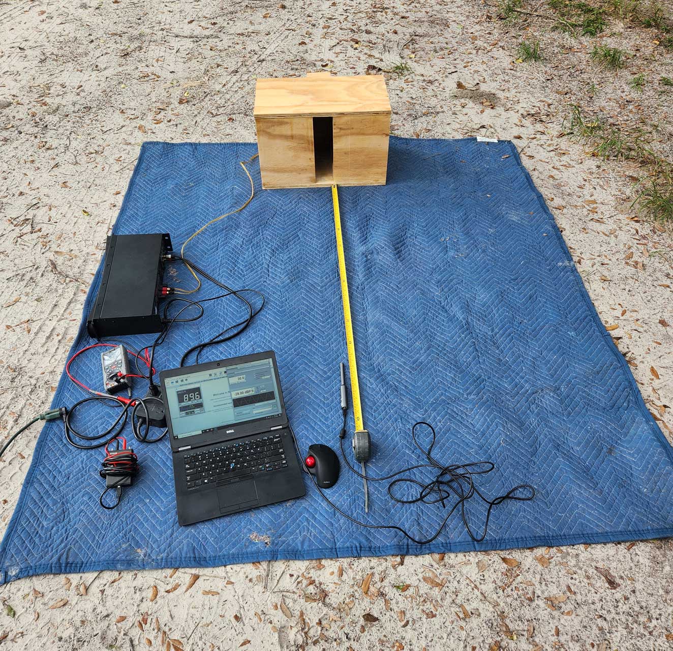

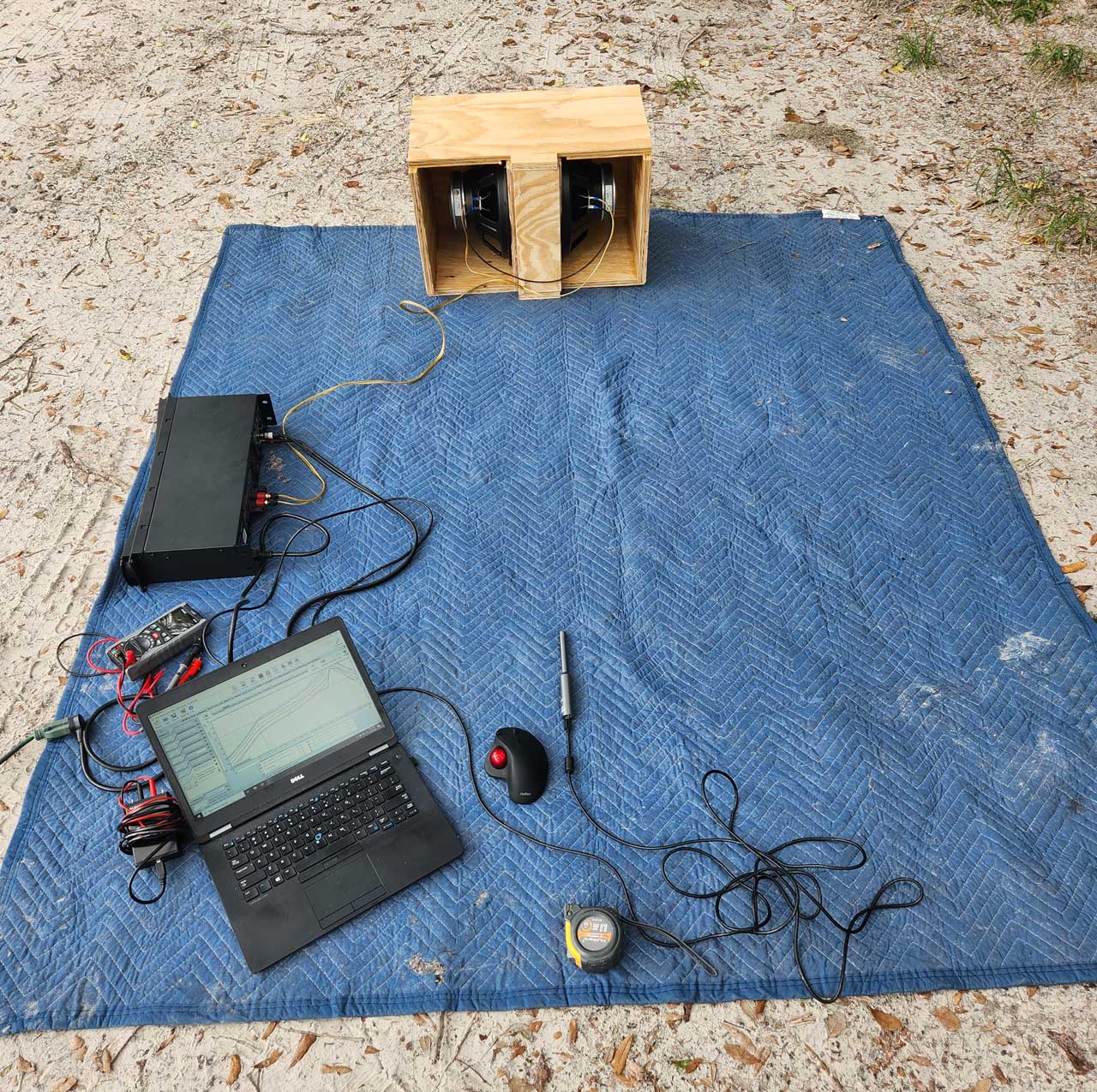

My prototypes were measured ground plane outside so you can the behavior. This 8 driver version is scaled up from that and shows the same response pattern. I'll measure it soon.
Mean while, here's the prototype that I did to proof of concept this thing before building it with 8.

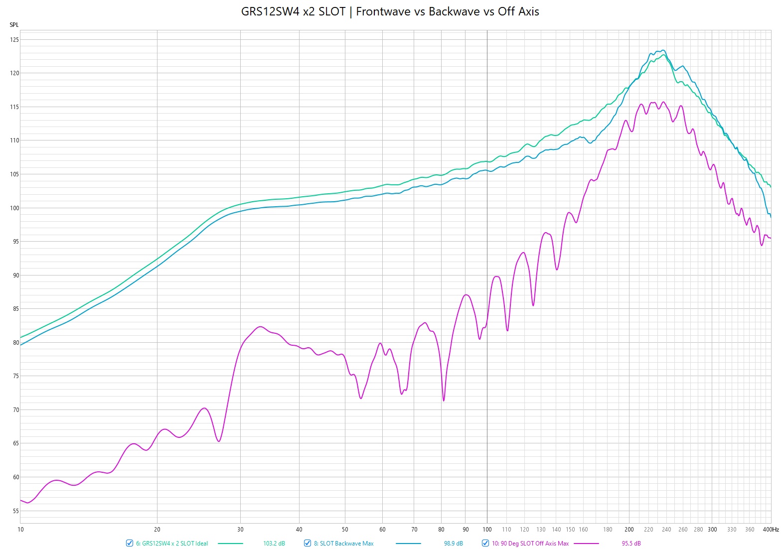

2 driver version ground plane:
Front wave (slot)
Back wave (two rear chambers)
90 degree off axis, measured at acoustic center of the front slot at 1 meter
Top line is the slot output (front wave)
2nd line is the back wave output at 1~2db lower SPL/energy
Bottom line is the 90 degree off axis, dipole cancellation as expected.
No filters or smoothing anywhere.
There is a droop in the lower frequency output as you mentioned, the knee is still in that 28hz range, but it's not bad and is a 5db from 100hz to 30hz roughly. Still, lovely response potential without DSP. With a low pass filter to kill above 110hz, it's a lovely response to fundamental A1 naturally.

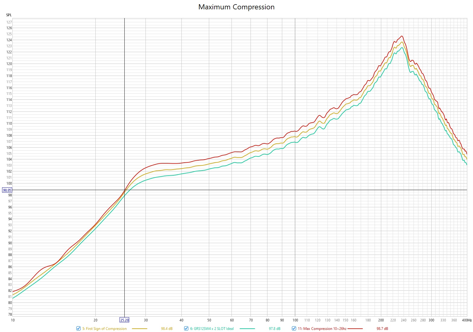

Compression tests to see where the drivers met their limits; I tested this in larger slot cavities to verify it wasn't the cavity itself, it was the drivers. These drivers are not high excursion so they compressed below 28hz when they hit their excursion mechanical limits.
Here, fully compressed, mechanical limits of the drivers, increasing by 1db. No gains below 28hz, mechanical limits of the drivers' excursion. But I can keep getting output from 30hz and up as the excursion limit isn't met. So these can go a lot more if I high pass them at 30hz.
From this I scaled up the 8 driver version.

Outside wont help you as you wont get any dipole cancellationThat was just a quick sweep and a quick low pass. I just got the drivers installed last night waiting for my power to go out in the storms (Florida). I still have more work to do on it, but wanted to do something other than think about the hurricane and tornadoes.
Those sweeps were near field, near the wall.
I will be doing ground plane measurements soon outside to get a good measurement and will make a build thread about this particular enclosure soon.
Very best,

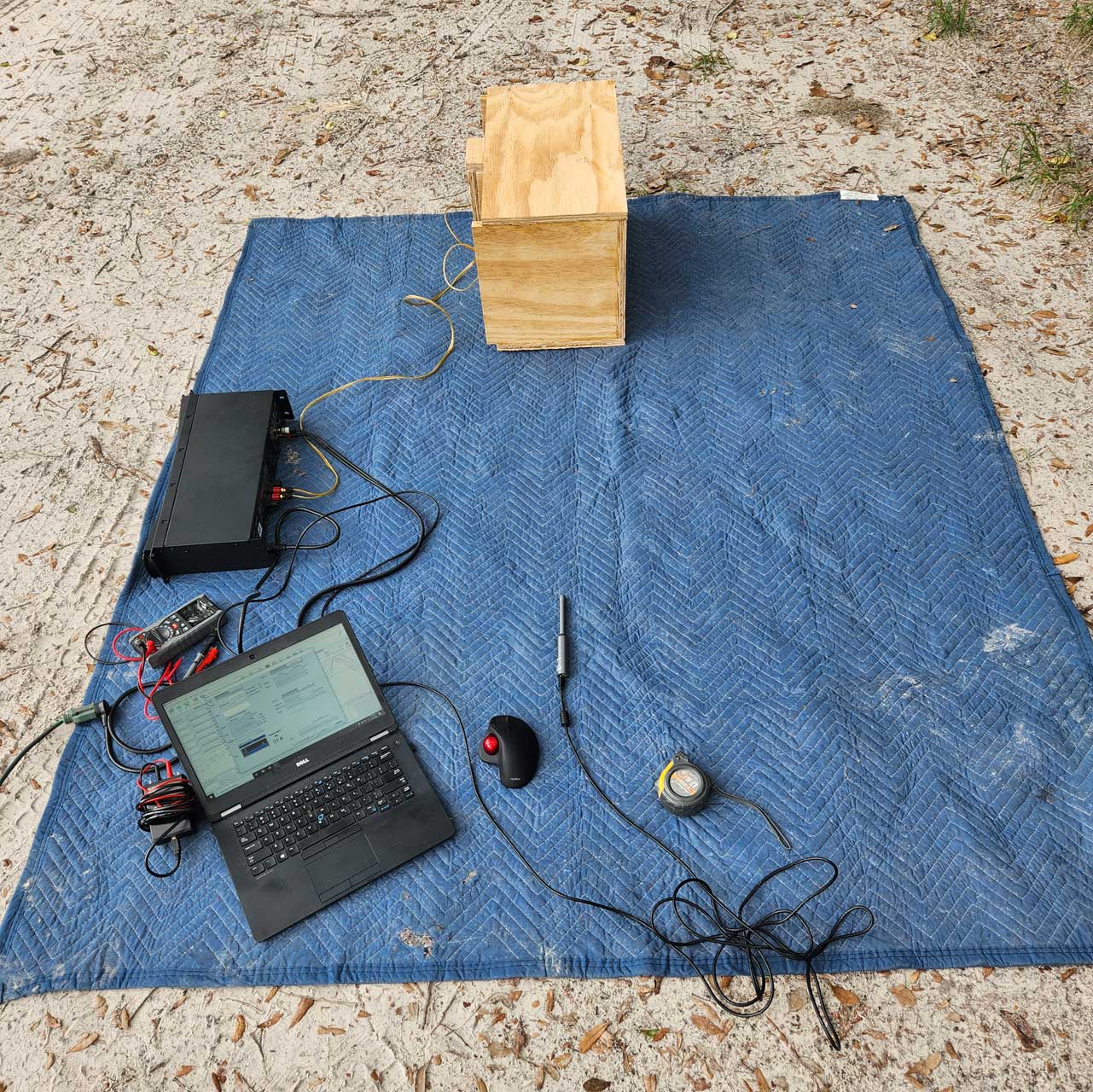

Against the wall as you have it measures as a pseudo cardioid as the rear wave is somewhat constrained by the rear wall and you cannot model or predict how that's effecting the phase
Maybe not precise. But you can see measurements above where off axis shows dipole behavior even outside with no boundaries with a ground plane measurement. Unless that is a different effect you can explain?

Unfortunately 1m is still too close... You should be measuring at 3m or more.
Ok thanks, I'll see what I can do when its dry outside again (storming).
Very best,
Sure you will. You do not need walls or boundaries for the front and rear outputs to interact. They are both propagating like a monopole below a few hundred Hz, with pressure moving outward more or less equally in every direction. At any point in space you can model the dipole response just by summing two monopole sources while accounting for phase and SPL changes due to propagation from the location of the front or rear source to the listening position, and adding these two together. I do this all the time and it is perfectly valid at low frequencies. This will not capture the effect of the tunnel resonance from the slot or H-frame, but you can measure that in the plane of the opening and then use that as your source.
Sounds good. That way you can be sure that you are capturing the dipole cancellation "droop" properly. What I suspect you are measuring now includes some LF proximity gain. You can read about that effect here:Ok thanks, I'll see what I can do when its dry outside again (storming).

I have 16 sealed subs for theater. Many of them stacked. You can do any number of drivers, but I like keeping the count lower to keep weight down per unit so I'm not moving extremely heavy boxes. These 8x12" cabinets are exceptions, small for the driver count, light weight drivers.
If you do 2 drivers per cabinet, you can wire them externally so you can access them individually for wiring purposes, so you can get ideal wiring depending on their impedance and amp. Or you could just go ahead and wire them in series, and then in parallel with another 2 drivers to the amp per channel.
My cabinets when I stack do not wobble, but they're not ultra light and they have 20"~30" bases they're sitting on when I stack low squatty subs. I like to stack in pairs. I could stack more, but lifting weight that high is not fun.
Opposition pairs is a great way to have zero vibration from the box if you want to stack things. Really ideal.

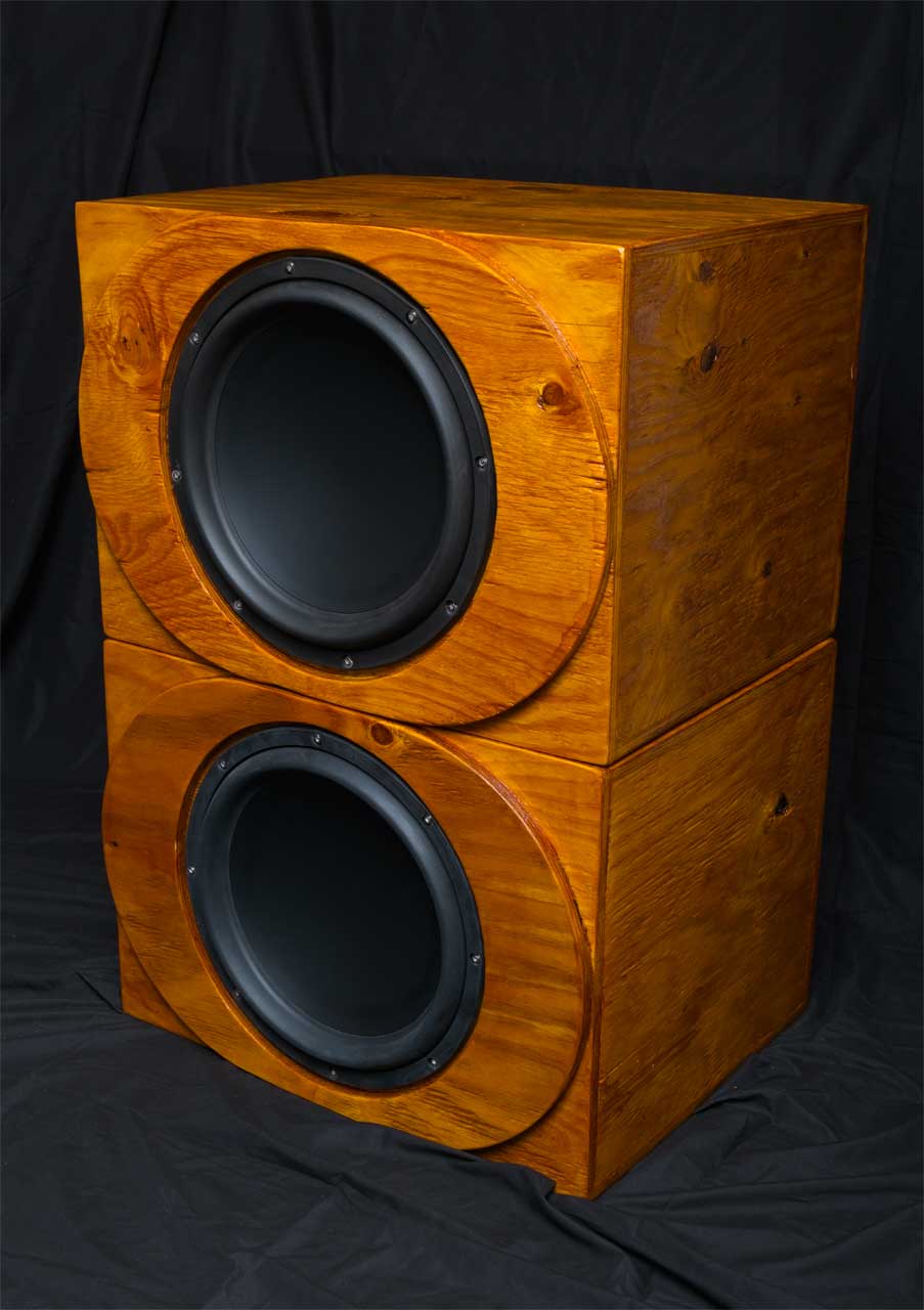

I did these:
4 ft^3 sealed enclosures. MX15-22 driver. Two stacked. I have 8 total. Two groups of 4 on the amp channel (4ohm series-parallel).
These are the others. These are bigger. 6 ft^3 each. HT18 V3 driver each. I stack them in 2's. That's 12 ft^3 stacked as a fat tower with two 18's.
Otherwise, using 12's, I would probably just do 4 drivers per enclosures, 8~12 ft^3 single towers. No stacking. And do opposition pairs. 2 on the front. 2 on the back. For position I would face them so the drivers are the same distance to the listener, so drivers would fire to the sides and the blank wall of the sub pointed at the listener. Two towers like that. 8 total 12's. Opposition pairs with no cabinet vibration. Two channels total needed.

Thanks for your reply, you seem to have lots of experience with these things. The upper picture is something that I had in mind. I thought that I could do slightly smaller cabinets and have total of 8 pcs of 12" drivers to match the output of the 15" (upper) bass woofers of my main speakers.
You say that opposing firing woofers would be ideal and I concur, but my only problem is placement in my listening room. It would be a lot easier to stack array of 4 facing forward than opposing woofers. But then I thought of wobbling if going for lighter cabs, but I guess that would be a problem only at ridiculously loud volumes. Maybe I could to rearrange my furniture a bit 🙂 I will need to plan this through. Thanks again for yor thoughts.

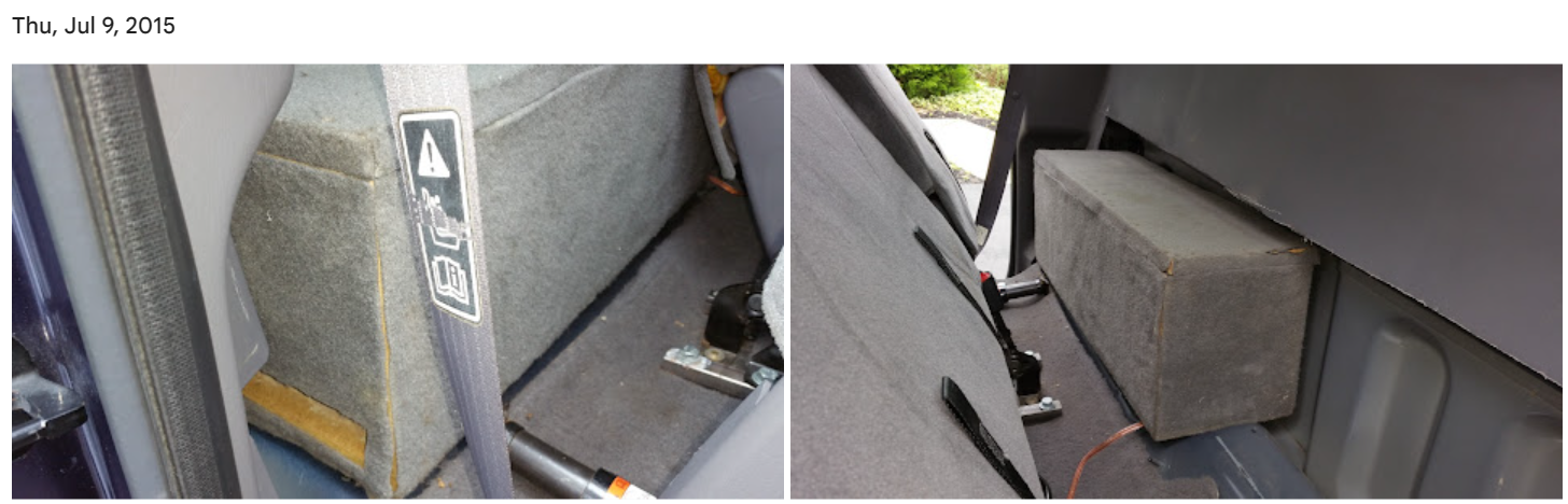

So do all these line arrays apply to this application with 8 inch subwoofers in a line? We see plenty of dual driver subs. In car audio we see lots of drivers all over the place in the cabinets. But in home audio, we mostly see separate subs for reasons we know about. In this case, I'm thinking about smaller 8 inch drivers, heck even 6.5" drivers would be cool, in a tall skinny enclosure and lots of them to have a smaller foot print, taller for the cab volume, to operate as a competent sub. Not looking to get 20hz performance, but let's say 25hz F3 and strong 30hz and up? I'm not sure how to model this and if WinISD is appropriate for 4+ drivers in a single ported enclosure or sealed?
I don't see a lot of subs with more than two drivers. I imagine there's good reason for this. I'm not trying to reinvent the wheel. Just thinking of something fun and a bit different while filling a niche with a tall skinny box. I would think that with more drivers there would be less power needs and they could extend deeper with fairly good cabinet volume. Should be able to make a tall 6.5" driver based sub or 8" driver based sub that is a small line tower? Again I see plenty of towers with 2 bass drivers out there. What happens when you go from 2 to 4 that causes problems?

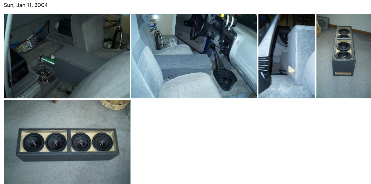

Done it! This 4 x 6.5" BP4 is still pounding after 20+ years.
