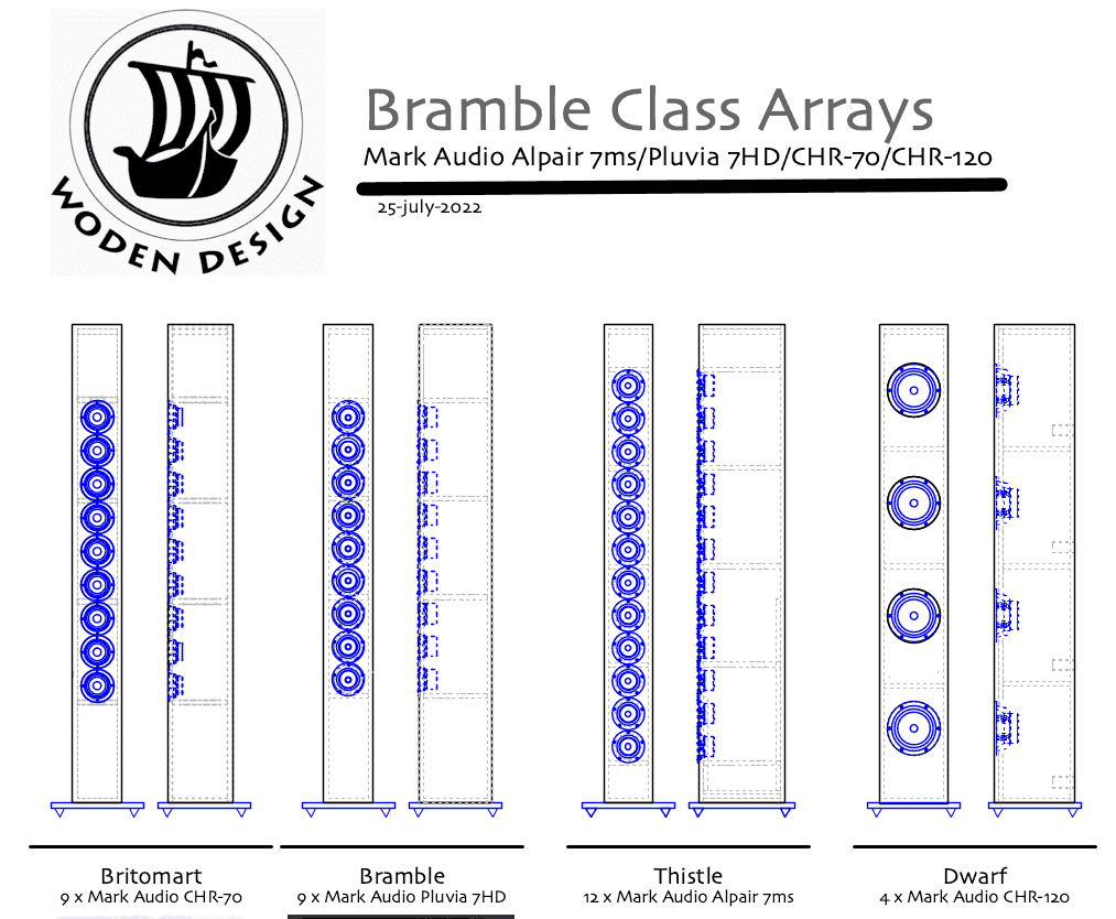

Dave HiIt is a good idea. And i just happen to have open a new set of designs from Scott, where one of the boxes mimiks your inquiry.
An early teaser.
dave

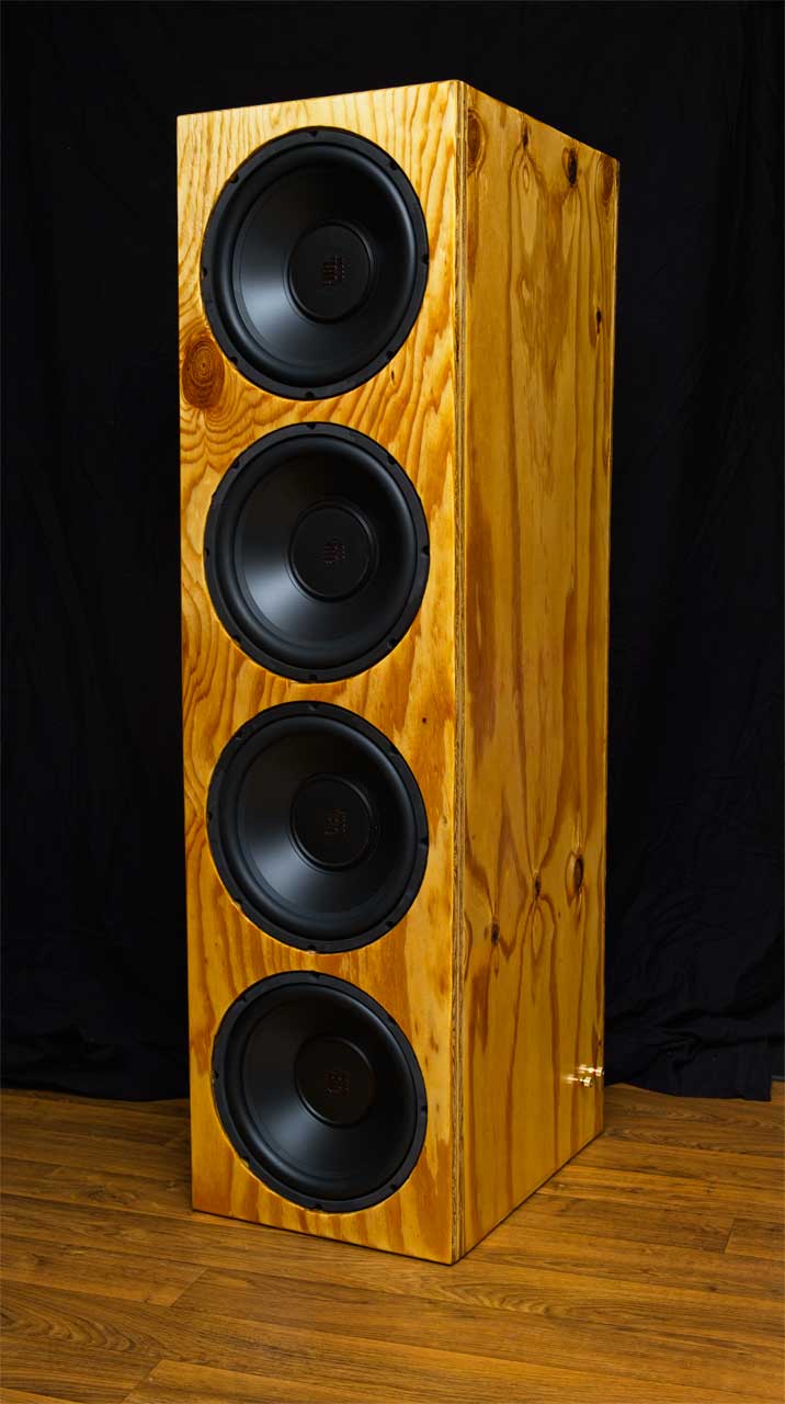

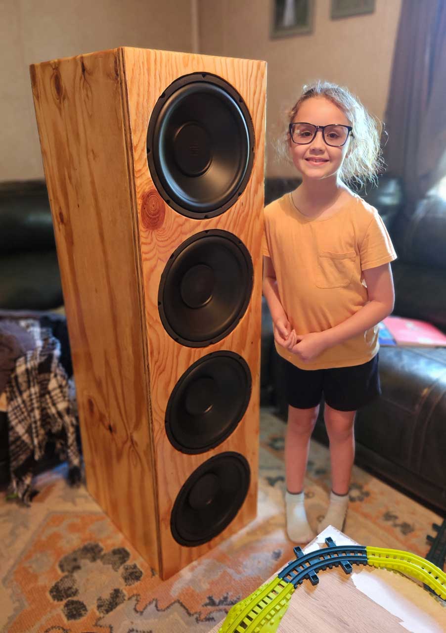

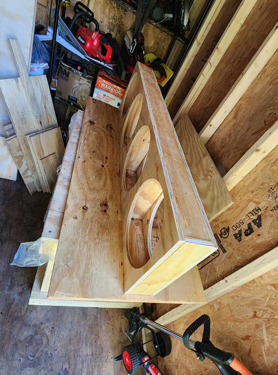

I ended up doing something different.
I did a tower with 4 x 12" drivers.
And now I'm doing a tower with 8 x 12" drivers (hahaha). This one isn't done, I'm currently on hold due to the hurricanes here in Florida. But the manifold and baffle are done. 4 x 12" drivers on each side, cone to cone, squeezing out of slots.
As soon as the storms are done, I'll have a build thread on this one.
Very best,
Which Sub 12" you used and DSP? how was it happy ?

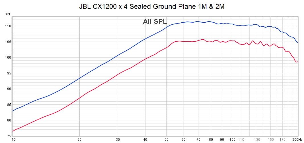

I used 4 x JBL CX1200's in the tower above. I like it. I use it near field and it packs a lot of punch for pennies (very inexpensive).
I had to stop here due to microphone clipping limitations. It had plenty more room to keep going up. But my mic was clipping in that 112db range. I easily get 130db from this thing. Currently using a Crown XLS1002 with it, bridged. I use a MiniDSP HD2x4 and it's on one of its channels for EQ/DSP.

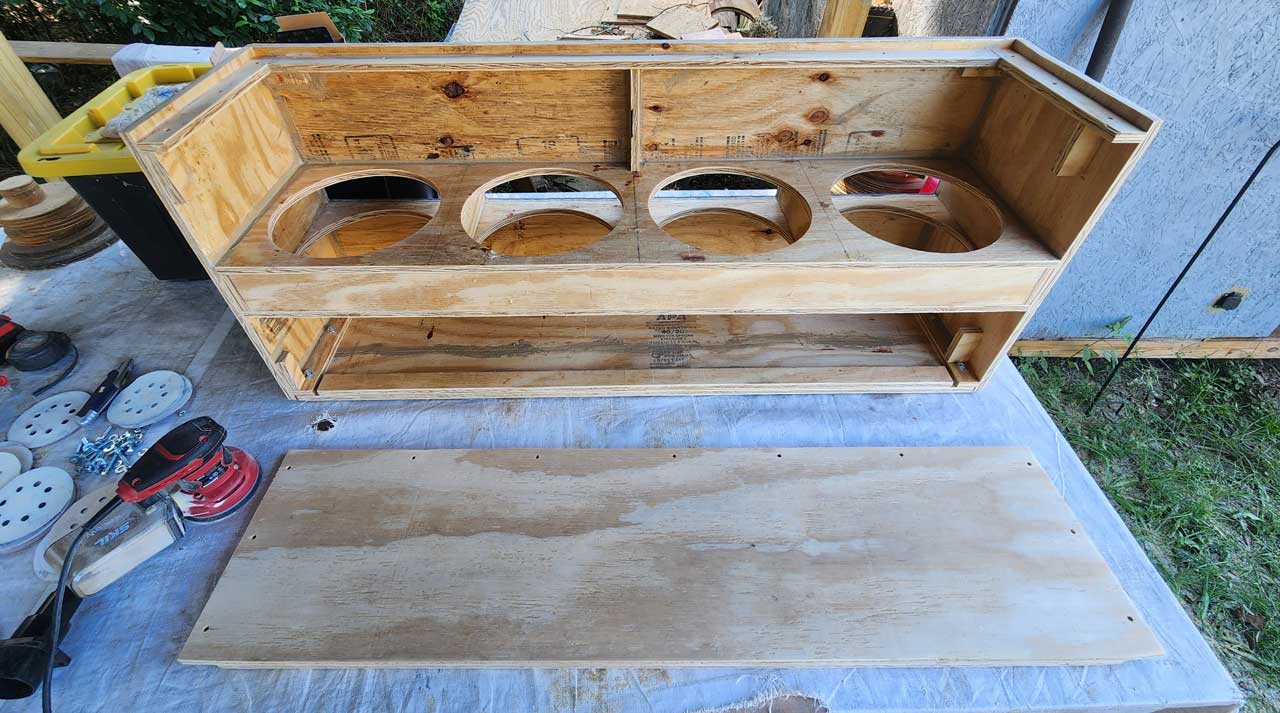

Hi all,
I was able to build a physical model of just two drivers (this will scale to 8 total eventually) and do some tests on cavity width and all that. Crudely.

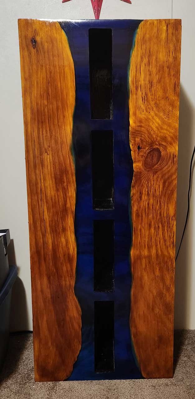

Baffle dimensions, W-frame with a slot:
Effective baffle width: 12" + 9" + 12" + slot width + 12" + 9" + 12" = 68.5" width for the 2.5 inch slot, and 72" width for the 6 inch slot.
Front baffle total width is only 9" + slot width + 9". So 21" to 24" actual width.
Height is 12" plus material thickness. But will scale to 8, so it will be closer to 55~60 inches total height.
Depth is 12.5" roughly, but will have a lip around...

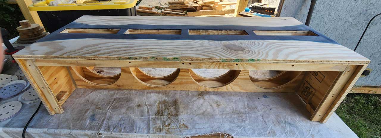

And better prototype here with measurements to compression:

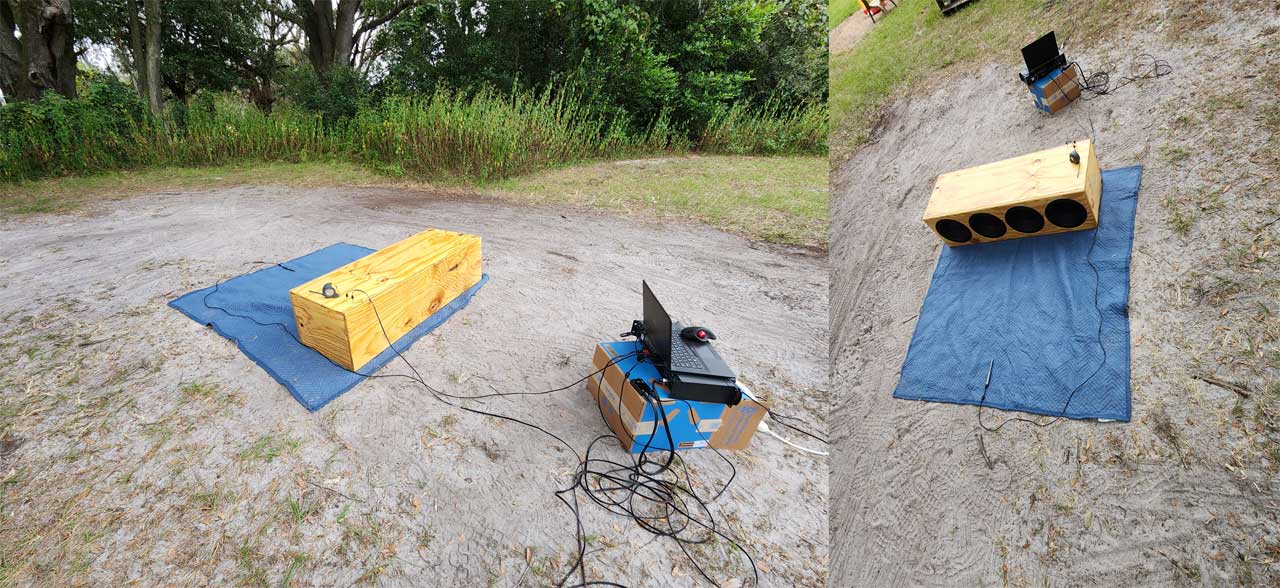

Update, new prototype finished. Measured.
21" wide, 13.5" tall, 13.5" deep. Internally about 1.6 ft^3 displaced. W-frame slot loaded open baffle
GRS12SW-4 x 2 ($31 each) wired in series (7.7 ohm)
DATS to see Fb and baffle resonance, noted the 225~240hz spike expected from the slot cavity resonance.
The crude form:
Measurements:
Ground plane 1 meter
First, I took my jig out and took them to peak to peak xmax over 16mm, and they were still...
The crude form:
Measurements:

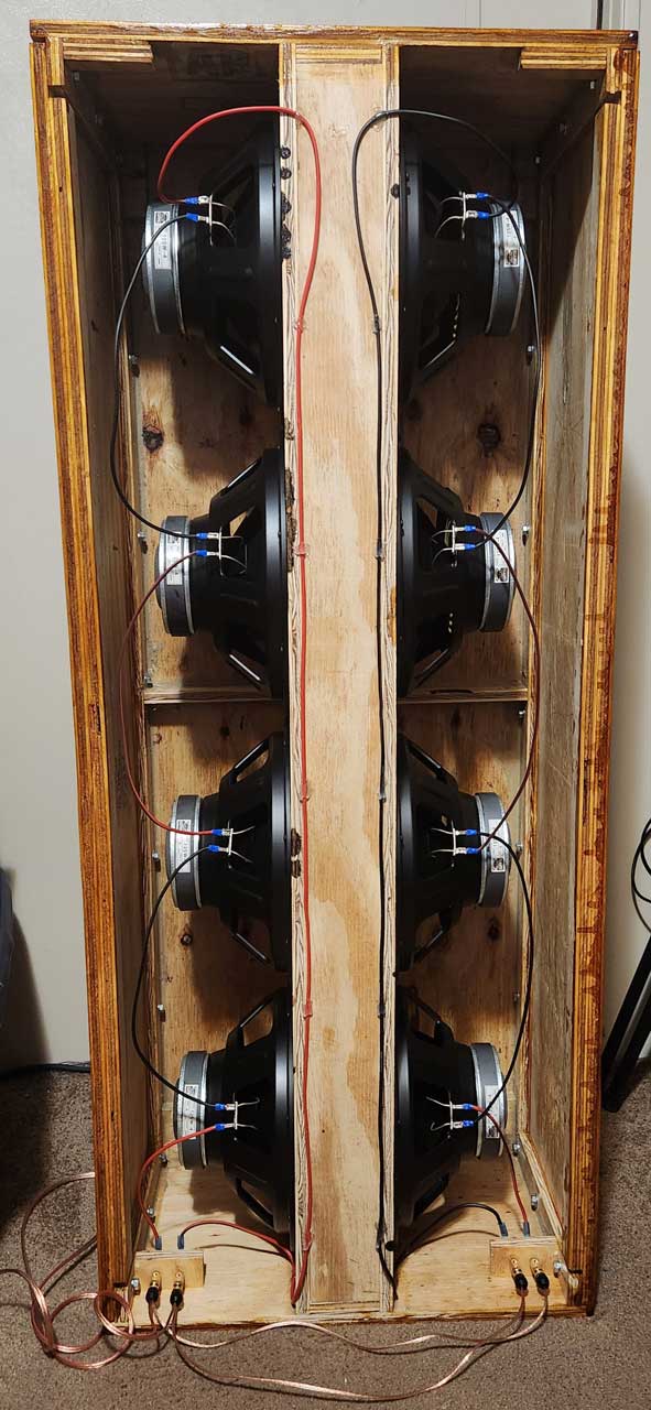

The only thing I would do differently on my 4 x 12" tower above, is I wish I did quad opposed, 2 drivers facing forward, 2 drivers facing rear, in phase, so that the tower wouldn't shake. As it is, when I get those 4 drivers pushing hard into infrasonic, things on top of the tower walk off the side of it. So I have to blue tack everything down on there. It's fine for just listening, but the tower shakes enough to make things walk off the top which is annoying. In an opposed alignment, it would have the same output and all but kill the cabinet vibration.
So I did that on the next sub, dual opposed with 12's. And now I'm doing the 3rd iteration which is an octa-sub with 8 x 12's and they're in quad opposed pairs, so 8 drivers, cone to cone, in phase, to cancel out most of the cabinet/baffle vibrations so that these taller towers on their smaller footprints with mass don't shake.

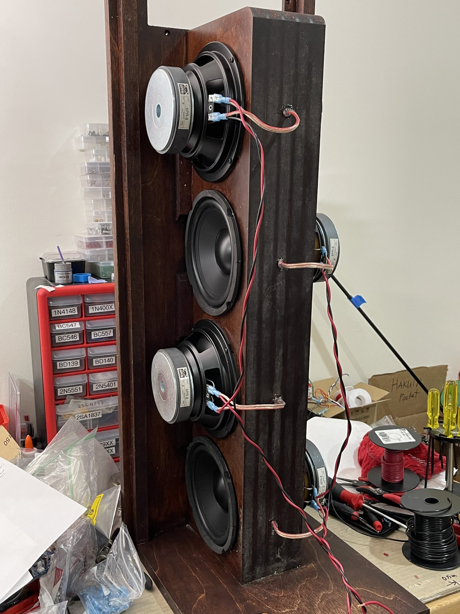

I was planning to do something like this with 4 or 5 pairs of 8" drivers. Bought them but ended up doing something different. Anyone looking for new, in the box
Dayton Audio DS215-8 8" Designer Series Woofers?
I took heavy inspiration from a couple of these SLOB configuration loud speakers, but applied it to a larger open baffle w-frame slot loaded subwoofer in my case using 8 x 12" drivers. I thought about going even bigger on the drivers, but the cavity peak resonance is relative to the cavity side/area, so the frequency was lower and it heavily influences the working bandwidth to keep the peak an octave away from the working bandwidth, so stayed with the 12" driver to keep the cavities small enough to keep the peak resonance frequencies higher in the 200+ hz area, so my working bandwidth can be 10~100hz. With big 15~18" drivers, that drops closer to 100~150zh range and then my working bandwidth is closer to 60~80hz at the top end. And with 18" or larger drivers, it's lower, then I'm looking at 40hz as the highest range which is more like what people do with infinite baffle manifolds.
Very best,

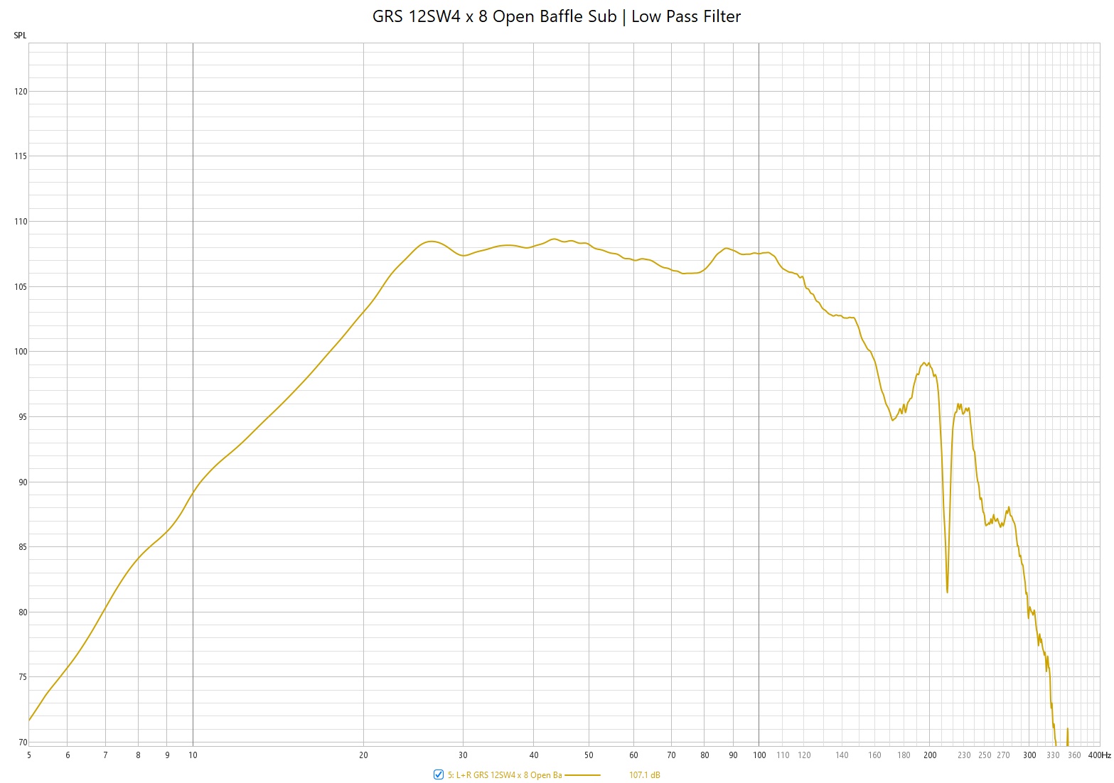

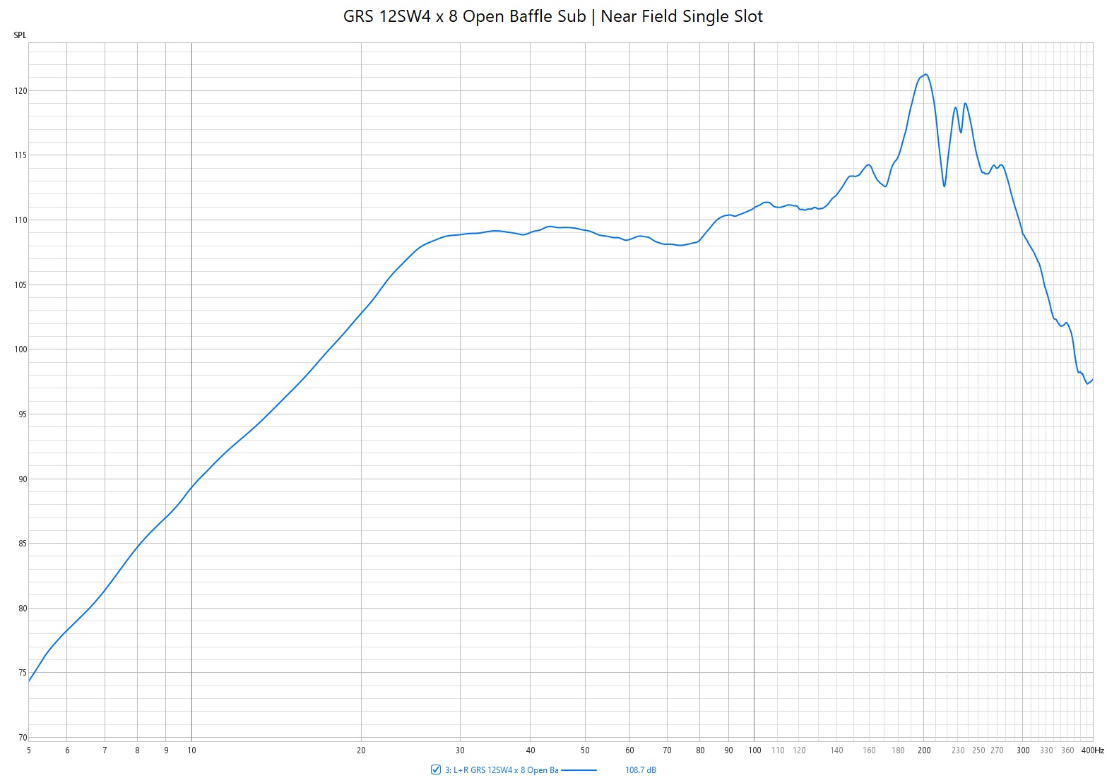

I ended up doing an 8 driver open baffle w-frame sub. It's flat to 27hz then rolls off. This is with 8 x 12" drivers. It's 50" tall, 21" total wide, 12.5" deep. Occupies very little space on the floor. Slot loaded on the front (4 slots).
Natural response with the cavity's peak resonance in the >200hz range. Flat to about 27hz (fundamental A1). Zero EQ here. Zero smoothing.
And here's a low pass filter and a negative notch on 165~240hz range to sink it low. No other EQ or filtering.
The slam is fantastic. Great tactile response.

Very nice! Adjust your low pass and get that 100-110hz region up 3-5db….that’s where your kick drum lives.
Are those measurements free space or up against the wall as pictured?
I’m still working on my stereo pair of 4x12” slot loaded…..should be done by Xmas🤦♂️
That was just a quick sweep and a quick low pass. I just got the drivers installed last night waiting for my power to go out in the storms (Florida). I still have more work to do on it, but wanted to do something other than think about the hurricane and tornadoes.
Those sweeps were near field, near the wall.
I will be doing ground plane measurements soon outside to get a good measurement and will make a build thread about this particular enclosure soon.
