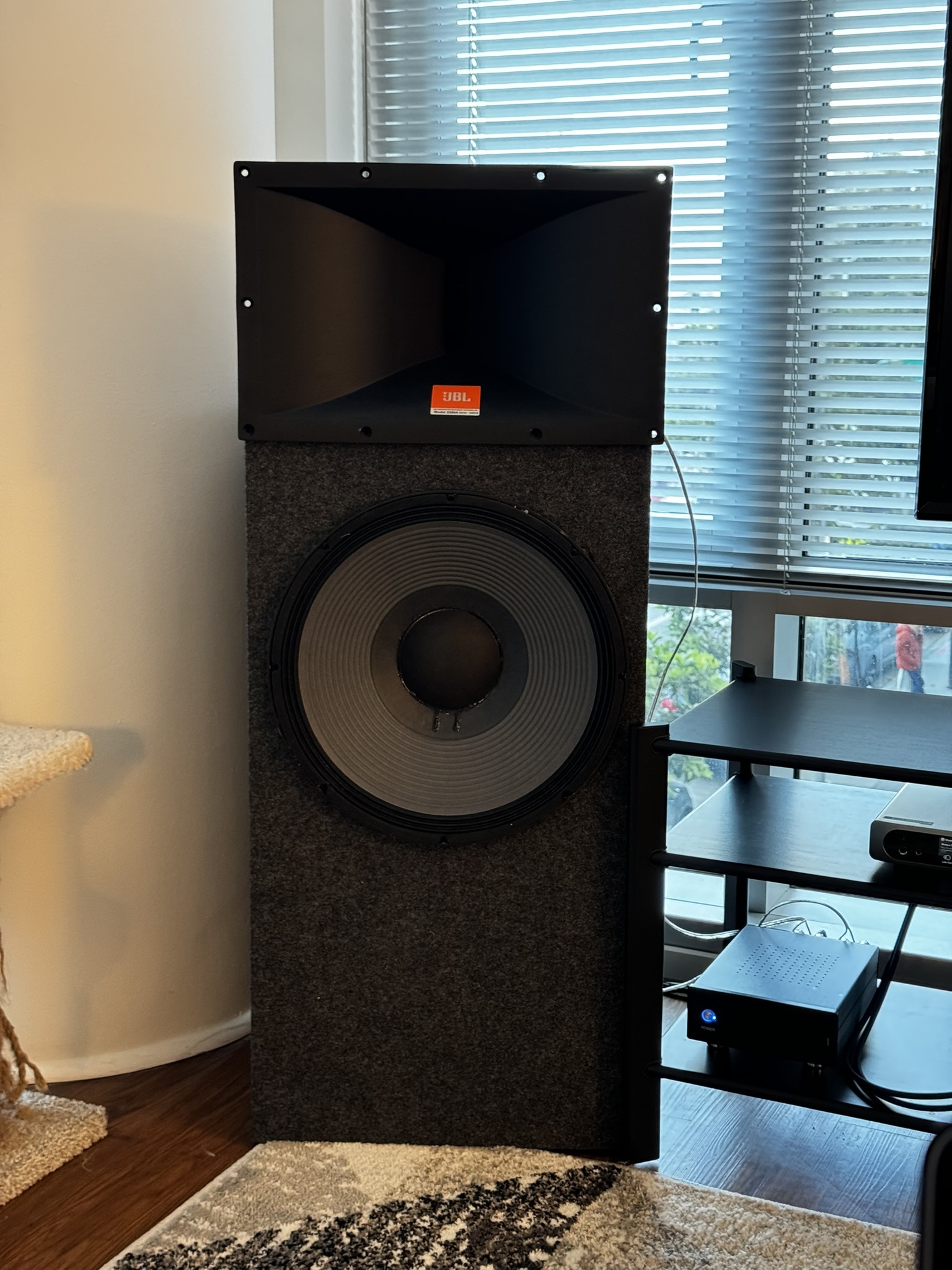

To be fair, you all did an excellent job of trying to talk me out of it:
Found a pair of 2380a horns with 2445J drivers at a price I couldn't pass up. I did some rough measurements in REW and got things sounding acceptable. Still need to take proper measurements and iron a few things out, but the results so far are promising.
Reactions: 3 users
Update: Snagged a pair of freshly reconed JBL 2226H woofers for a song and dance.
The question now is which horn/CD combo will I put on top. ~1000Hz crossover point. Considering:
1.4in: FaitalPro HF146R in LTH142
2in: B&C DE750TN in ME75
Used JBL 2446 in 2380A horn?
I have the HF140 on LTH142 and that combo is about as smooth and low distortion as it gets and goes fairly low 700hz but for my room I like a 90 degree horn.

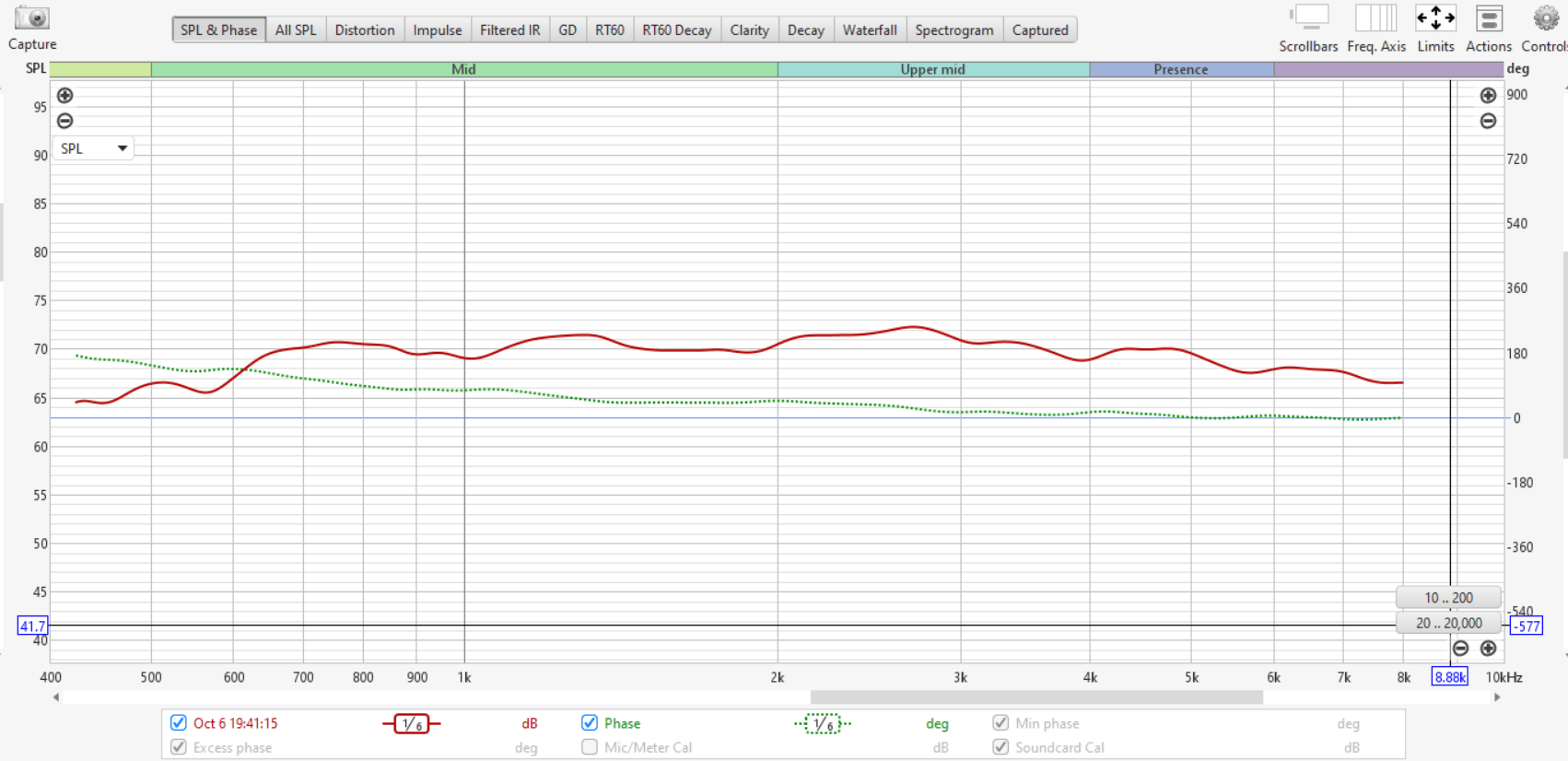

This is a 2440 driver with 2441 diaphragm on a 2380A, I made this measurement about six years ago. No EQ, no crossover - measurement range of 400Hz - 8kHz (No further details)
For EQ in those days I depressed the region between 1 - 3 kHz with a low Q notch filter, and used a mild HF shelf or nothing above 5kHz. Resist the temptation to over EQ. :D
This set up is long gone, replaced with TAD TD-4001 on Yuichi A-290 clone.
Some room treatment recommended even with the 2380A, check out absorber/diffusers from acoustimac. Frame them and WAF might be acceptable.
I use DSP for everything. (XO, delays, and EQ)
