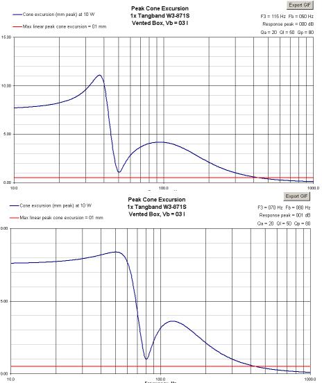

Almost any music material has really significant output in the 40/45-70 Hz region. Since designing speakers is about trade-offs, I propose to tune such drivers in the 50-60 Hz region to exploit the fact that in the system tuning frequency (and nearby) the needed excursion significantly decreases, and then find ways to strengthen the output in the upper bass (placing speakers near walls, using a somewhat bigger enclosure). The trick seems to work nice with these tangbands, and even a small level recession in the lows is sonically accepted since it is counterbalanced with its High-frequency power response roll-off -and also because of psychological reasons (knowing that the speaker is really small
). You can’t have everything with a tiny fullrange driver, neither are such designs proposed for a big room’s free space great system or for producing some T-Rex footprints or an Organ’s lower registers, but you can have really acceptable, enjoyable and musical performance in normal listening levels, with a cunning placement.
Dear Destroyer, if you high pass them in 150 Hz you don’t get rid of excursion limitations regarding the next lower octave (75 to 150 Hz) in your alignment, but mostly regarding excursions in the 40-75 Hz region, as can be seen in the attached picture (together with the behavior of a 50 Hz tuning –the upper curve- which is a much better compromise – 10 Watts for each). It is there were your speaker bottoms with power given.
Last, I believe this discussion is not about “how to best use these tangbands in an open design”, since then I would answer “20 together as mid drivers in a 3 or even 4-way array”, but rather “how to produce a neat, enjoyable little speaker with this driver – is it possible?”. I answer to this: Yes it is;-)

I got my two W3-871S drivers. They are really beautifull. Now they only thing I have to do is to get them sound as beautifull as they look like. I've been simulating with winISD and I was wondering what would be a good enclosure.
The yellow line is a closed one. The 2 grey lines are BR. The cone excursion are almost the same of all enclosures. There is only a great differents between the group delays of all three. At 80hz the light grey line has a group delay of 4.3mm and the dark grey has one of 8.3mm. What would you think is the best enclosure for this speaker or could I better build something totally different like a dipole or so?
PS: I want to use only two drivers.

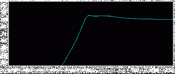

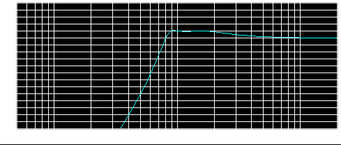

The following curve is for 3.6lt including allowance for speaker and tube volume. Use wool felt pads all around and a little foam on the back.
Its based on experimental data for the 871. It is calculated for one driver per cabinet. Dont use BSC if you adopt this alignment.
Also when you place it on your desktop know that the 200-300Hz region is going to develop a +5 dB bump. Cut this on your player EQ. You might need to boost 5-9kHz by 1 dB also.
The tube is 40mm total diam. and 70mm long.
