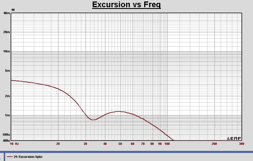

in the attachment an outline (based on the MJK allignement tables) of a 60Hz tuned desktop TL for the W3-871. place the driver somewhere in the area of the text, a bit lower maybe? use a fair amount of stuffing in the closed end, and a little in the open end (experiment with this to suite yr taste)
