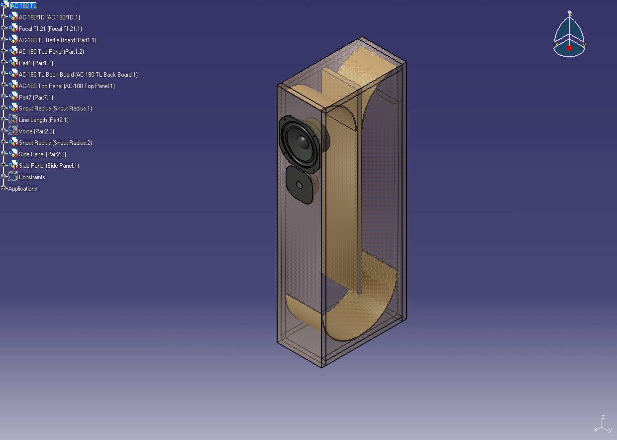

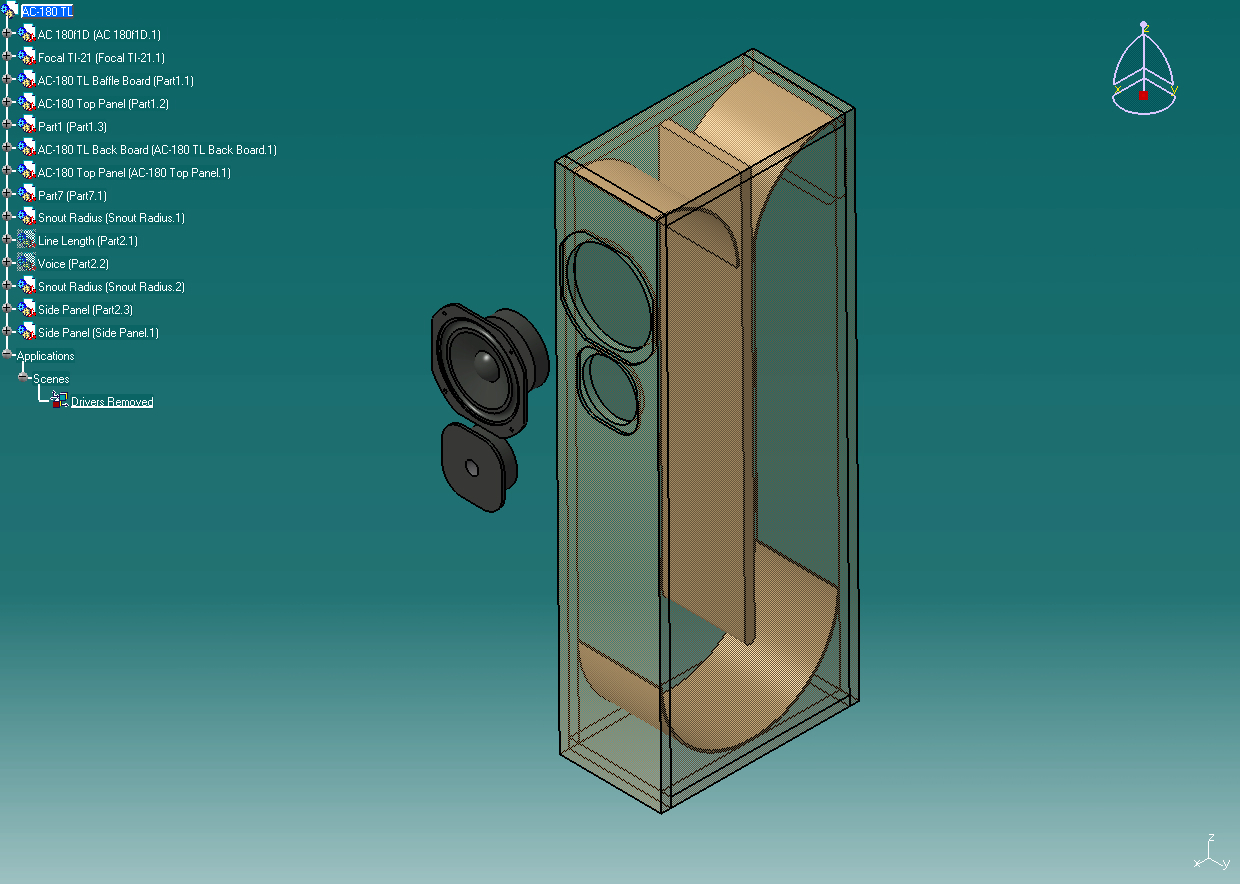

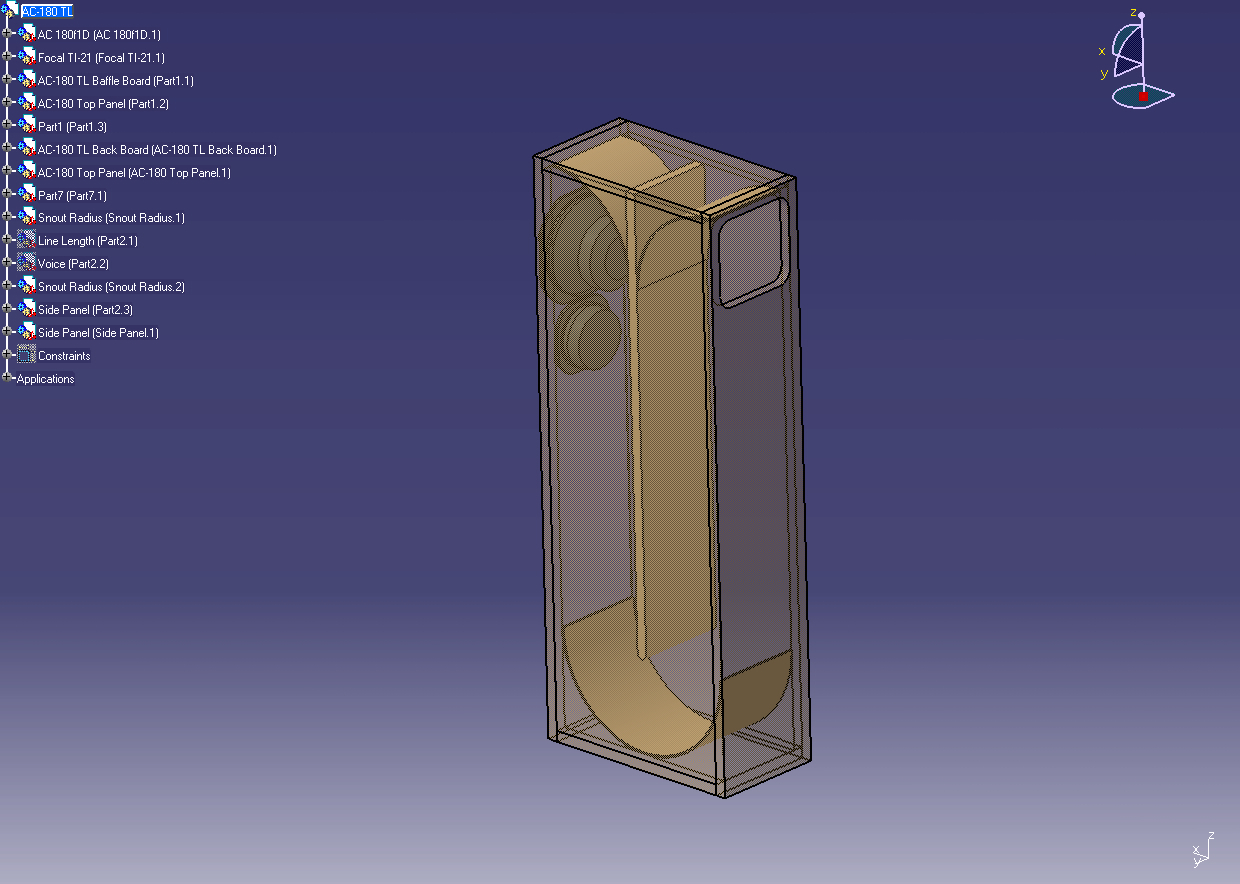

I put this model together this weekend for a TL based on an AC-180F1D and a Focal TI-121. I already own the drivers from other projects. The AC driver is a dual voice coil and the fs is about 37hz. I thought I would try something I read about years ago written by one of the Focal engineers in Speaker Builder (I forget which issue) where a DV driver is utilized in a 2-way driver set-up, however, one of the voice coils is connected to the band pass section of a 3-way crossover and utilized as a midrange. This has always sparked my interest so it thought I would take a swing at it for fun. If I can’t make it work I can always wire it in a 2-way configuration. If any of you have experience with this, or the box design for that matter, feel free to chime in. The TL itself I designed based on material I have researched from M. King and also calculators from various web sights and software modeling. The cab is 40 inches tall, 8 inches wide and 15 inches deep (exterior dim). The line length is about 67 inches and is a constant cross section area close to driver cone area
Yes, I'm also curious. Is that a simulation program with CAD capability? It looks great. The only program I was aware of designed for TL modeling is the one by George Augspurger.

I model in Catia. I have been a mechanical design engineer for many years. The audio portion of the design process takes place separate from the CAD modeling. Catia and SolidWorks are a huge help when doing complex loudspeaker box design. You can overcome many fit and finish issues before you ever cut material and also correct miscalculations in the fundamental design itself. For instance, when I did the first hand sketch based on the audio software calcs with dimensions, the line length hand calc was 67 inches. Once I modeled the box in Catia based on those calcs, the “Effective” line length was actually 83 inches. So, I made the correction and the box goy much smaller. The box looked much more in proportion to what others had done based on the MJK data as well.

For the last couple of evenings I have been sorting through the MJK derivations trying to solve an issue with this particular DVC driver. For some reason, when I do the hand calcs for a TL utilizing the AC-180F1D, the enclosure gets unusually large in both cross sectional area and line length. So far, it looks like I have isolated it to the driver BL factor but more analysis is needed on my part. The BL on this driver is listed @ 3.3 (no units given) which seems low (about 1/3) relative to other drivers I have modeled. I have not measured the driver. I will do this right after Christmas when I have them broken in. There is also the possibility of a mathematical error on my part, however, when I run other drivers parameters with hand calcs everything seems reasonable.
