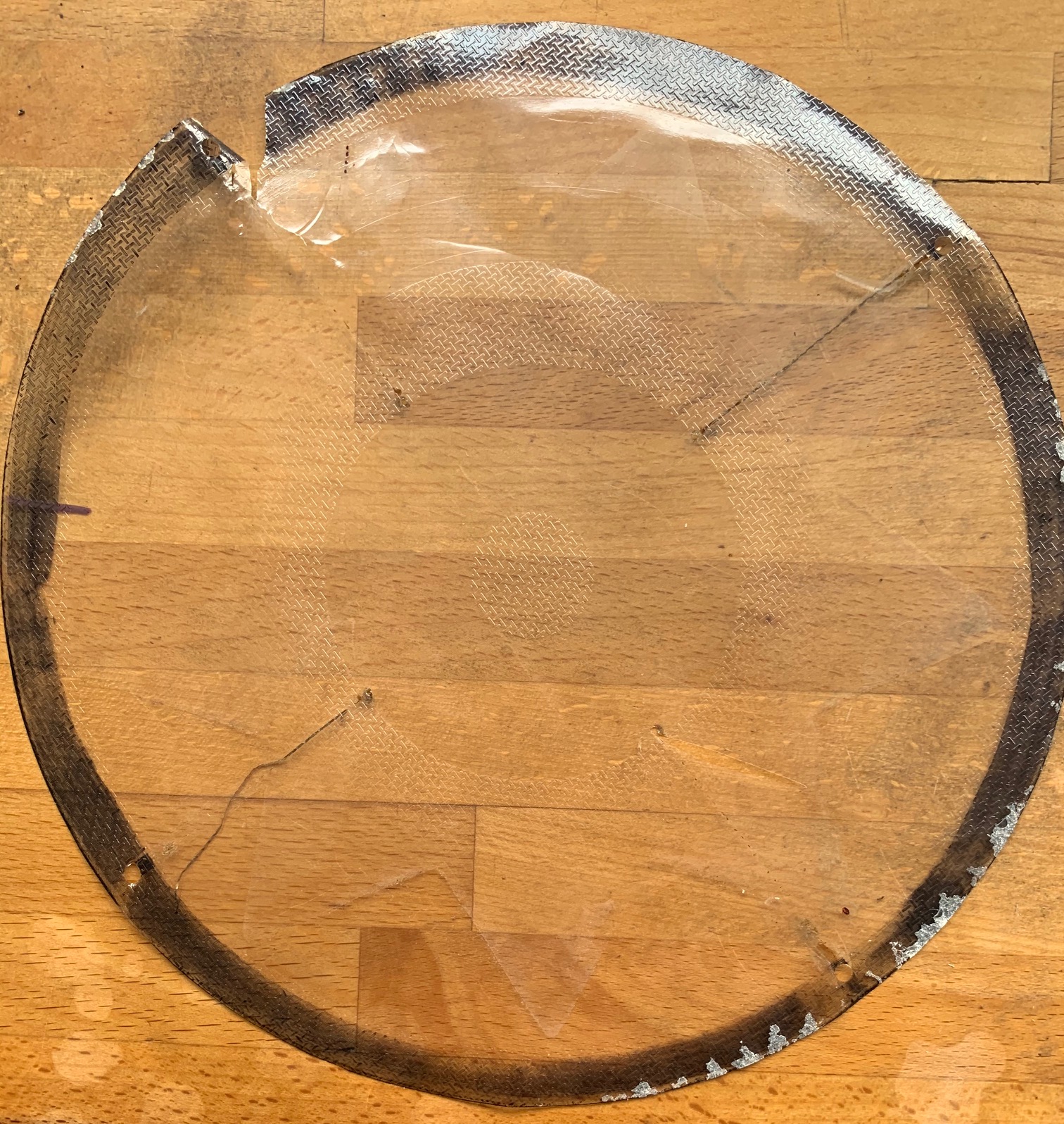

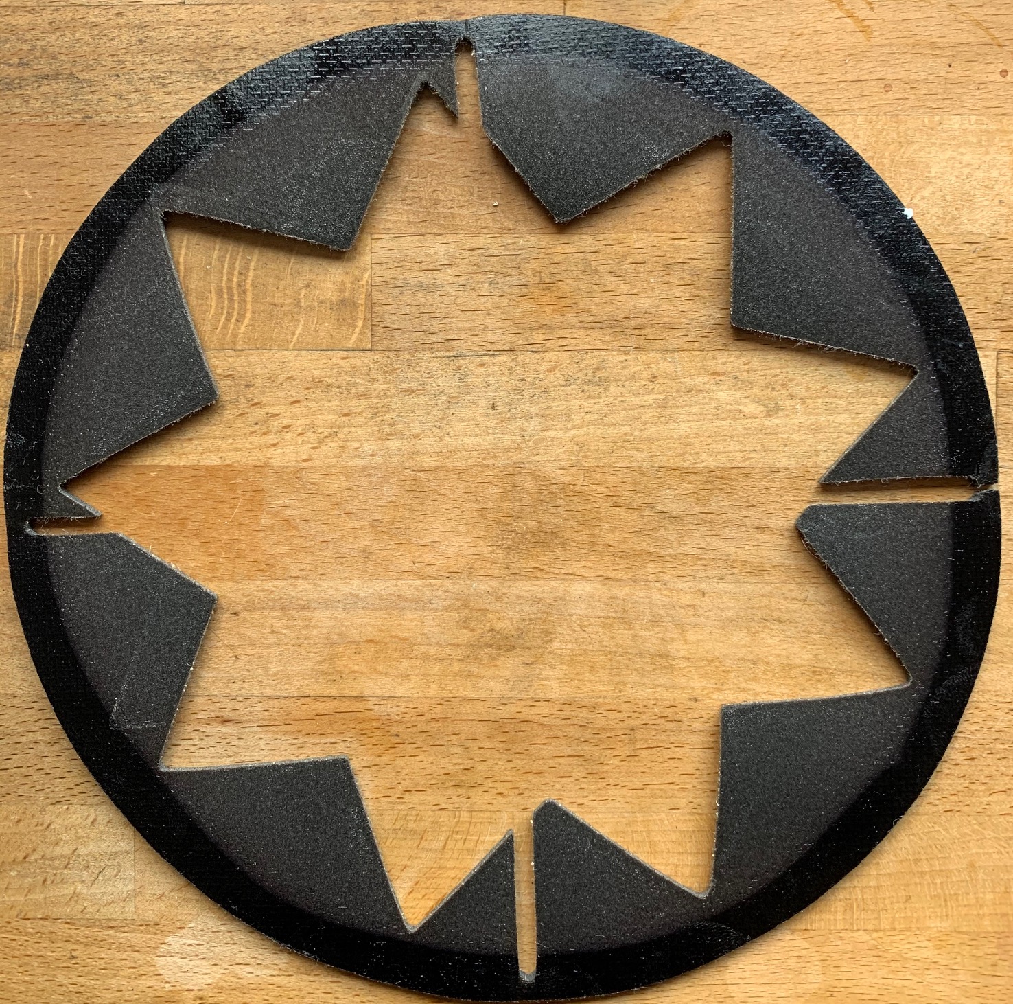

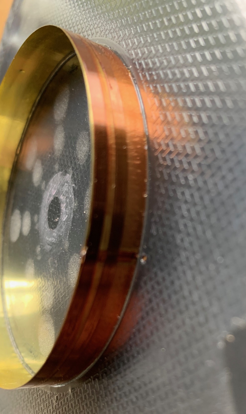

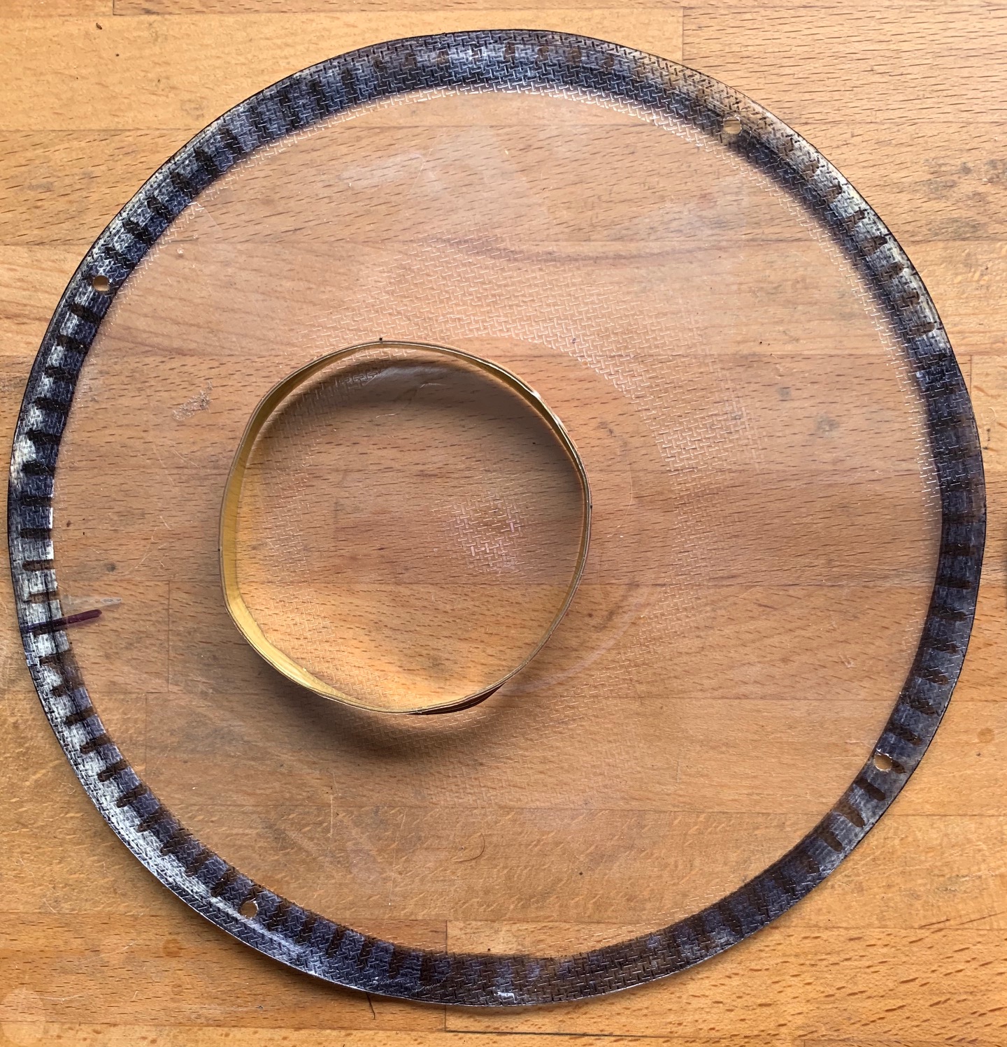

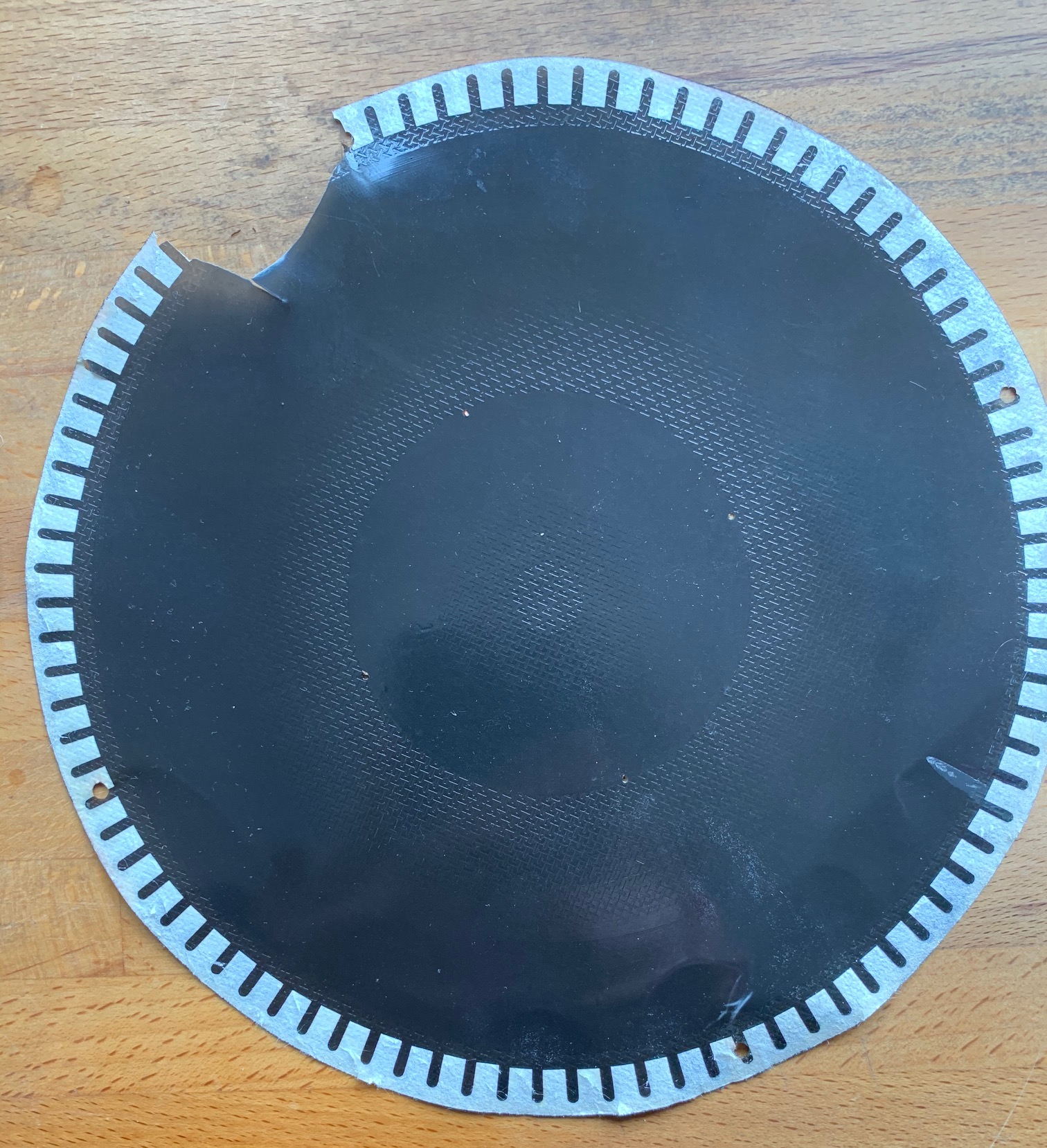

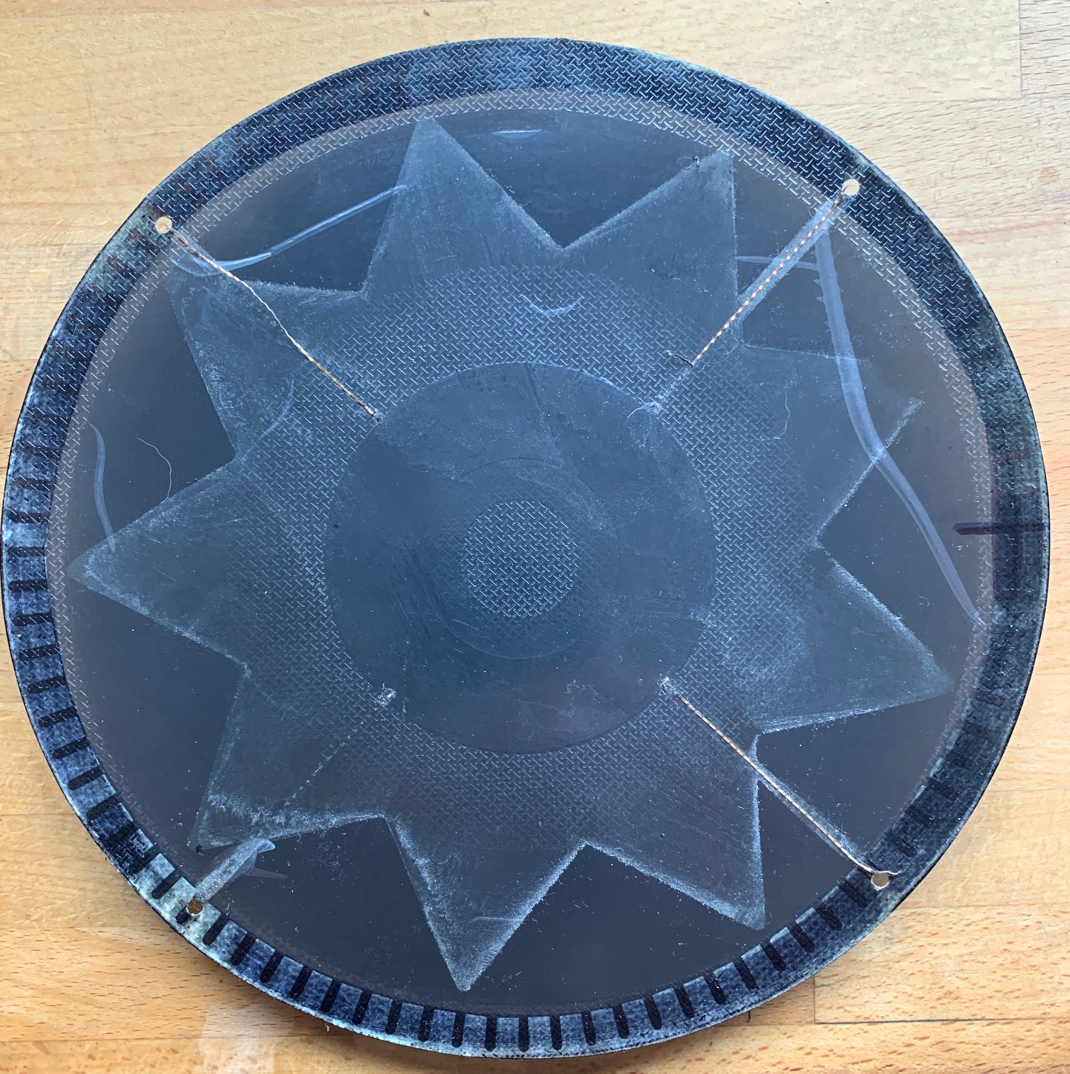

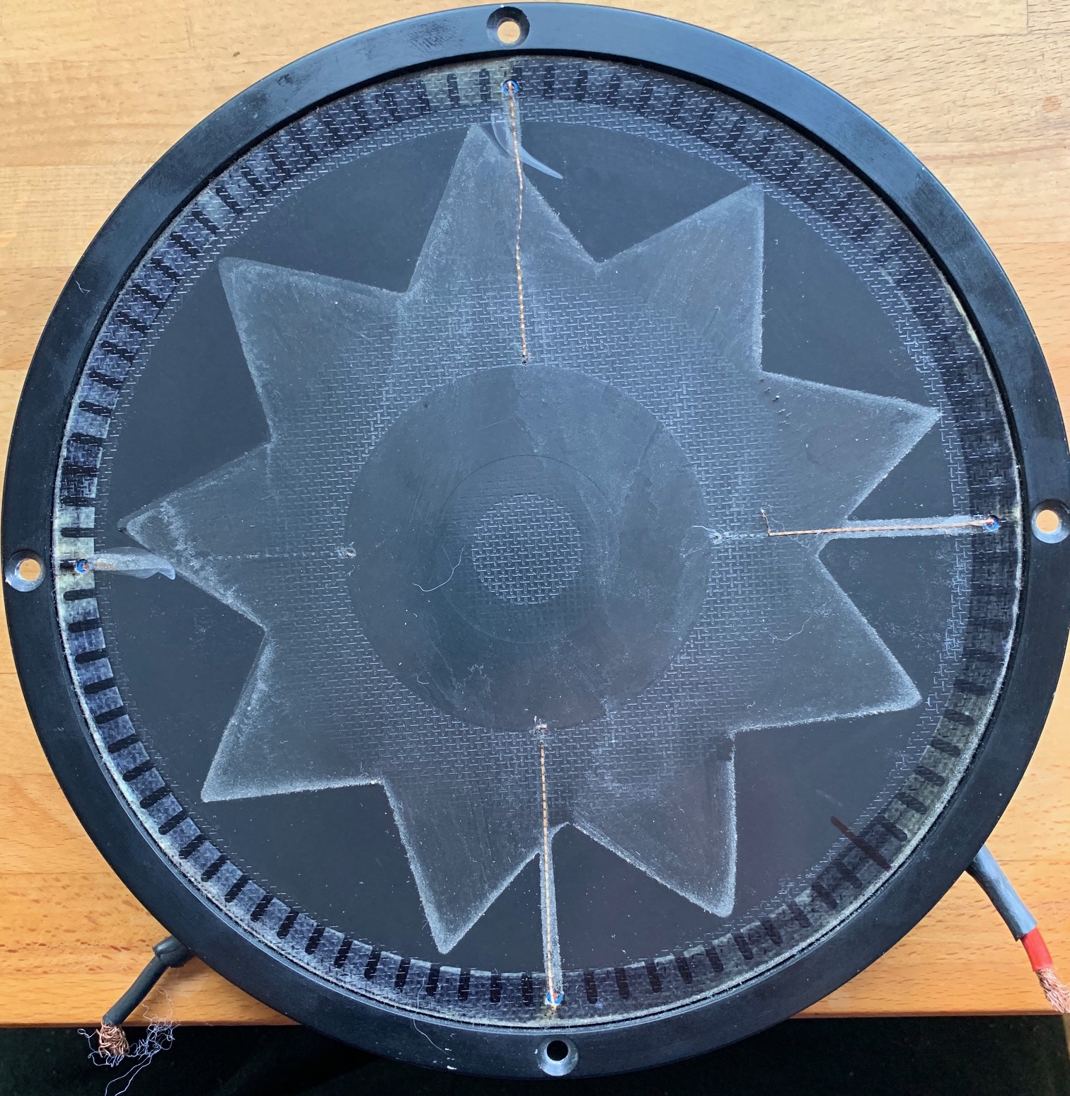

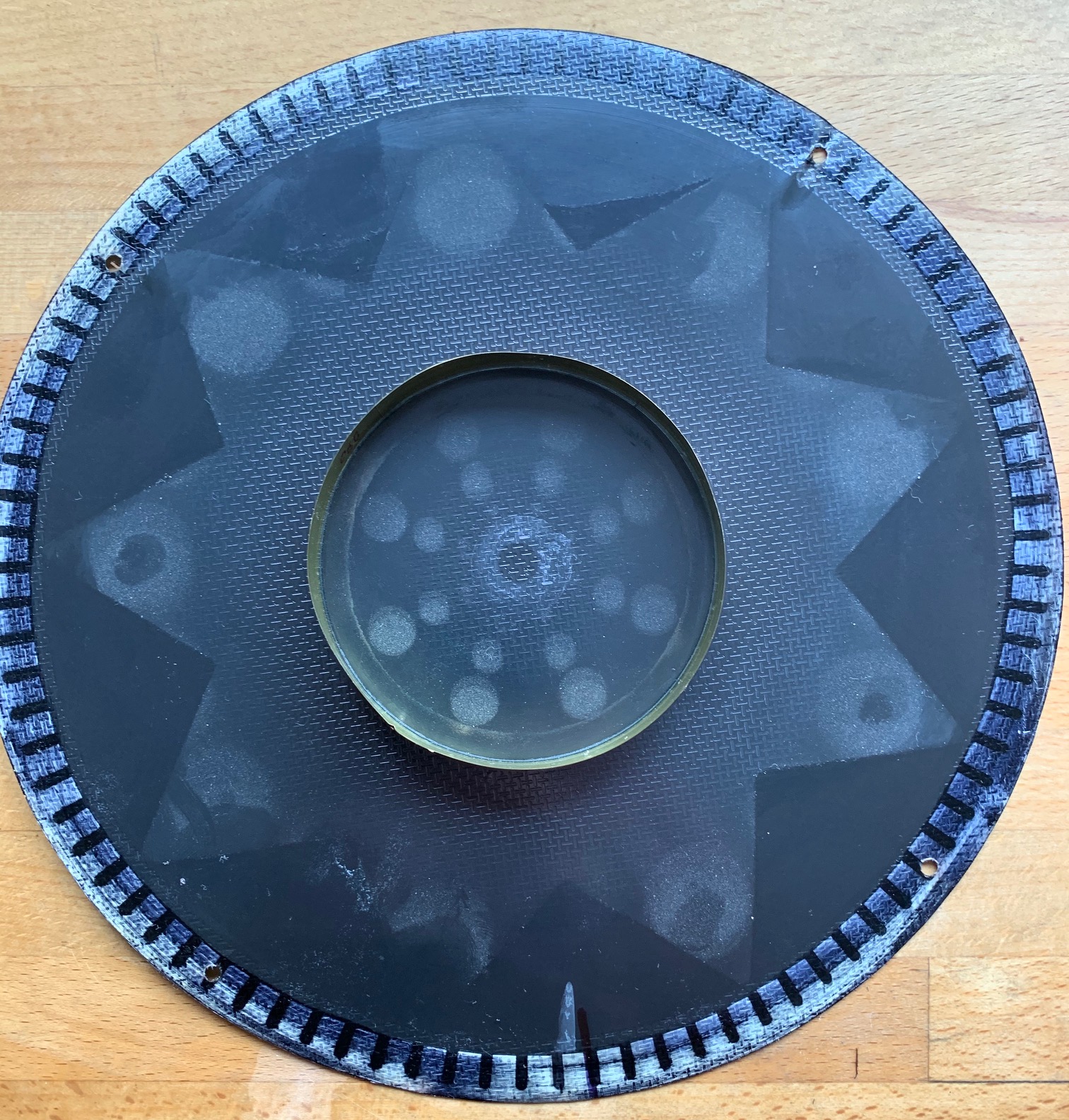

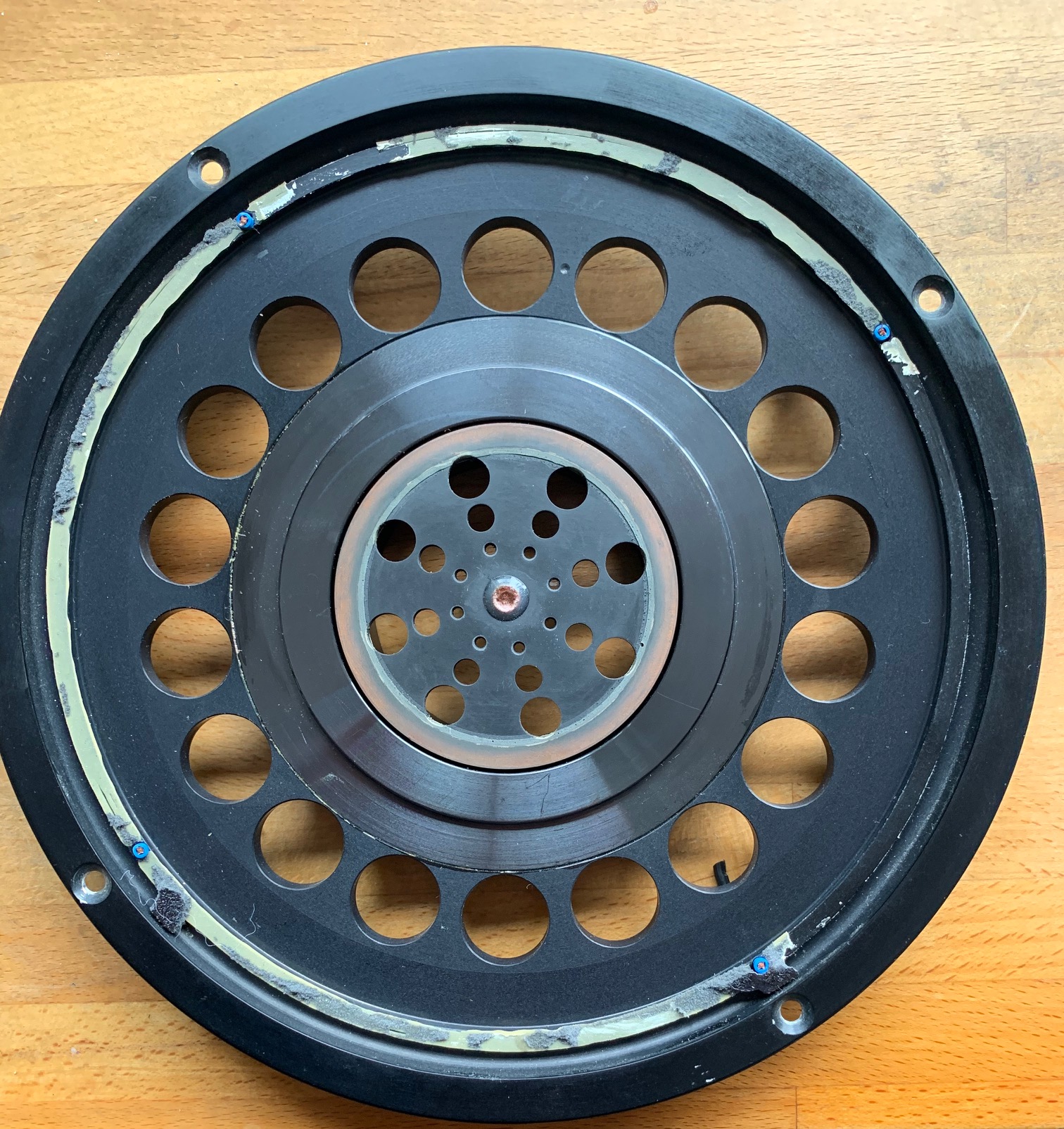

Recently bought a pair of broken Manger MSW's and before I send them off to Manger to get them refurbished I thought it would be nice to take it apart.
First took the starformed damping off, then the complete membrane, underneath it was another damping, slightly thinner.
The membrane is made of 3 layers, 2 thin one's and a thicker one.
Do understand why it's costly to make such drivers.

The coil is patented. Half mass and double throw. There is always the equivalent of one winding in the gap. In the middle position there is half of each coil in the gap.

hello, the weight of the membrane would be interesting? would also like to see a picture where the membrane hangs down in the middle from the tip of a pencil. In the mango project, a beginner works. Thanks and regards
Hi Peril,
all the stuff is in the trashcan, it is quite sloppy otherwise you wouldn't get the " stone in the water " ripples.
The baskets have been packed and will be shipped to Manger for full refurbishment.
