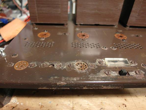

Colour: One thing that bothers me about these Citation amps is the colour of the transformers. It's a subtle difference but it's not quite the same classier looking 'charcoal brown' as the chassis. It's slightly lighter and rustier; it looks more like a chocolate bar. I'd like to nail the chassis brown colour and match the transformers to that. I've even considered painting the transformers black, which would greatly appeal to me, but of course vintage purists would object to that.
..Todd
Good luck with your project. I have a Citation V I rebuilt 25 years ago. I would like to rebuild it again with modern caps and a CCS in the tail of the LTP. I have the manual but am south for the winter and won't be home for another 8 weeks. I think you will have to completely strip your chassis and maybe powder coat it; those corrosion pits look bad.
Surprise (not), Jim McShane can tell you what automotive painting supplies to buy. 😉 Remember, Jim's "day job" is in the automotive industry.
If, as I think, you have rust on the lam stacks, buy a firm brand X toothbrush and gently knock loose rust off. Follow with a rust conversion conversion product, like Duro Xtend, and then paint. You, most definitely, do not want to remove any OEM lacquer or oxide from the laminations. JMO, black lam stacks would be OK with chocolate brown elsewhere.

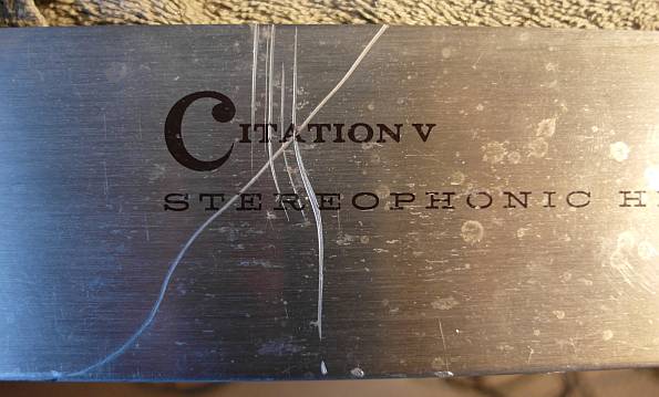

Here's a pic of the nasty faceplate scratches. I could certainly sand them out, but I'd loose all the silkscreened graphics. I have recreated all the graphics in vector format in case I need to re-apply them to a refinished faceplate somehow, but I don't really know how I'd do that. Waterslide decals again maybe.
Or maybe I can fill/hide the scratches somehow. Ideas welcome.

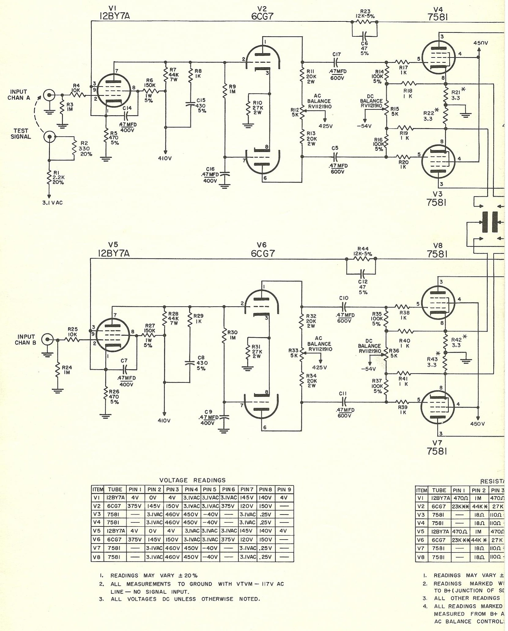

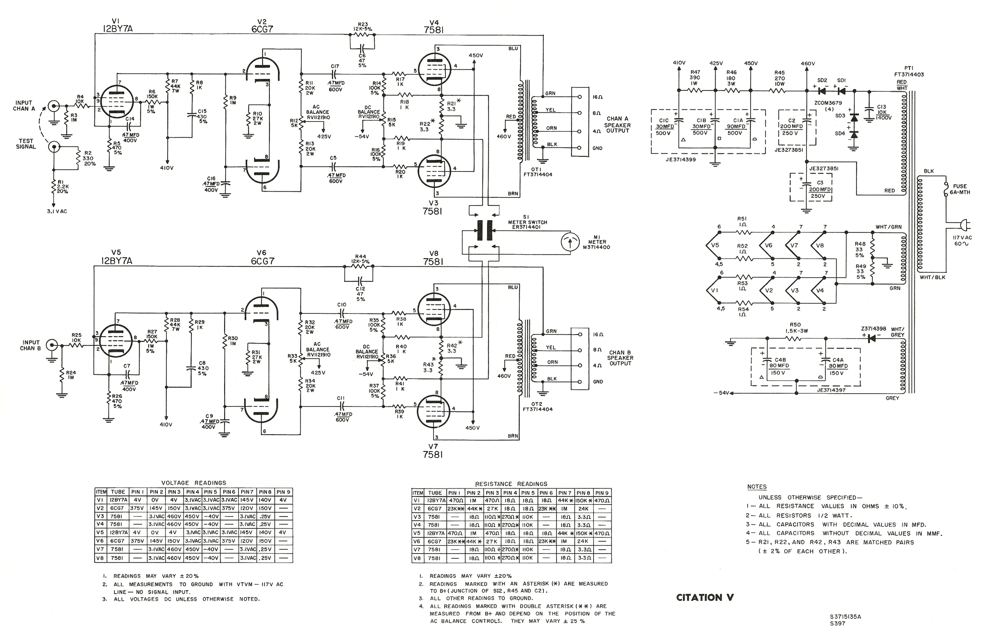

And of course I've drawn my own schematic at some point in the past (2011 apparently) as I am prone to do. I found it on a different forum but it probably came from here originally. I'll add it here for posterity(attached).
..Todd

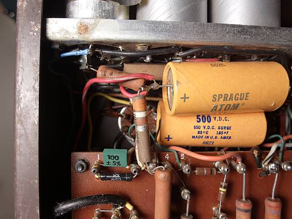

Today's update: I've found that the original 90+30+30uF multi-can cap (for the screen and upstream nodes) was replaced with a 60+40uF can paralleled together for the screen supply, and a pair of 20uF Sprague Atoms were bodged in for the upstream nodes. The date code on the replacement caps is 1966, so that was an old repair.
Sams photofacts uses different identifiers for C1 and C3. They are reversed from HK's schematic. Not sure yet if that's just an error, or if they went their own direction with many of those.

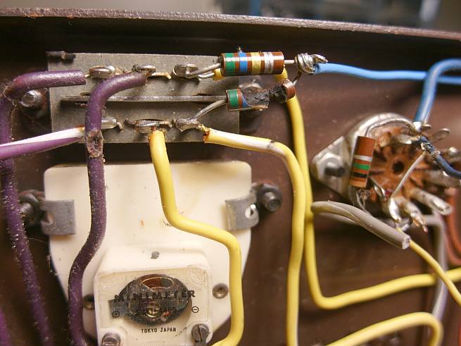

Well, here's an interesting bodge. These 5.6 ohm resistors are essentially connected between the 2 output tube cathodes with their center tap (light blue wire) connected to power ground, but only on 1 channel. It looks like this solution successfully released some of the smoke. :scratch:
I don't think I'll keep this mod. 🙄

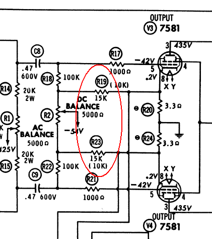

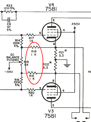

The Sams schematic uses different identifiers for everything. There are more differences in the schematics...
The HK schematic shows 1K resistors for R18/R19 between the output tube cathodes and bias control. The Sams schematic shows 15k and (10k). This amp has 10k resistors installed there.
(I'm not sure what those resistors are for...) :scratch1:
..Todd

So here's the question on my mind: why was this amp originally built with 10k resistors in this spot (and they do look original.). Its unlikely the kit builder followed the Sams docs initially or used parts other than the ones that came with the kit. It makes me wonder if there's another rev of the HK schematic floating around.
Can one of the resident engineers here say what these resistors are for? A local feedback loop? Sending some -vbias to the cathode for some reason? Or just a final tweak of the bias voltage?
