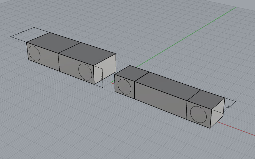

I want to build a speaker to stream music by bluetooth or by 1/8 jack input, something more than a boombox.
My initial tough was to use two tb w4-1337 and one tb w5-1138SMF for the sub, both in BR setup, for the amp a tpa3116 2.1 and a sure 4.0 bluetooth board, everything fitted inside a box of birch plywood.
Then i came out with the idea to turn back to a more simple setup with two w5-1611 in BR with tpa3116 amp and the bluetooth board, saving some money for a chinese tube preamp maybe...
Which solution do you think is better? Is it more "audiophile" to not have a sub? Or is better to let the sub take care of the lowest extension?
I've attached a rapid simulation of the two cabinets versions... the w5 request more volume...
Thanks for the help 🙂

So i should add a low frequencies filter for the fullrange speakers, or understand how low they go and set the sub accordingly? sorry but i am a newbie...
Maybe a 2.0 system for a first build is more easy to build, even if the volume in BR is quite bigger
Your idea with the w5-1611 looks good.

Yes, a high-pass filter is required but it still might be tricky to blend the speakers properly. You would need a measurement mic for this. 2.0 will be much easier to build. What kind of enclosure volume are planning to use for 5" speakers?
Thanks Mike for the useful link, i'll take in consideration the chr 70 too
@Theaspin for now i've only taken for granted the parts express suggested 0.44 ft.³ for BR
i've to put data in unibox and try some simulations.
