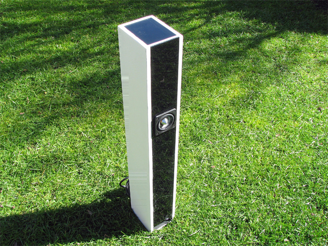

Just finished the speaker for Tang Band 2 inch driver. Price and size taken into consideration this is very nice - as long as you keep the volume at moderate level. Increasing the bass a little on the PC EQ makes this speaker a really good solution - e.g. like a PC speaker.
Admitet - this is more Fun Fi than Hi Fi, but anyway 🙂
The front is black acrylic and the top is black glass.
Take a look at the instructions and more pictures here.

Yes, they do look nice.
My next project is TABAQ with 4" TB with more glass and no acrylic. The local glass shop can glue the glass and drill holes.
