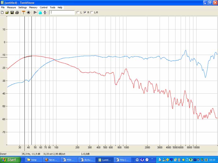

First of all, i dont have much experiance of measuring speakers
but i did an very basic try.
Im using an uncalibrated Panasonic WM-61A with my computer
and an StValue 24bit soundcard(Envy24 chip).
Software Tombstone running an sweep 20-20khz with
W4-1320SAwith BSC 0,8mH+3,9ohm.
First one is with modded T-amp.
Red line is port.
Red line is port.

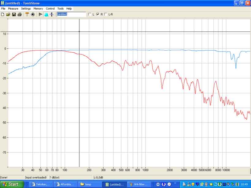

Measurements
Solve,
In your first measurement with T-amp, there is a message at the left bottom corner of the screen: "Input overloaded". That's, probably, what is responsible for a ruller-flat curve at 0dB. Your later data do not have this message, so they are much more realistic. If the first one was a near-field measurement, just lower the volume until the curve is lower than 0dB and has some wiggles. You can only trust near-field up to, maybe, 1kHz at the most. Also, if you want to add this data to the port output, do not forget to scale the port data by the ratio of port diamenter to driver diameter squared. Than you can splice that to the 1 meter data. Still, this will not account for difraction effects (baffle step).
The single best book on how to measure speakers properly is Joe DiAppolito's "Testing Loudspeakers", available from Audio Express.
VadimB
Solve,
VadimB

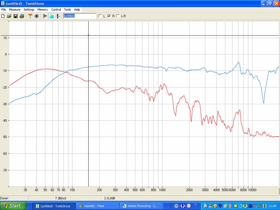

You have an good eye VadimB!
Didnt see that.In tombstone you get an pop up screen that say the same so i trusted that...
But you are right, it was to good!
Now we see that ugly 7khz peak.
How do i notch that?
"Also, if you want to add this data to the port output, do not forget to scale the port data by the ratio of port diamenter to driver diameter squared."
How do i do that?
Now i just moved the mic without changing the volume.
Think i have to get that book.
Solve
How do i do that?
Solve
