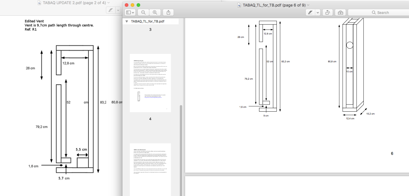

I don't know where you saw that the CSA is different. The only changes between the original and the updated is the vent length. The updated more suited to 3" drivers, and the original, more for 4" drivers.
In post 2838, Bjørn said:
Maybe I misinterpreted what the line actually means.
For the 4" version the line lenght is the same, it is the cross section of the line that has been increased (larger volume).
I think Bjorn might have been drinking some good wine that night! 😀
Pull out the original TABAQ pdf, and the TABAQ Update 2 pdf, and you will see that both dimensions are the same, being 10x12.8cm, or 128cm2.
The only difference is the way the vent is configured. a bit shorter for 3" drivers, a bit longer for 4" drivers.

Thanks. I really do appreciate the assistance. Recently, others have pointed out that original vent is a different shape than the updated shorter vent. The start of the original vent is 3.8cm and then tapers to 1.6cm. Understandably, errors have occurred before and I am left to wonder if that is correct or not.
I'm not trying to be a pain. But I am trying to get rock solid information. I would really like to build this very cool speaker, though I can't afford to do it multiple times.
The start of the original vent is 3.8cm and then tapers to 1.6 .......
Sorry, but I have no idea where you picked up that the vent tapers.
Rock solid info? Very easy.
Get the pdf, read that, build it. Solid.

By the way about the start of the port in the original Tabaq I was the one bring out on post #2841 that is 38mm and not 16mm, this because some members made a wrong calculation of it, but if you look the original design by Bjorn there was no mistake at all.....all the best
Irishpatrick – we would like you to also experience TABAQ magic by building a set using the correct plans. Hopefully kissabout brought you some clarity. Forget about tapered ports, and yes, there are small differences, but they don't seem to make much difference to the magic.
Your Visaton FRS 8 M drivers are 3.3”, have 125Hz Fs and 0.49 Qts. So, you should use any of the plans for 3” drivers. Please go and check these posts again:
#1501 – Bjorn’s updated plan for 3” drivers (Use the plan on page 2 of 4, and delete page 4)

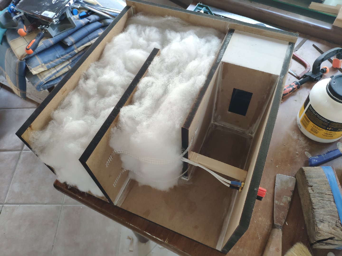

I have tried with Ikea cheapest pillow materials and some monacor stuff. In both cases 110g to my taste is too much. Material is polypropylene in both. In two folded Tabaq variations (with PS95-8 and RS100-8, 4 total possible combinations) I think smth 40-80g range for PS95 and 60-100g for RS100 is ok, but my versions are not pure Tabaq anymore, as they are folded in different ways and I have made a hole for variable vent length - it is just simple pvc pipe of ~36mm inner, 40mm outer diameter.
By stuffing more the sound will be more mellow, but you will lose more details. By combining with variable vent lenght the variants are pretty limitless, as the change of 1cm of vent lenght is audible AND this also requires to readjust stuffing.
If I start this build now the first thing I would buy variable vent tubes of similar cross section as the variations affect the sound even more than different stuffing amount.
EDIT: the vents could be a little smaller, ~1/4 to 1/3 of speaker cone area is ok for normal listening levels of 3' or 4' speakers
Thanks for the info. Just curious how do you evenly distribute stuffing in the top 3/4 of the chamber? With 110g, I can barely fill it up to the top. I assume having 40g, it will only fill up to the middle leaving the top half of the speaker empty.

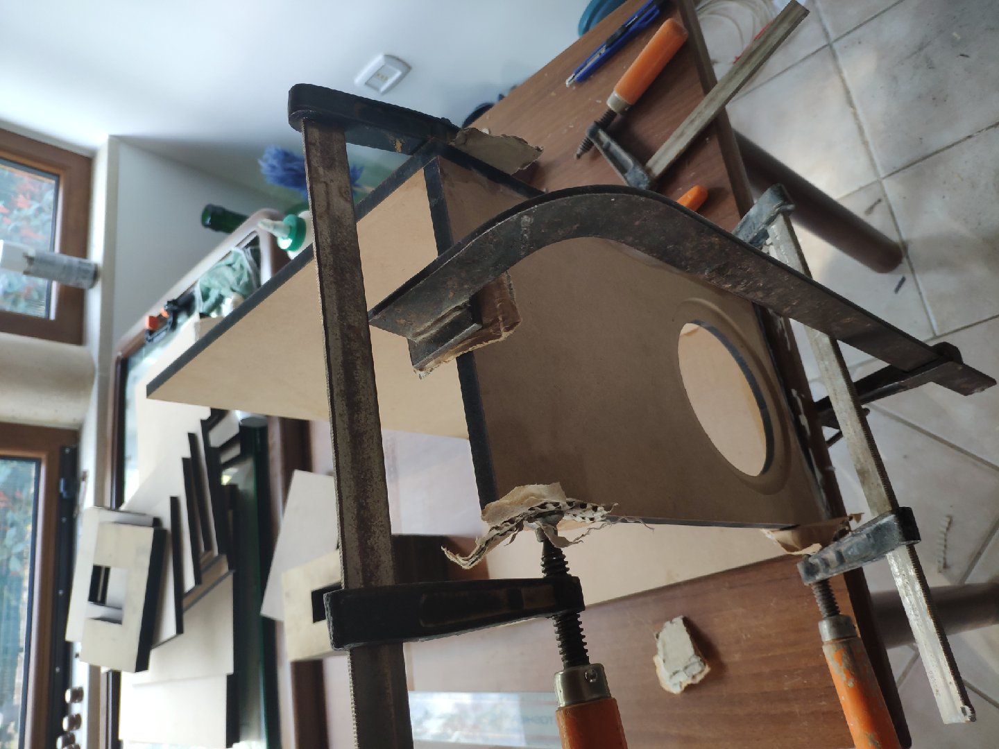

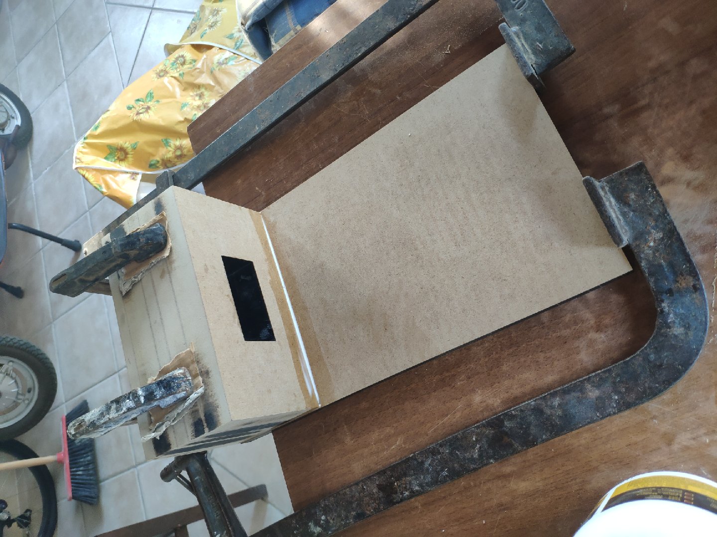

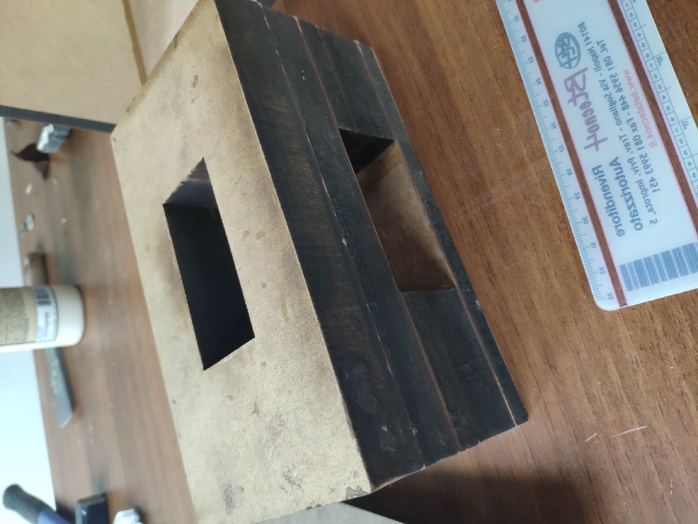

Finally, after a long way, I finished my first build. I have to say I'm amazed by the sound, although it's my first time with a full-range too and I can't be objective.
I think that the W5-2143 are a good match for the TPA3251. And what a bass 😀
