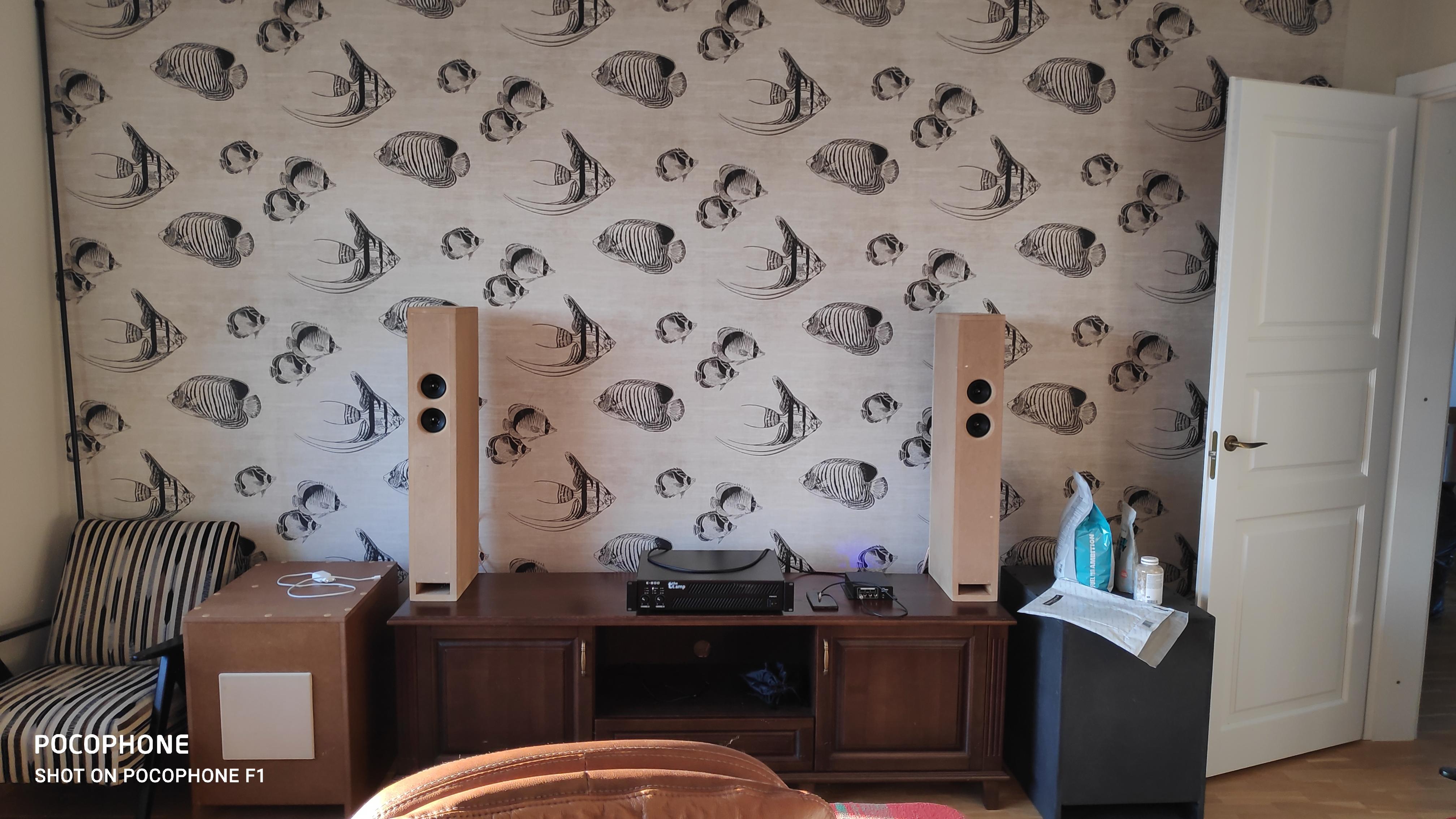

So this is what I did. 2x2 Visaton FRS8-M in a TABAQ. I had some issues with my DSP and after fixes these sound amazing! both in loudness and detail (for me). There are some songs that has too low frequencies, but most of them sound with full of bass. First of all I tested with original TABAQ and 1 speaker and I was astonished by the sound. Four of them in a x2 configuration is a different beast.
Enclosure SD is around ~256cm2 and port 32cm2 with a length of 8.5cm. If i could i would defintely go with a length of 6.5-7.5cm that would give a little bit of punch instead of the lower FS (i think so?).
They only played for an hour, but i think after some playing time they should sound even better.
