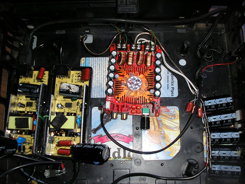

I am want give a try to this cheap amp New TDA7498E 2 160W Dual Channel Audio Stereo Power Digital Amplifier Board E6P5 | eBay

Nice PCB there, I'd expect it to sound quite good out of the box. Good find!
Sanwu and well regarded to (the name on the PCB).
I'd give it a try yes.
