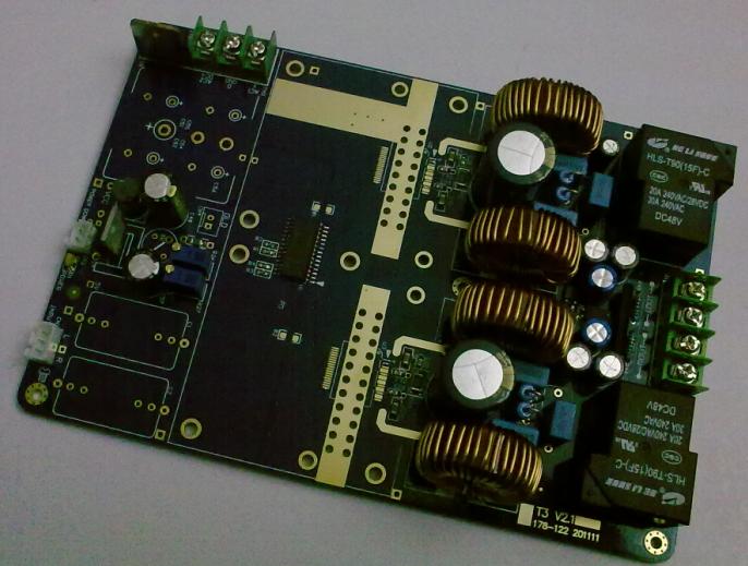

Luckily I have one board lying on my desk right now 🙂
The size is 123x178x37 (width x length x heigth in millimeter)

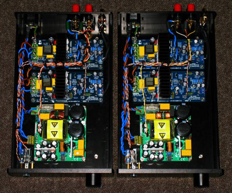

Sonically, the Hifimediy-T3S is a disappointment for me. The sound is too technical and unnatural. The Hifimediy-T2 sounds much better.
A Hifimediy T2-amp also costs significantly less than a Hifimediy T3S-amp.
If the performance of a Hifimediy T3S is required, then I recommend for the better sound the L-25D modules. Sonically for me at the moment, that absolute measure of all things. Even a Hypex UcD HxR-400 sounds (not the output power ago) not as good as the L-25D-modules. The Elektrolyd 22 µF capacitors, the input capacitors of the L-25D modules, have I simply bypassed.
In addition, the L-25D to time an unmatched price-performance ratio.
Greeting
Michael
Greeting
Michael

Hello,
The SMPS is a Hypex SMPS400A400. For this SMPS I have chosen because it has a DC protection for speakers. When a defective power amplifiers will shut down the SMPS. Sonically, I admit, but the power amplifier with a linear power supply to be preferred. The 19 "4-channel amp is me too bulky and too heavy, so i have the two L-25D stereo amplifier with Hypex SMPS400A400 built.
greeting
Michael
