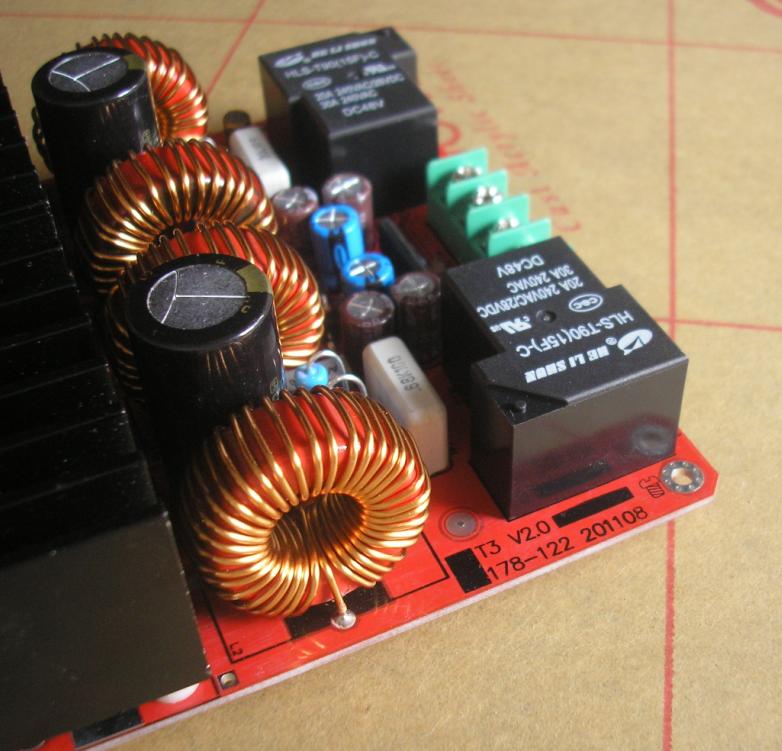

Looks like a nice, clean, board
I see a 680nF output cap, and two 100nF Zobel caps. Are they enough to critically damp the output inductor?
yes, we have some SMT parts for filter very close to the chip.
Looks great hifimediy.
One comment though. I still don't understand why you (and other designers) place the output chip, and thereby the heatsink, on the component side of the PCB instead of the more natural bottom side so that it would be much easier to bolt onto a heatsink.

On the T3 mono version, we put output chip on the bottom side of pcb. That just depend on design.

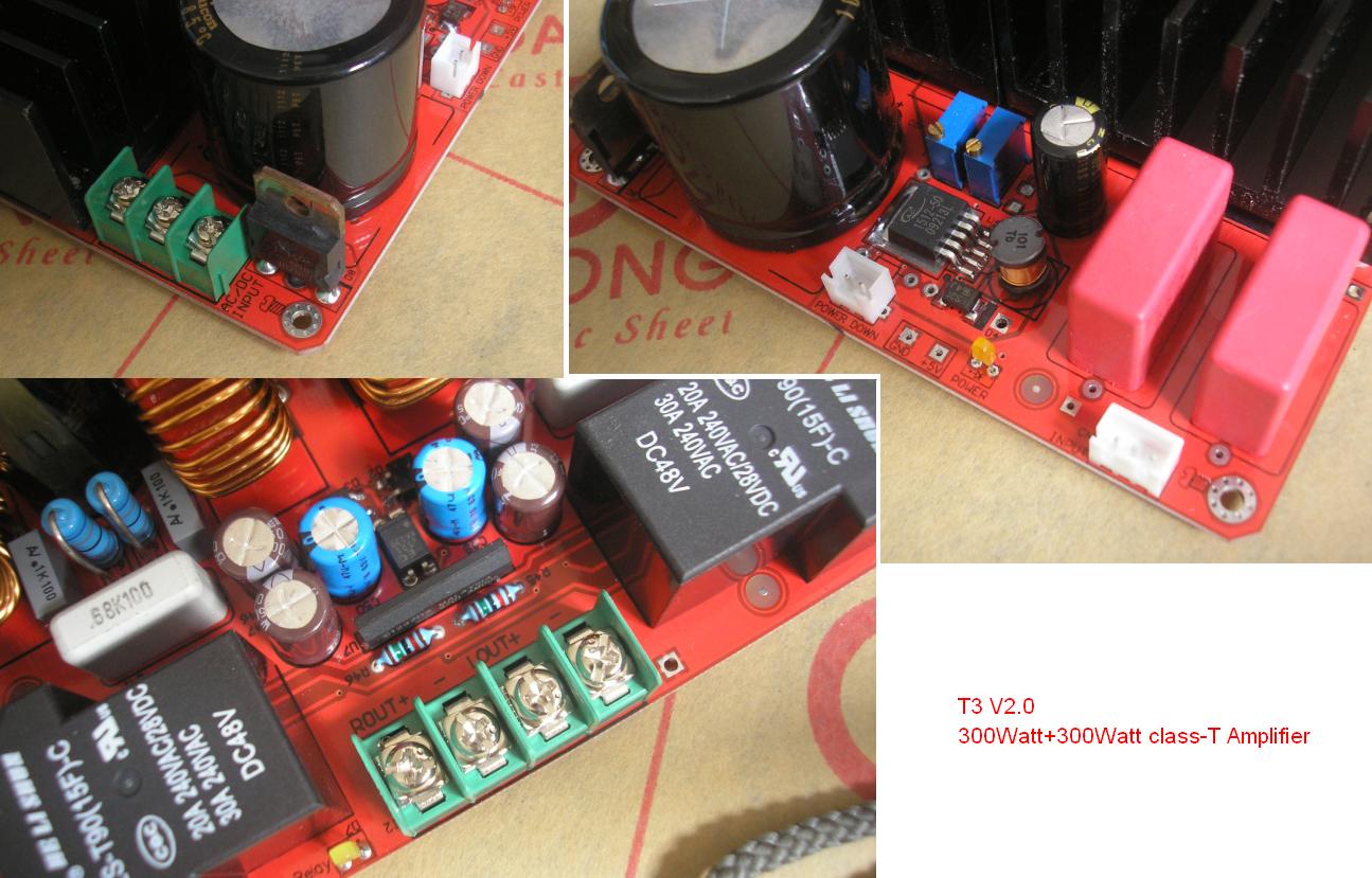

Hello,
so here it is
excellent news.
tell us more
- i see 3 power terminals. Do I understand correctly that this board can be powered by AC dual voltage transformer or DC single voltage ?
- does it have external on/off control same as you have on T4 (PWR down connector) ?
- did you use the tripath output filter topology (like on T2) or the ST topology (like T3) ?
- have you already measured the board THD / IMD. How does it sound ? what is the gain setting on this board ?

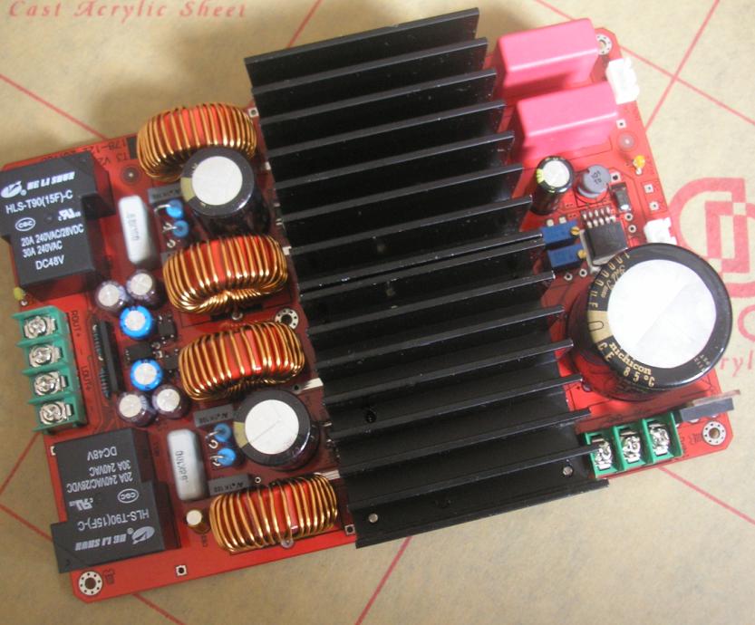

When testing the new SURE TDA7498 board, I found their SMT ceramic caps for the output filter were the cause of excessive harmonic distortion, which cleared up when I replaced them with poly film. I know that it is customary to use ceramic SMT for the less critical components in the filter network, but is this really a good idea in an audiophile-quality product? Have you checked the harmonic distortion in the 1-20KHz region using both SMT and film capacitors?yes, we have some SMT parts for filter very close to the chip.
Maybe it's SMD poly caps?
There is uusally some residual carrier on the output.
This isnt a problem as the carrier frequency is way above what the speaker can reproduce.
My IRS2092 design has 10 volts carrier on the output. Adding to teh filter usually ends up with losing top end audio.
My IRS2092 design has 10 volts carrier on the output. Adding to the filter usually ends up with losing top end audio.
Actually, I was looking at the output LCR values, and noting that with a 4 ohm load, a 680nf capacitor would give critical damping only with a total 11 uH inductor (two 5.5 uH coils) and a 58Khz cutoff frequency. Further, I noted that the two 100nF Zobel caps account for only about 1/13 of the effective total output cap value, which wouldn't seem to lead to very much Zobel damping

T3 V2 has similar PSU circuit as T4, so it accept AC/DC as you said. And It has Mute control port which will also power down the amplifier, also turn off the relays.
This board use ST's filter. There are some SMT component near the output chip, which is also according to the application notes. Beside, T3 mono version also use same sch, so no need to worry about the quality.
I think THD/IMD is similar to our other board, and I'm still working on the testing.
The gain is fixed to 25x(+28dB). The reason I didn't include the gain setting part in is it may be not good to the amplifier, what I'm doing now is make input circuit as simple as possible. And I can easily use a Volume controller to work with the amplifier.
