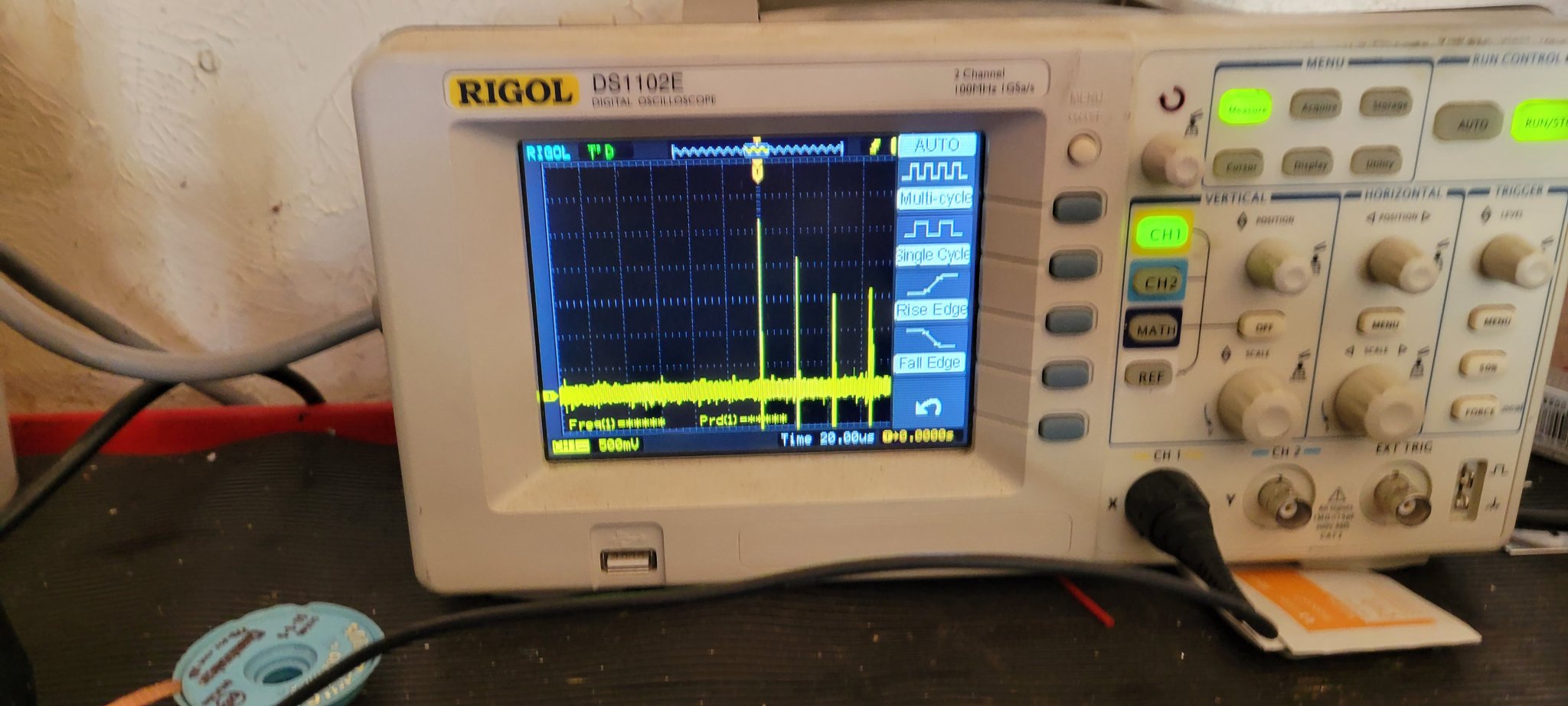

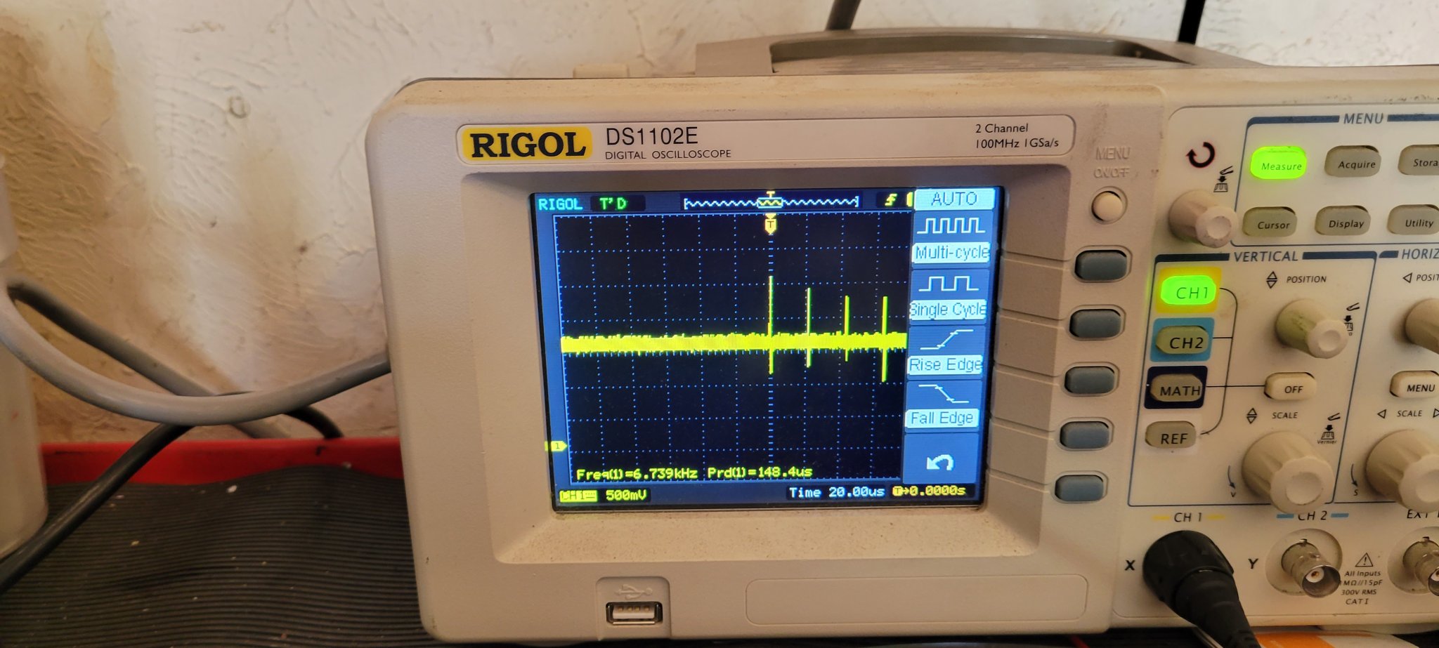

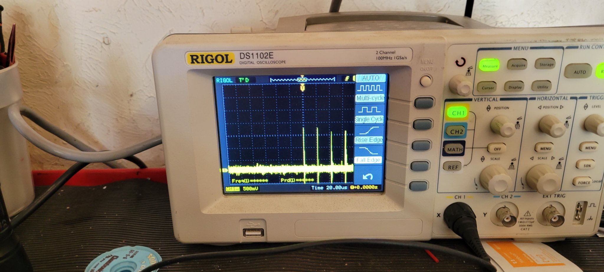

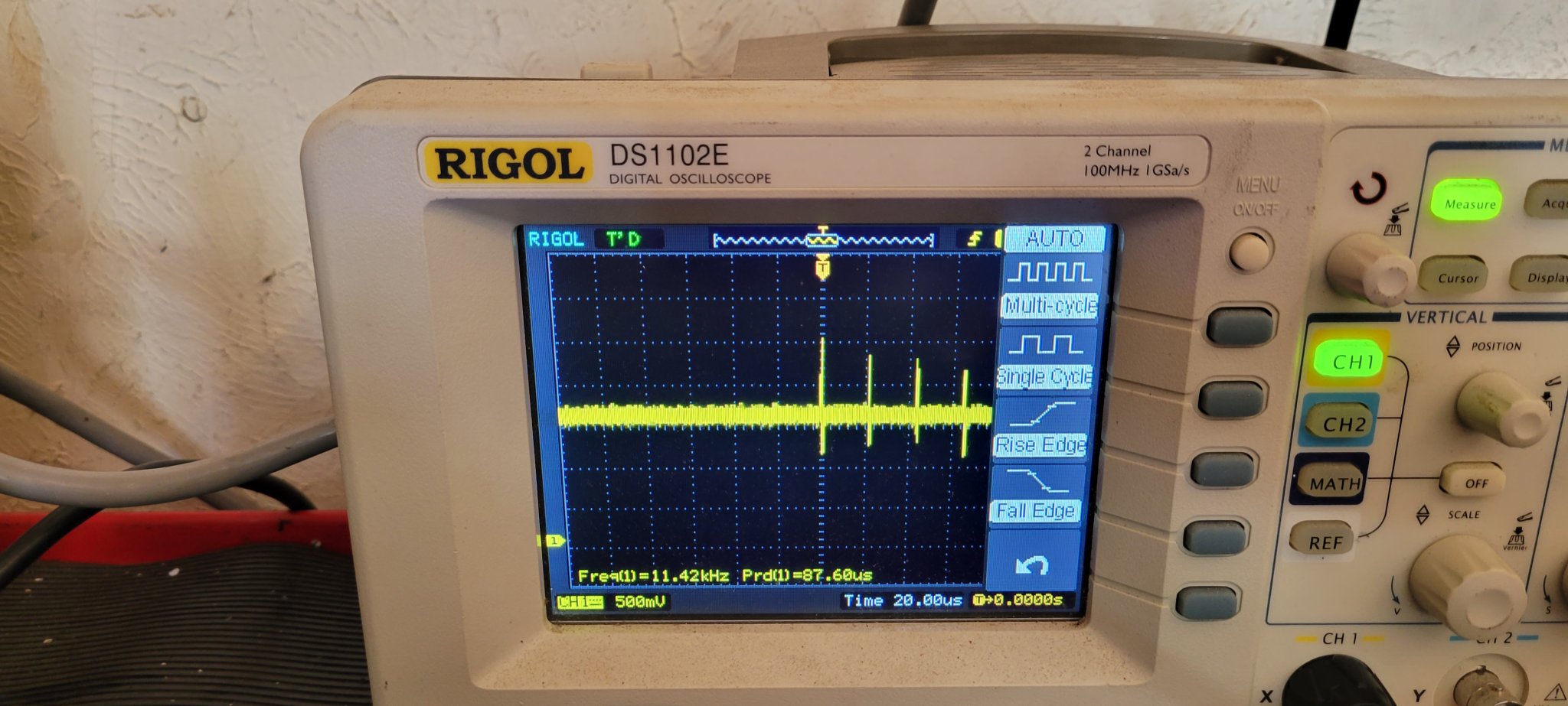

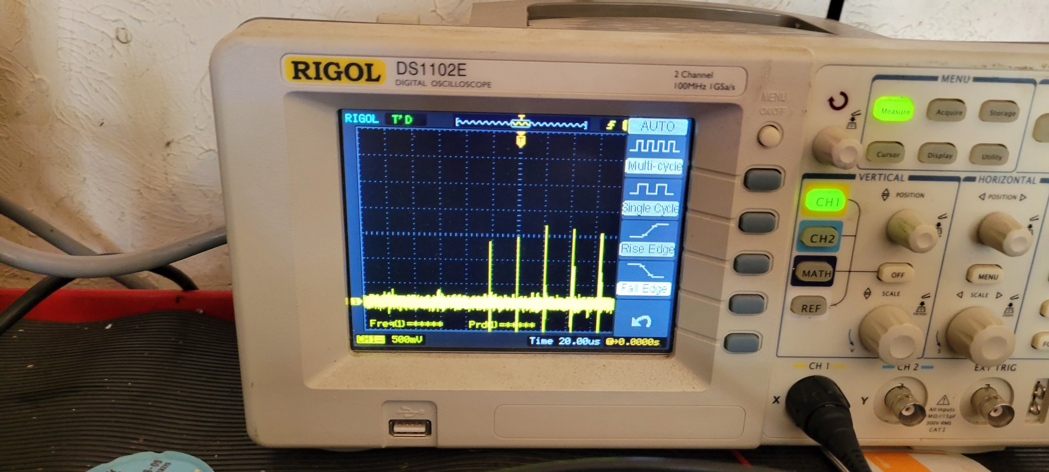

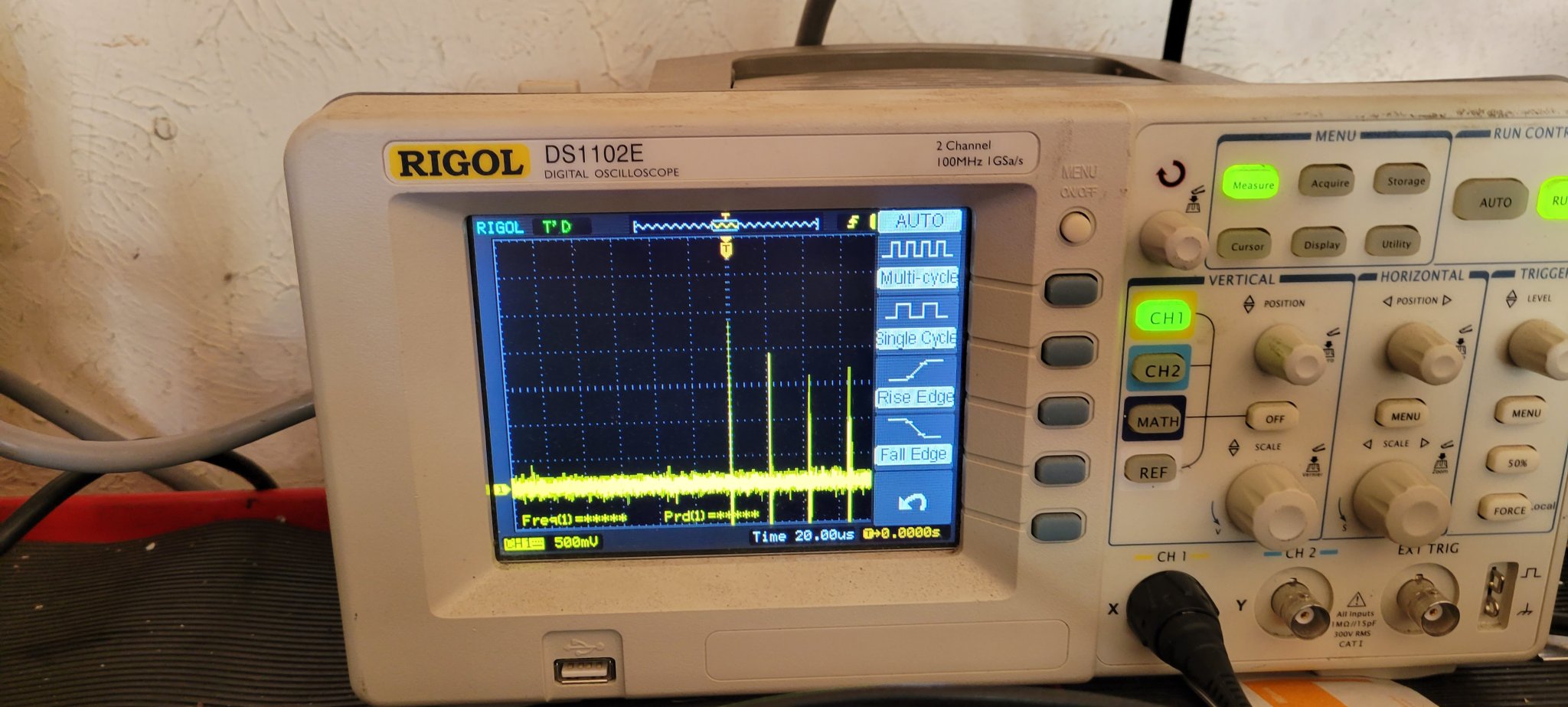

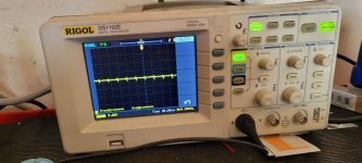

Can you insert a 1 ohm resistor in series between the output pin of U1000 and the board?
A 1w would be able to handle the full output. If you use something smaller, watch to see if it begins to overheat.
Measure the voltage across the resistor when the output is being pulled down to 4v.
U1000 pin 2 with 1 ohm 2watt resistor in series I have a .24 vdc voltage drop across the resistor. 4.13v output on u1000 pin2.
It doesn't look like the regulator is capable of producing its rated output. It's rated for 1.5 amps and is only producing 0.24A of current. I'm assuming that it's not excessively hot.
