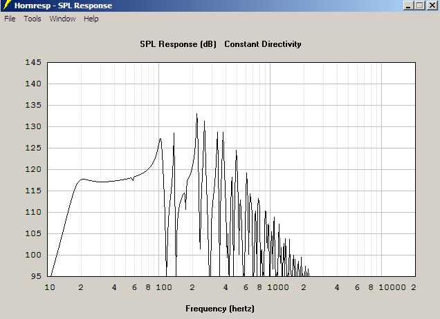

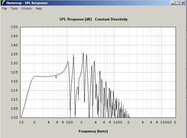

FYI, An powerful OD T-TQWT suggestion using 2x CSS-SDX15 drivers:
b🙂

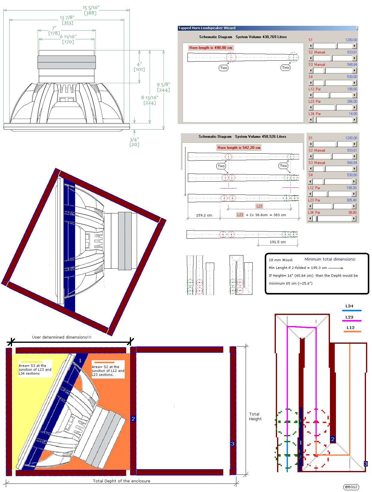

Bjorno ... can you give me a idea how big a box I would need to build this? ... only restriction is height of 16" or less
Steve
Steve
Hi Steve,
Have a look at Picture 1. Are you aware of the frame Width of the drivers ( 15” 5/16): You have to 'DIY' decide on if to use a slanted baffle and provide the actual drawing dimensions at S2 and S3.

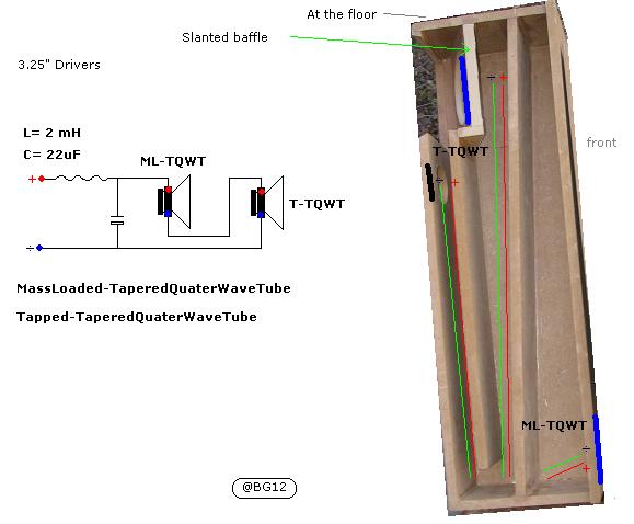

FYI.A couple of years ago I designed a small piggy-back T-TQWT with a slanted divider that worked out quite well😛icture 2.
b 🙂

Hi Bjorno ... thanks for the drawing ... Is this for a single SDX15? as I only own one of those drivers and they have not started building the MK II yet afaik ... been in design for about 2 years so we wont know the parameters till then ... I was going to use the |TC sounds LMS-R15 for the other box ... I do know about the frame dimensions but the driver was going to be installed on the front of the ported box ... each box dimension was 48X43.75X16 with a 3" wide and 40" long slot port
Having said that the dimensions on a ported box are simple in comparison to this and I am at a loss as to what angle to tilt the driver 😕
feel bad that you have to hold my hand on this but the performance increase is too tempting not to consider

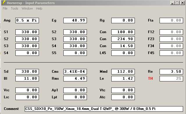

Hi Oliver ... thats interesting that the dual TB have more output ... would dual SDX10's have more output than the TB?
so with dual SDX10 we are talking about a box just under 12" with 3/4" mdf venting into the corners?
Thanks again
Steve

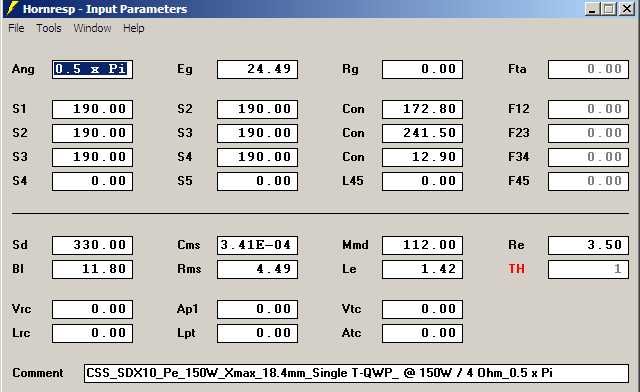

Hi Scruffyht,
Post #57:"...driver located at both ends of a even diameter pipe..."
That was an oversight, the driver is located only at one end of the pipe, the rest is correct; anyway the Hornresp Input tells the story (long L12, short L34).
For a dual driver with a straight pipe the cross-sectional areas don't quite double (from single 190cm^2 to dual 330cm^2), and the lengths change slightly (to improve the 0.5 x Pi SPL response in Hornresp). Obviously, we can double the input power.
Both version stay slightly below Xmax (=18.4mm) @ nominal input power of 150W for the single, and 300 W for the dual. This is a plus, as these drivers have been reported not to like to driven past Xmax.
As to riser height: 10.8125 (SDX10 Dia.) plus 1.5 (2xMDF) plus 0.125 (wiggle room) equals 12.4375". To get lower you have to tilt the drivers; same problem as with the SDX15s and 16".
