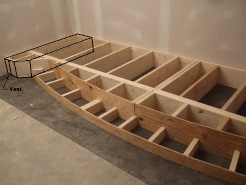

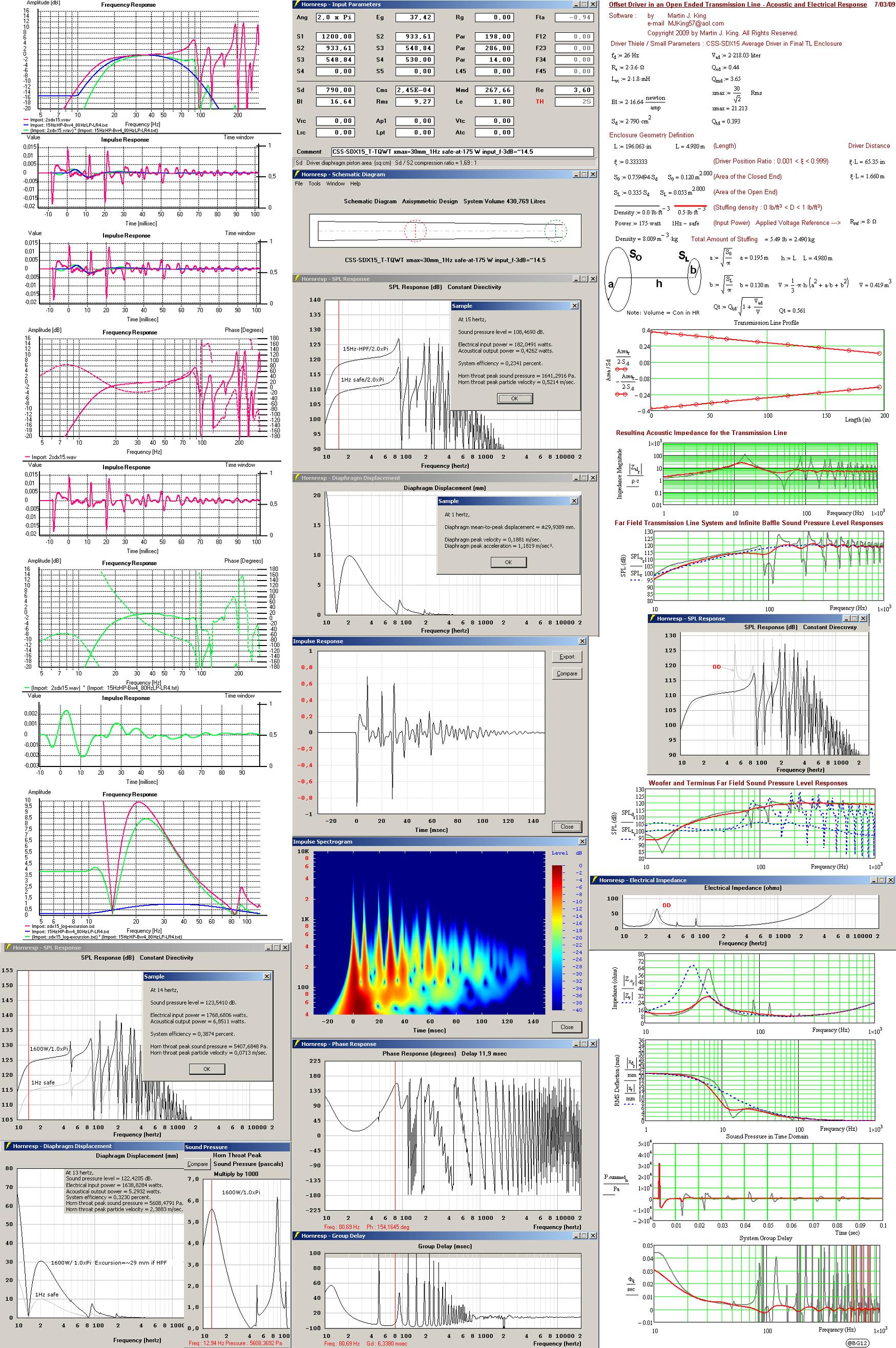

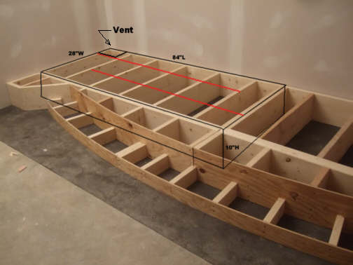

You'll have to work out the details for driver mounting and access yourself. There should be 1/16" clearance (minimum) all around the drivers. For stuffing refer to the last drawing, same general guide lines apply here.
There are some differences in the Hornresp simulation. The fill will take care of that.
You can use this as an example on how to slant a baffle for a SDX15 (use 65 degrees).

Thanks Oliver ... one question ... how wide is the box?
Hi Scruffyht,
I hope these will do well for you. Permo's thread is a good one to reference for construction details, and stuffing advice. This all goes back to bjorno's effort to popularize this type of enclosure.
Have you decided what to do with your SDX15(s)?
Hi Oliver ... I am in analysis paralysis with the SDX15 at the moment ... I have the wood cut to build a LLT and one driver ... bjorno tried his best to explain how to incorporate that into his design but I am clueless on what the box dimensions would look like and what the difference in performance would be

I have already spent the couple hundred on wood for the LLT design for 2 boxes so I should just build it as is with the driver I have ... I will have 2 X T-TQWT at the front of the theatre in the stage plus the 2 X LLT under the riser ... that should cover it right? 😀
Can't see why not. I suppose it depends on what kind of SPL you need. If its just a house then that should knock your socks off. My amp for my horn sub tapered quarter wave sub generally runs around 10 watts for normal use. Its only got a 100 watt amp and I don't think I've ever run it at full power for fear of my eardrums and windows, and things did fall off of the shelves on the other side of the room (not little things either!).
