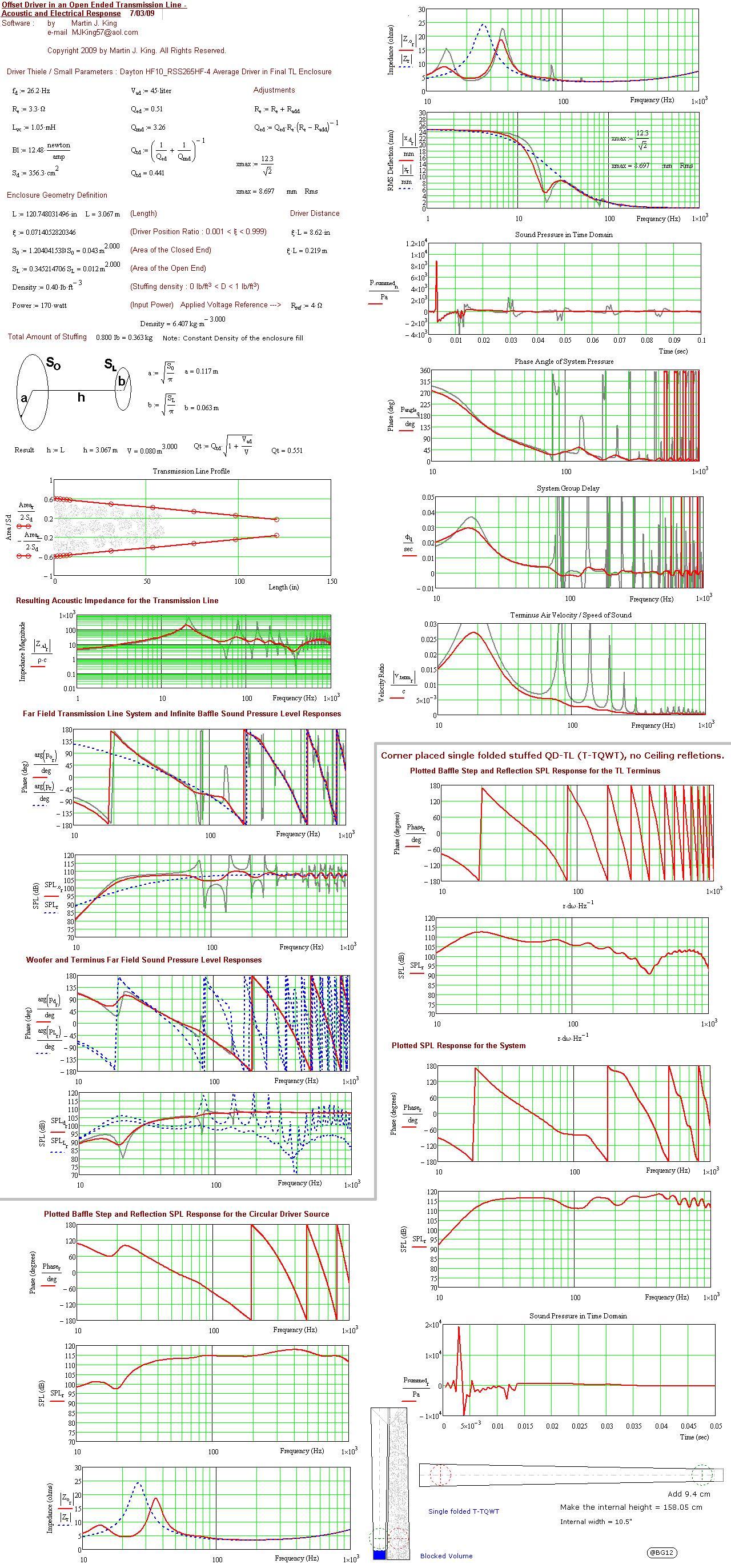

A long time back Bjorno designed some T-TQWT for the Dayton audio RSS265HF-4 10" Reference HF. I'll attach the his work below. It's been a long time since I've worked with horn response, but I was hoping to build a subwoofer using two Dayton 10hf driver in an opposed configuration to reduce vibration. I have a full wood shop, and my wife and daughter are headed out of town for the weekend, so I was hoping I might be able to knock them out this weekend.

That said, Bjorno's work looks solid as always. There are areas noted for the open and closed ends, and the internal width. Looks like it'd be a 7 panel project for a single-fold design.

Certainly Bjorno did a great job and already has it drawn up for a single driver, single fold version. I was just wondering about a dual driver version with the drivers opposed to reduce vibration. I feel like that should be possible, but I have trouble imagining what it would look like.
Maybe just two single versions built mirror image so they could be opposed. Built as a single box? I guess I had been thinking about having the drivers right next to each other, but simply building two single driver versions as a single box could do it.
You could do that, but simply putting the drivers back to back on the side panels between the divider board and end panels is all that's required and of course double the SO, SL areas and if the width x depth dims are too small to fit the drivers, then scale SO, SL to fit, so do a scale drawing to make sure before 'burning' wood.

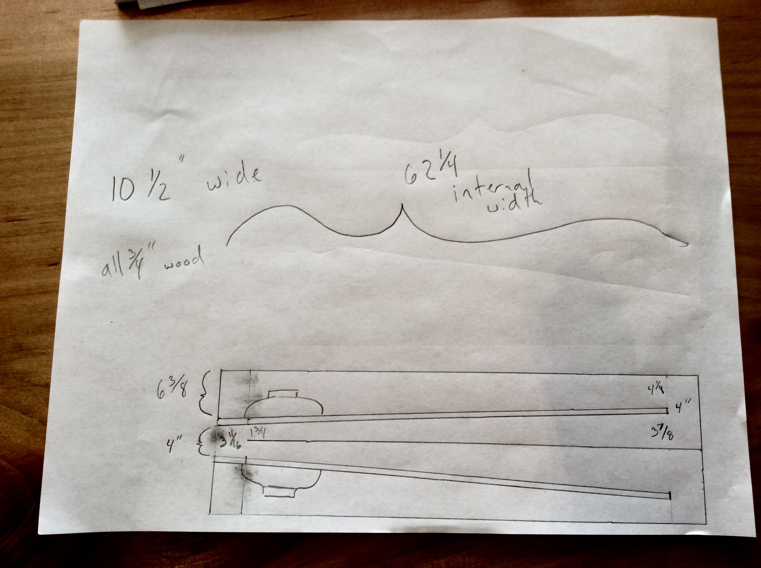

I read this right after you posted it, and still can't wrap my head around how this would look. If they are back to back, how are the front wave and back wave of the drivers directed? Are they in a sort of W-frame arrangement? Sorry to be dense...

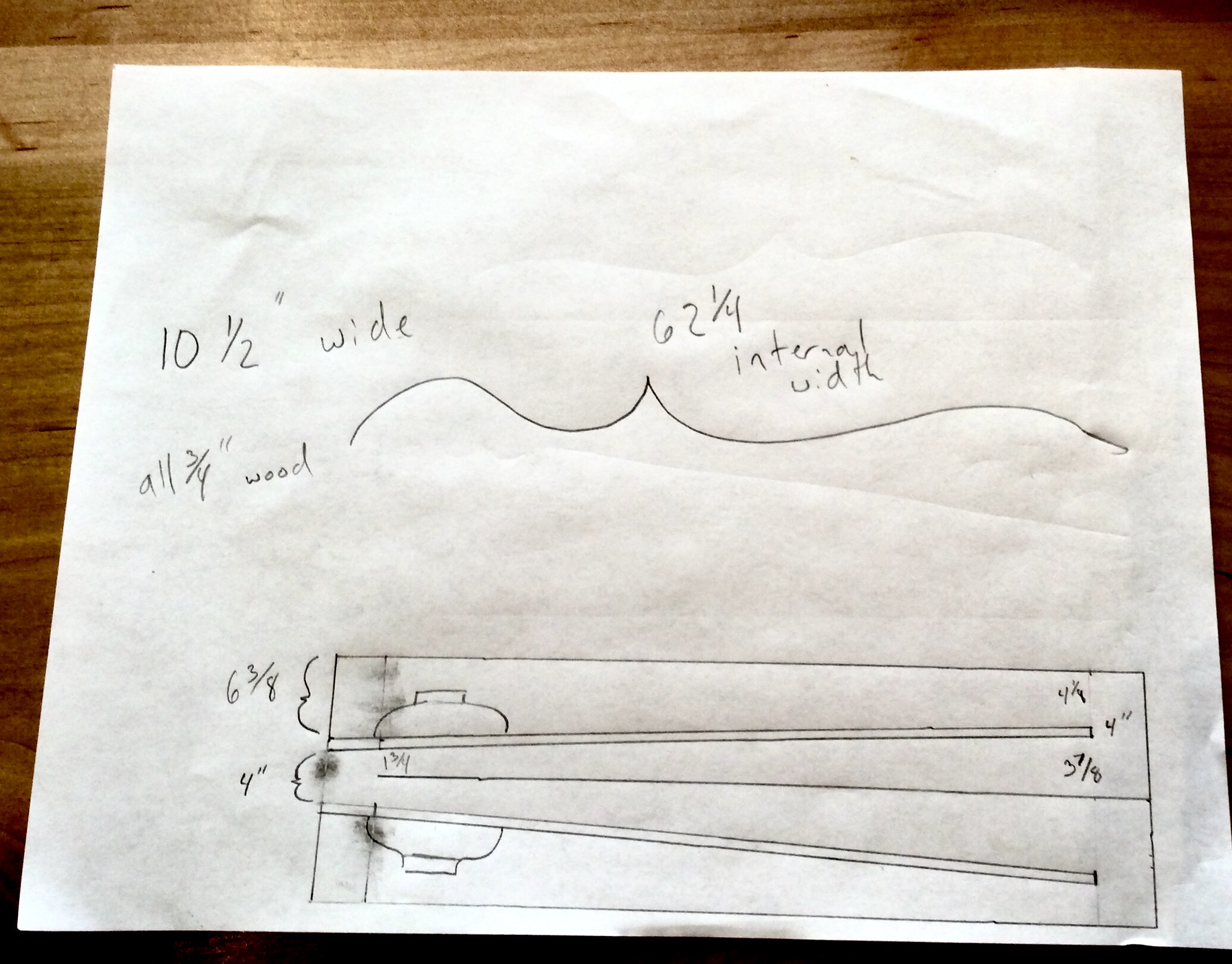

Alright this looks to be the best I could come up with. I didn't know how to indicate it in the drawing, but there are no side after the center divider ends. Making for holes on both sides ~4"x 3 11/16" .
I think this is faithful to Bjorno's design. Does anyone mind taking a look? Sorry I have no skills in sketchup or any kind of CAD program.
With the 3 11/16 added, also it says 62.25 internal width..... that should say length.
Oops! Must have had a 'senior moment' 🙁, didn't notice the tapped part on the right side of his worksheet.
Anyway........for two drivers in tapped bipole, your layout looks fine.
GM

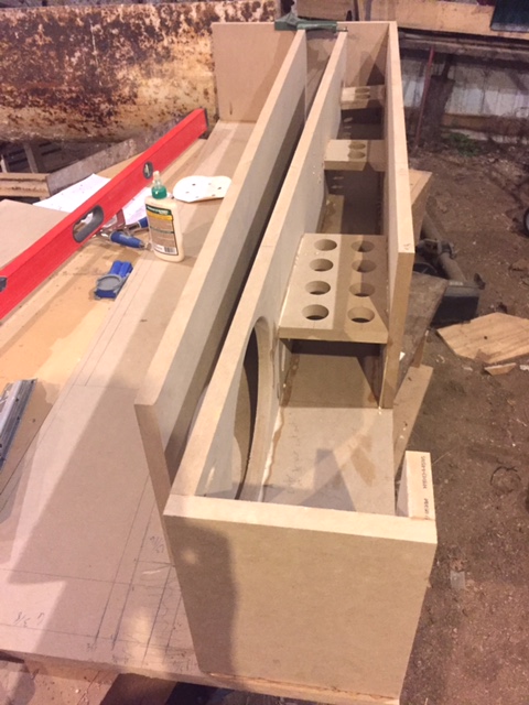

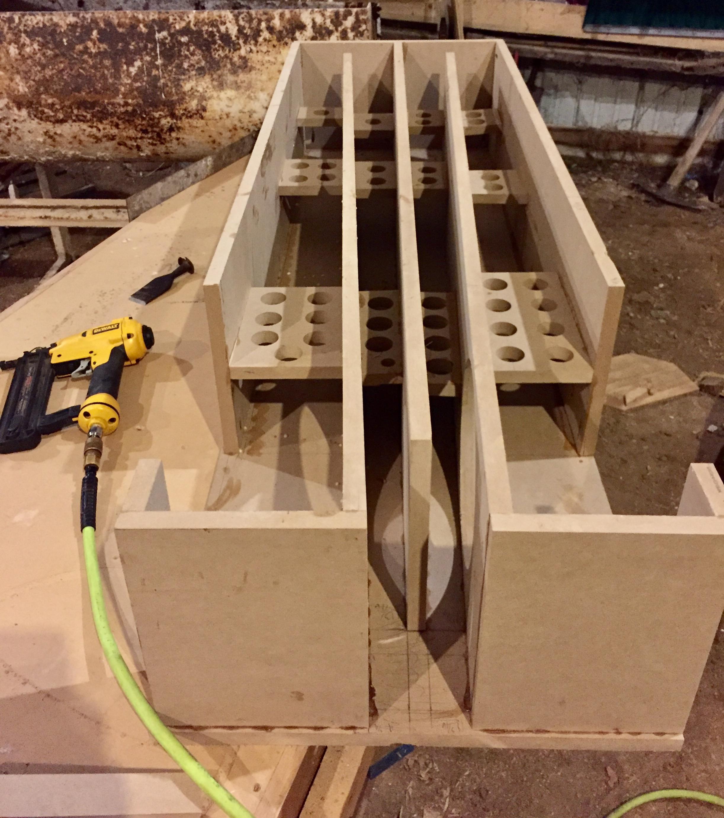

Making progress slowly but surely. All the panels are pocket screws and titebond 3, braces are brad nailed and titebond3. I'm going to try pl premium on the last side since, as I hear that is the best thing for making sure the are no air leaks. I should be able to glue that on tomorrow evening. Anyone have any advice on how much clamping pressure I need? I've never used pl premium before. I've got plenty of clamps, I just don't know if overclamping could be on issue with pl premium...
Definitely a pass, plenty of bass, and it sounds great. I have some room modes that I would like to deal with. I have it equalized so it sound decent where I usually am in the room, but the sound changes dramatically depending on where you are in the room. Might be some small subs in my future to help me deal with the room modes. The T-TQWT is great though.
