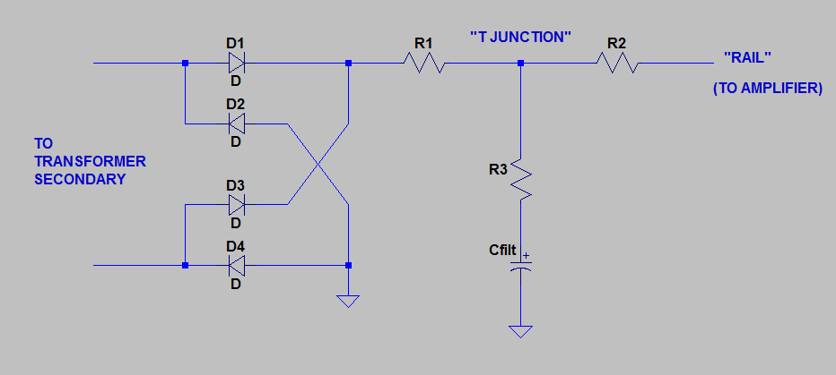

I was reading Slone's book on amp construction and I read I passage I cannot understand. I quote it here (with some cuts and modifications) hoping you can confirm what he writes and explain me why it's true. Or the other way around..
A common mistake is forming a "T" network to connect the rail conductor, caps, and rectifier output. In other words, a splice is made in the conductor connecting bridge output and the rail conductor. Then a single conductor is run from this connection point to the caps. [...] This is wrong! A T connection will cause a significant voltage drop across the single wire leading to the caps and the 2 connection points on either end. This voltage drop will look like an increase of ripple content on the rail supplies.
Is this actually true? And why?

Any wire, and hence resistance, in series with the caps can be very bad indeed. Supply caps are charged at quite high currents for only a small period of time at the beginning of each (rectified) cycle so even a small resistance can result in noticeable voltage spikes on the power supply rails. This is why "Star" wiring is usually udes.
In a PSU you must regard every connection as a resistance. This is because it is a resistance. If you have amps of current in charging pulses, then it does not take much resistance to develop a significant voltage drop. Millivolts are easily seen, because connections are typically in the milliohm range.
You can't avoid capacitor ESR, but there is no need to add unnecessary wiring resistance too.
As a general rule, mistakes in PSU grounding are more serious than mistakes in rail wiring.
Use a critical choke input supply and you will mitigate this issue. Smooth constant conduction beats high current charging pulses. You'll need a higher voltage transformer to get the same output, but it's worth it IMO.

Slone is referring to the schematic below. R1, R2, R3 are the unavoidable wiring resistances, lead resistances, and connection resistances of the high current paths between power supply rectifier, filter capacitor, and amplifier "rail".
He warns readers that a T junction configuration will make resistor R3 larger, and this is undesirable.
You can do a back of the envelope calculation to estimate the maximum allowable value of (R2 + R3).

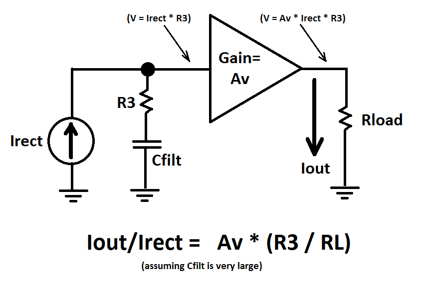

Hi DF96, you're right, I did a lot of handwaving and not much math. I wrote "distortion" and "signal-to-noise" when, in fact, I was simply estimating the Ripple-Current gain. I "derived" the transfer function from ripple current input, to loudspeaker current output, by appeal to intuition. I'll derive it again here, this time with less handwaving. A block diagram is attached.
The power supply rectifier(s) charge the power supply filter capacitance Cfilt. Unfortunately, the amplifier builder did not heed Randy Slone's warnings, and so an unwanted series resistance R3 is present. An unwanted noise voltage Vunwanted = (Irect * R3) is present. Notice that if R3 = zero then Vunwanted is also zero. (I've assumed that Z(Cfilt) << Z(R3) for mathematical simplicity)
The transfer function from supply_rail, to amplifier_output, is modeled as a gain block whose voltage gain is "Av". This, in fact, is the amplifier's power supply rejection ratio: Av = PSRR. The loudspeaker connected to the amplifier output converts voltage to current: Iout = Vout / Rload. We now have everything we need to write the expression for the Ripple-Current gain
  • Ripple-Current gain = Iout/Irect = PSRR * (R3 / RL)
So if you want your amplifier's Ripple-Current gain to be -90 dB or less, and if your amplifier has got a PSRR of -45 dB like the Blameless amp in Self's book, then you want (R3/RL) to be -45 dB. (R3 < (RL / 178)).

You still appear to be equating load current (mainly signal) to ripple current (mainly ripple), so merely expanding and giving more detail for a flawed calculation. In reality the ripple current will be larger than the peak signal current, by a factor which depends on things like reservoir capacitor size but will often be in the range 3-5.
