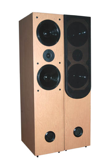

Hi Angshudas,
I m from delhi and searching for branded drivers for many years but i couldnt find except the boltons in delhi. I couldnt afford getting the branded one from outside delhi. I have just built an amplifier based on the lynx from ACD and wanna build enclosure with good quality drivers for it. But whether i should go for 2-way or 3-way with the available material in delhi, please tell me ,alongwith the brand of the drivers. I built a 3-way enclosure abt 5-6 yrs back with mdf and locally available drivers like Philips dome tweeter and birco from the lajpat rai mkt near red fort.I also built 60-100 watt amplifier and a subwoofer amplifier using 2sa1943/2sc5200 which worked quite fine.
regards,
Aman
Why 3 way?
Any particular reasob, you want to go for a 3 way? 3 ways are on its way out due to complexities involved in the x over and phase response. Check out my design which uses two 8 inche woofers and a single silk done. People say where is the sound coming from? pefect imaging.
2 way or three way has nothing to do
Hey Aman,
2 way, 3 way or even 4 way has nothing to do with the reproduction of sound spectrum.
Now days most systems are 2.1 meaning 2 ways as fronts and a subwoofer to take care of the bottom end.
No research has ever proved that 2 way is superior to 3 way and vice versa. The heart of the speakers is x over. People just love my 2 way over my three ways! and they measure nearly same on the CLIO.
I would suggest go with a 2 way MTM design, it will cost you cheaper, easy and more fun to do. and its f range is
31 hz to 24 Khz
I wouldnt worry much if I were you ! :-0
hi Himanshu,
Nice to see those pictures...we dont get to see or appreciate most of what ppl do...!! I must admit, those are one of the prettiest i have seen in DIY Indian circles...!!
what drivers are those...???
All of us here would appreciate more info..
Many thanks
ajayan.
