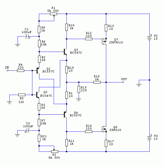

Re: Bingo!
I'm injecting voltage on my current-feedback preamp and it works like a charm.😎

Re: Pre Amp
Here:
http://www.diyaudio.com/forums/showthread.php?s=&threadid=40783
Not yet, it's still in my head and in the prototype.😀
Audiofanatic said:Carlos,
Can you shear your current-feedback preamp with us?
Here:
Audiofanatic said:Or tell us where we can find the schematic?
