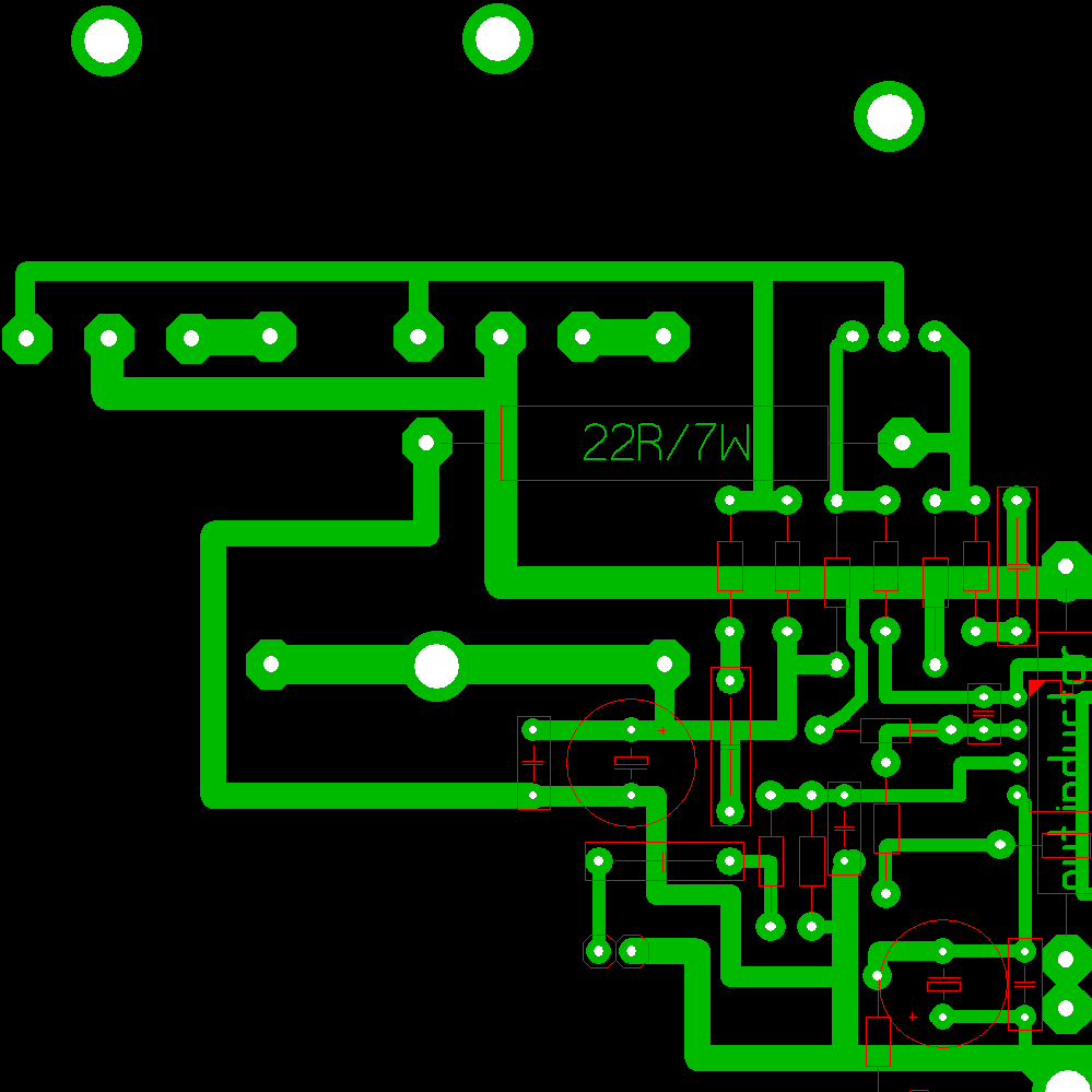

Guys, thanks again...I must say that I gave up from this project because I never solved oscillations issue. I made 4 amps based on this schematics, and 2 of them worked nicely but burned after 6 months because of heavy load..3 and 4. amp never started working (god knows why....) so I found this too complicated and hard to trust... Thanks anyway
hmmmm
that sounds like the things i was talking about .....will it be possible to have a picture of your pcb or pictures of your final layout ????
i actually seen this circuit before and i felt like playing with it since it is relativelly simple ....also if constructed properly i think its looks solid rock to me
Moby said:Guys, thanks again...I must say that I gave up from this project because I never solved oscillations issue. I made 4 amps based on this schematics, and 2 of them worked nicely but burned after 6 months because of heavy load..3 and 4. amp never started working (god knows why....) so I found this too complicated and hard to trust... Thanks anyway

this will be
my approach in an amplifier like that
--- keep amplifiers seperated from each other
----keep amplifiers away from secondary circuits
----since amplifier board requiers only 9x18 cm if 2 of them are fited on the side of a sassi then there is enough space to create one pcb that will include all the secondary circuits like protection ,fan control,secondary psu, mains rectifier and filters .
---- also it can be all done in one pcb but topology should remain the same ( to my opinion )
this is a pcb that is designed in 15 minutes but more or less this is the way i like to make them....
next days i will try to shape it abit more and then poduce a protoype to see how its going .....
will post my results ....
