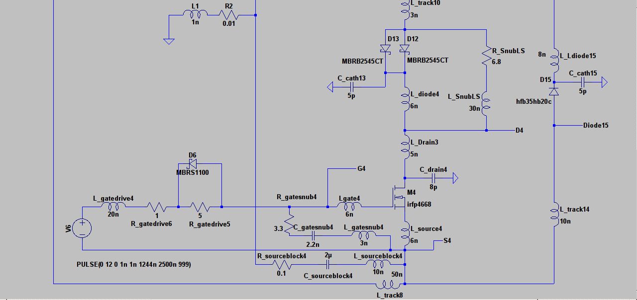

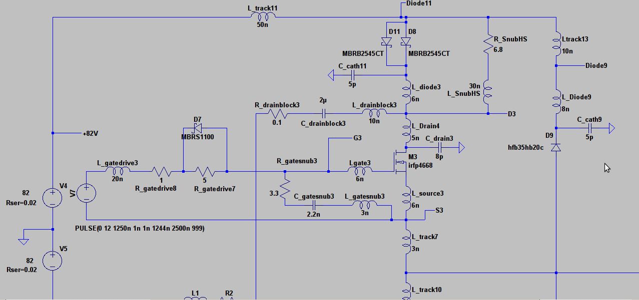

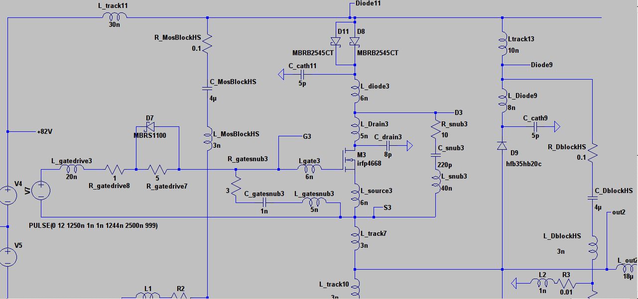

Regarding posting #140:
Nobody pointing to the 100nH in the rails?
Nobody highlighting that the voltage across M4 is at the data sheet limit instead 160V-170V?
The 100nH are way to high for the planned currents and the energy which is stored L_track8 and L_track 11 is pushing the MosFet into avalanche and when the energy is burned down the high voltage will remain across the MosFet in OFF status because there is not discharge path.
...might still be inside the allowed avanlache range (not checked yet), but that are ugly unnecessary losses.
L_track8 & 11 must be designed to be much less ==> Layout!
Furtheron simulation is pointing to the direction that a very effective and low loss snubbering is possible by paralleling 1-10 Ohms to the shottkys, which are in series with the MosFets. Besides snubbering this also gives an discharge path after avalanche.

The simulation of the power stage with its parasitics will hopefully guide me through the layout and avoid relooping through hundrets of non working PCBs.
Nevertheless the layout will take time, because it will be an iterative process between sim, placing components, guessing parasitics - resim, replace components, reguess - reresim... 😉
The sim is showing pretty detailed which component properties, which copper tracks, which snubbers, etc - will lead to different component stress and more or less ringing. By placing tracks and positioning components you really can change the behavior massively and not always it is the best to make every track as short as possible. Great! ...most likey I should also model the equivalent circuit of the ecaps...

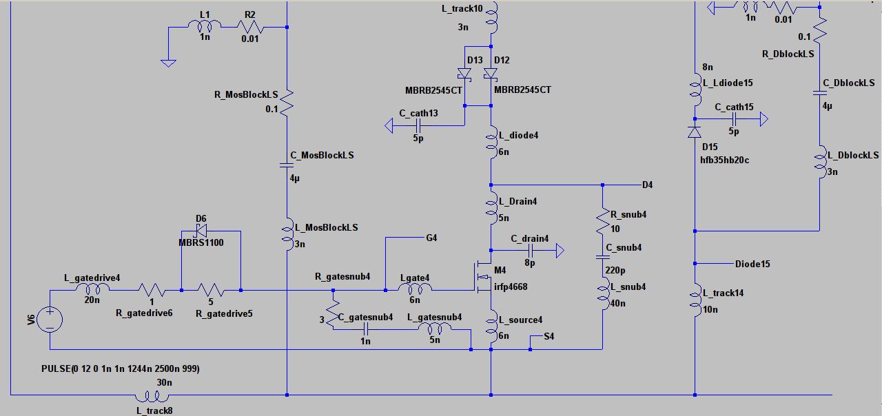

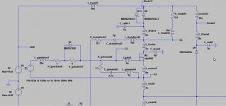

...went on with snubber analysis and fundamental considerations about where and how to block the rails.
It turns out that fast rail blockers at two points are extremely helpful:
- Across both MosFets including both series shottkys (note: previous arrangement was at across both MosFets and shottky inbetween only)
- From the cathode of the upper freewheeling diode to the anode of the lower freewheeling diode.
These blocking caps can be center tapped to GND, but that's not mandatory.
For the concerned currents the values of the blocking caps must be in the range of multiple uF.
If all this fufilled the system behaves pretty calm already without snubbers.
The earlier simulated damping resistors across the series shottkys become completely unnecessary.

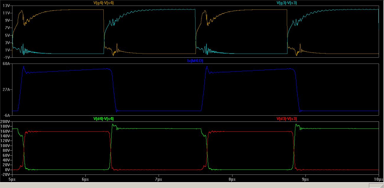

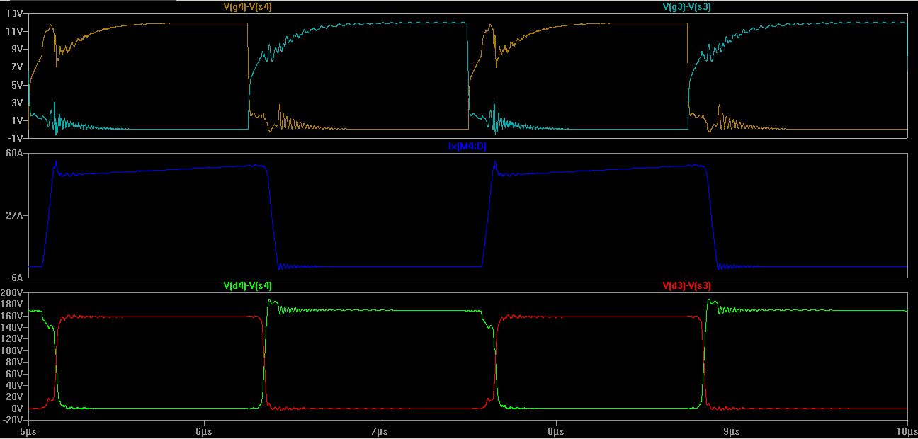

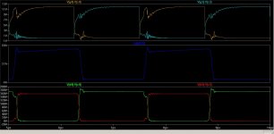

Attached the simulated schematic and wave forms.
The first wave forms show the behavior even without drain-source-snubbers.
The improvement with drain source snubbers is not necessary for functionality, but has the potential to pay back during EMI measurements.

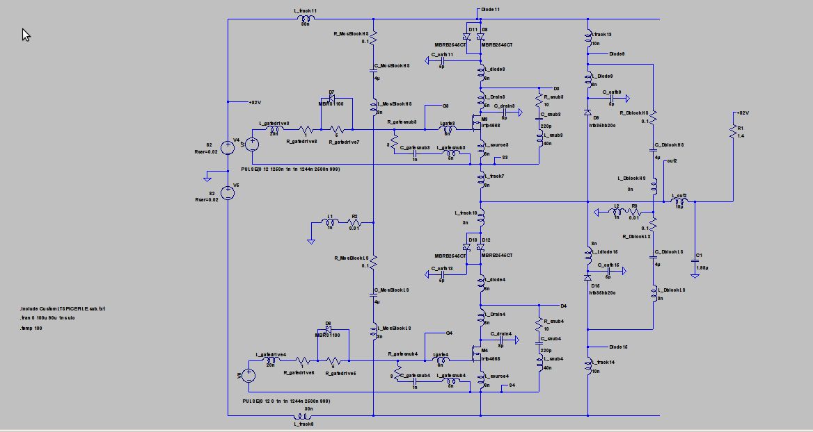

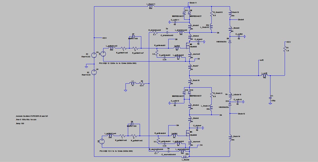

Attached the updated schematics.
Power stage is now updated according discussion, manual calculation and simulation.
V0.1 is obviously more complex than V0.0, but with respect to the discussed
experiences of multiple friends here and finding the same result in my calculations, I am skipping the initial plan use the body diodes.
Qrr is simply to high and would lead to a less reliable design.
The bunch of small caps at the switching stage could theoretically be solved by two caps, but multiple small SMD caps will be fortunate to achieve low parasitic inductances in the layout.
Again looking forward to your valuable feedback.

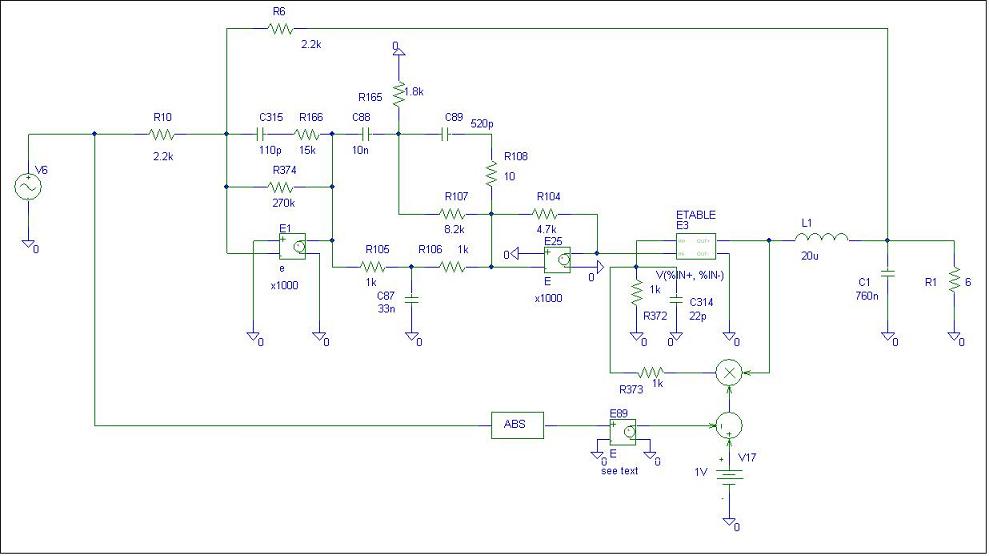

I have question with the modulator configuration
Amplifier 1 (E1)
C315 = 110p
R166 = 15k ; sets the frequency response ?
r374 = 270k ; sets the overall gain ?
Amplifier 2 (E25)
Network A
E88 = 10n
R165 = 1.8k
C89 = 520p
R108 = 8.2K
R108 = 10R ; Forms a tuned circuit anyone help me figure out the calculated values here ? 😕
Network B
R105 = 1K
C87 = 33NF
106 = 11K ; forms a delay help me figure out the calculated values here ? 😕
Charles has published his loop topology with AES and later here on DIYaudio.com.

Send you a PM the jpeg version is a bit distorted and hard to read.
Thank you for the reference choc dude.
Hi Reactance,
you're welcome.
Great that you are already in contact with Charles.
2 years ago I also had a short exchange with him about his loop topo.
It's always best to get the information directly from the originator.
