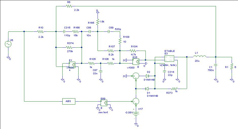

I still owe you the other modulation variant. Here it is. Instead of Multiplying the fed-back voltage (which is deterimining the hysteresis) in some way or applying clamping somewhere in the voltage divider the hysteresis can be set solely by clamping form the beginning. Simulated performance is almost as good as the version with multiplier. The gain of E89 was set to 0.35. BTW: C314 is there to guarantee convergence of SPICE (also the other variants had this) it is not needed in a real-life circuit.
Regards
Charles

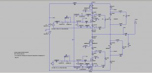

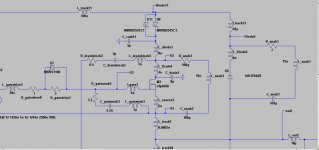

For the simple configuration of just two MosFets I am using since years a simulation model which includes the relevant parasitics. Fit between sim and reality was not perfect, but good.

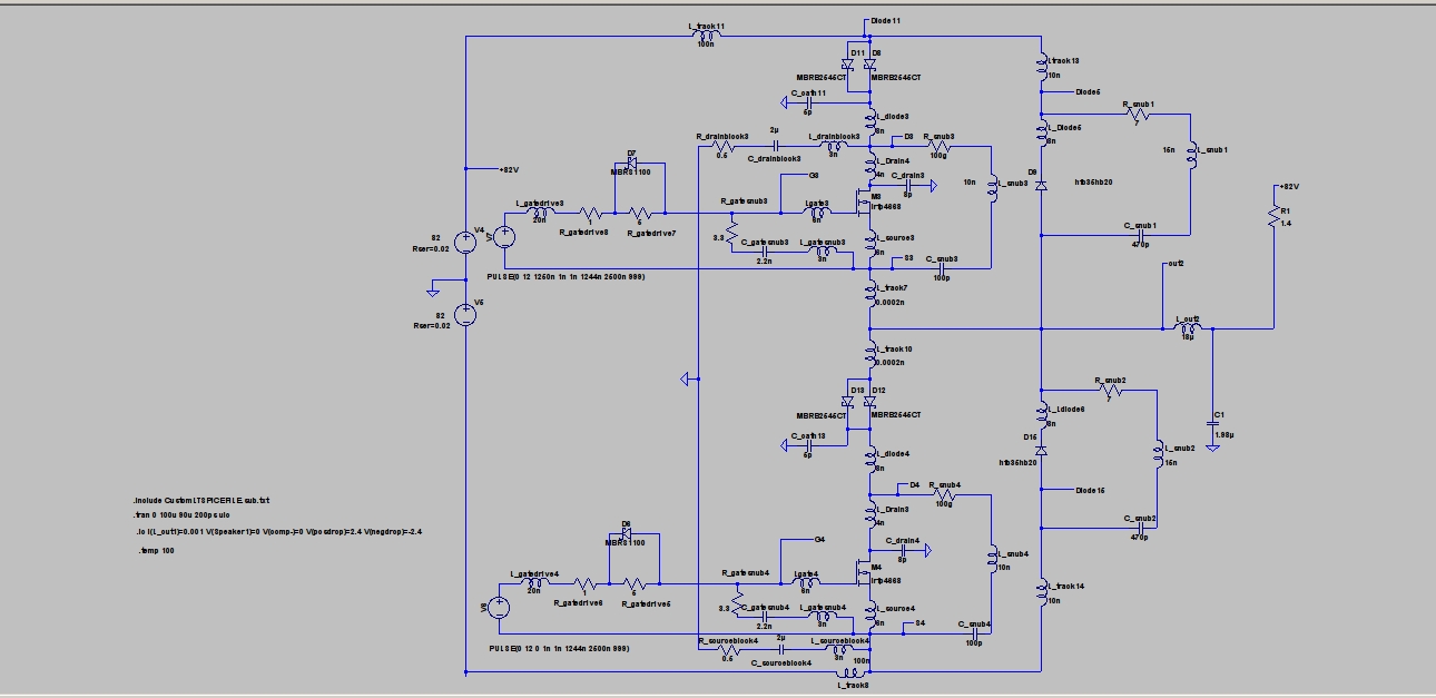

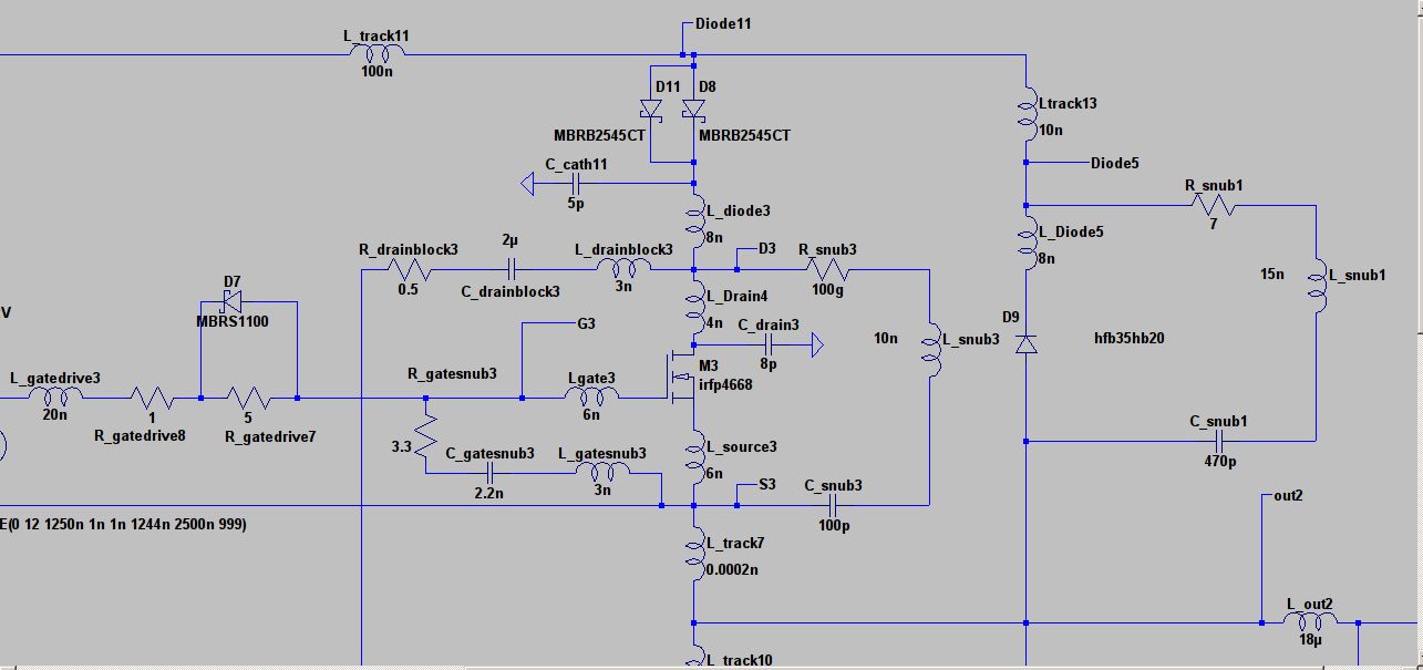

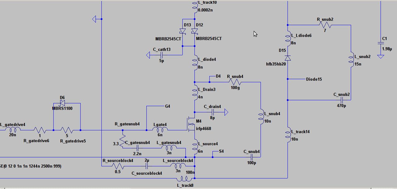

I extended the sim model to the circuitry with series shottky and additional freewheeling diode.
Attached a screen shot of the model and two zooms - showing high side and low side more detailed.

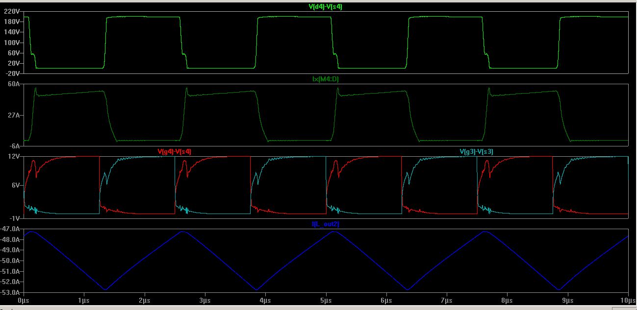

When using reasonably good freewheling diodes I am getting a mostly calm behavior. Even without any snubbering the wave forms remain good enough that the circuit should still work somehow.
The attached wave forms are showing the situation with the values of the shown schematics.
Means snubbering at the gates and across the freewheling diodes, but no snubbering at the MosFets. Also I put 2uF caps from the drain of the upper MosFet to the source of the lower MosFet, while the 100nH inductors model the wiring towards the e-caps and e-cap inductance.
Which real life experiences do exist? Is the configuration with series shottkys and fast soft recovery freewheeling diodes really that forgiving as shown in the sim? Please note, it shows the situation of 50A hard switching, not idle.
