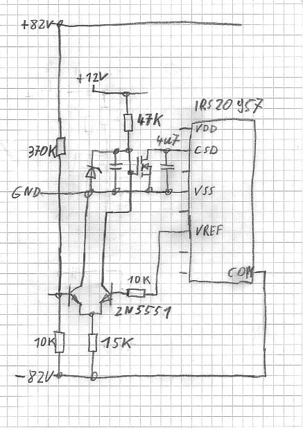

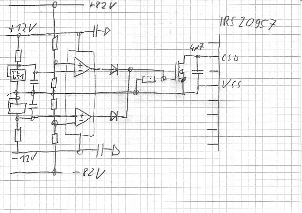

The over voltage protection is still an open topic.
Desireable shut down window: 92V...100V
OVP1
My high end proposal with a dual OP and two precision references would end up
in the following additional components and solder joints for the OVP:
17 components
43 solder joints
Precision OK.

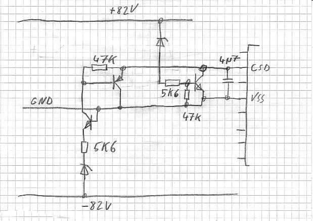

OVP2
Pergo's proposal with zener diodes:
9 components
21 solder joints
Tolerances and thermal drift of zeners, availability of the right zeners and the soft+slow discharging
of the 4u7 will make it hard to hit a reasonable shut down window.

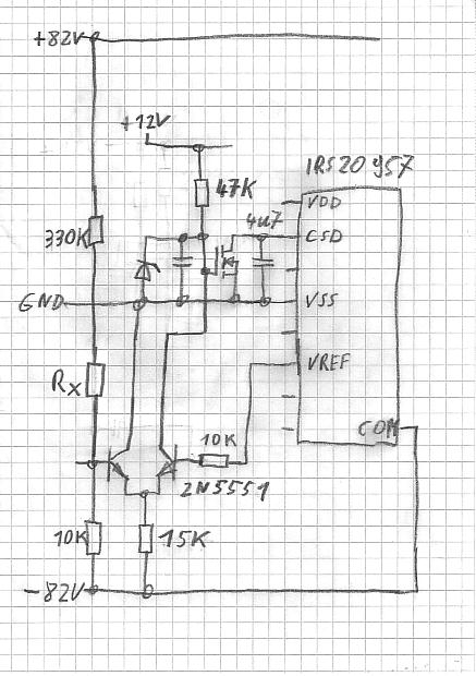

OVP3
Another approach:
It is not necessary to check both rails in seperate, but the sum is relevant.
Furtheron the IRS20957 has a reference on board.
By measuring VREF and the real values of 330k and 10k it is easy to calculate the
necessary Rx. Of course for mass production such approach is unpleasant, but for DIY it is easy.
Both 2N5551 should be glued together in order to keep thermal errors acceptable.
11 components
25 solder joints
Precision: Adjustment needed.
Votes?
Further proposals?
If yes, please prepare in a comparable way.

Better accuracy?
You mean better burning! It is not likely that a small zener and the base-emitter path can handle the currents that you would get by this clamping of the high power PSU.
I think it will need the series resistor.
Please note that this shut down disables the class D amp,
but supply voltage can still increase.
Depending on the used PSU, there might be the option to shut down the PSU as well, but some folks might even use a monster transformer with rectifier and caps....
The shut down has to be set below a sum of 200V, definitely yes.
In case of good snubbering you do not need excessive margin there.
Setting it to 185V...190V should be OK.
For experiments with the intended choke for SystemD_2kW, I used SystemD_MD, which uses 150V-MosFets and ran this amp with +/-74V rails for pretty some time (first thermal considerations for the intended 2kW choke...). The amp acted like this would be normal. At room temperature typically the real avalanche happens not earlier than 10% above the specified voltage rating. Furtheron the avalanche voltage slightly increases with temperature and last but not least some amount of avalanche energy is allowed without destruction.
I think stopping the IRS should cover even serious overvoltage as long as the 100V rail caps do not lift their heads.
Closer look: As soon as the IRS stops, the output will be pulled towards GND by the feedback resistor and/or speaker. With this the Mosfets and the IRS will not see the full voltage any more but just the difference between rail and output.

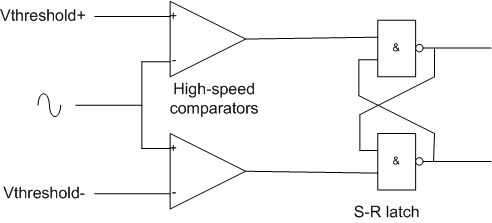

I wonder if you could use a window comparator, followed by an S-R latch as the modulator instead of a single comparator with hysteresis? I used the same arrangement in the past where I wanted variable hysteresis without all of the tolerance issues that setting an accurate hysteresis level involves. You have to provide symetrical threshold voltages to the window comparator to set the (emulated) hysteresis effect, but that shouldn't be too difficult, although very high speed op-amps would be required to follow the switching waveform. A hastily drawn Visio pic is attached.
Very nice and even simpler than the idea that I just had. And even more embarassing for me .....
My new idea was a mixture of the one that I presented and Markus' clamping idea. Now I wonder if it still makes sense to present it.
BTW: No need for very high speed OP-AMPs because they would not have to handle the switching signal. They are used to generate the hysteresis level as a function of the audio signal. They would not even have to offer low THD or low noise.
Regards
Charles
